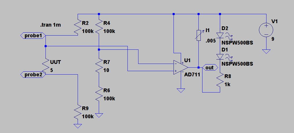

when i worked at a prototyping house, they needed to build continuity testers to verify wiring of the test fixtures they built. since there were often ICs and other semiconductors in the circuits of the fixtures, they wanted a tester that could be preset to something like 1 or 2 ohms as the threshold, had a max current of 0.5mA, and a probe voltage of less than 0.3V.
i kinda had to reverse engineer from memory 30+ years ago the circuit used used a TL072 op amp, with LEDs and a sonalert "mini" sounder (shown by I1)... it was something like this...
UUT is the wire being tested... the resistors, obviously for this kind of balance on a resistance bridge are 1% tolerance, and we had a 10 turn pot for the center part of the resistor string of R4, R7, and R6 to set the resistance the device triggered at... (just replace R7 with a 47 ohm 10-turn trimmer with the wiper connected to the noninverting input of the op amp)... this could be set to trigger at 2 ohms or less... and the sonalert would tell you if there was a loose connection because it would break up if you wiggled the wire and it was loose... the voltage across the probes is very low, and the current less than 50uA so it won't damage semiconductors

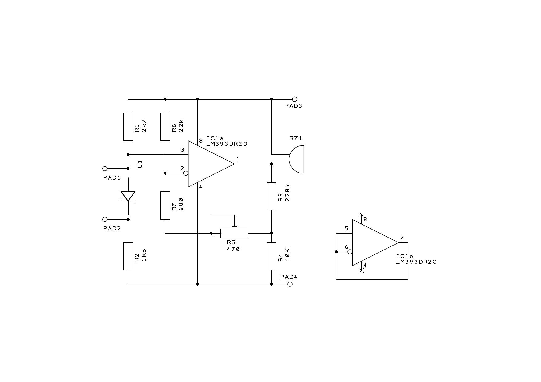

You lot have posted some ideas whilst I was wheel-reinventing! Here's what I came up with after ignoring everything (else) I found on the 'net...
I wanted a tester with some hysteresis to avoid "scratching" when it makes contact. The design here has about 100mV, which is probably too much but ya gotta start somewhere. The 470 ohm preset sets sensitivity from about 100 ohms to under 5 ohms.
It's going to be a 2 probes with a wire between type of affair, 1 probe holds the circuit. Not sure how I'm going to power it yet. Maybe some button cells.
Not a constant current source in sight....
Can't build anything until after house move, so just exists in my computer for now...
