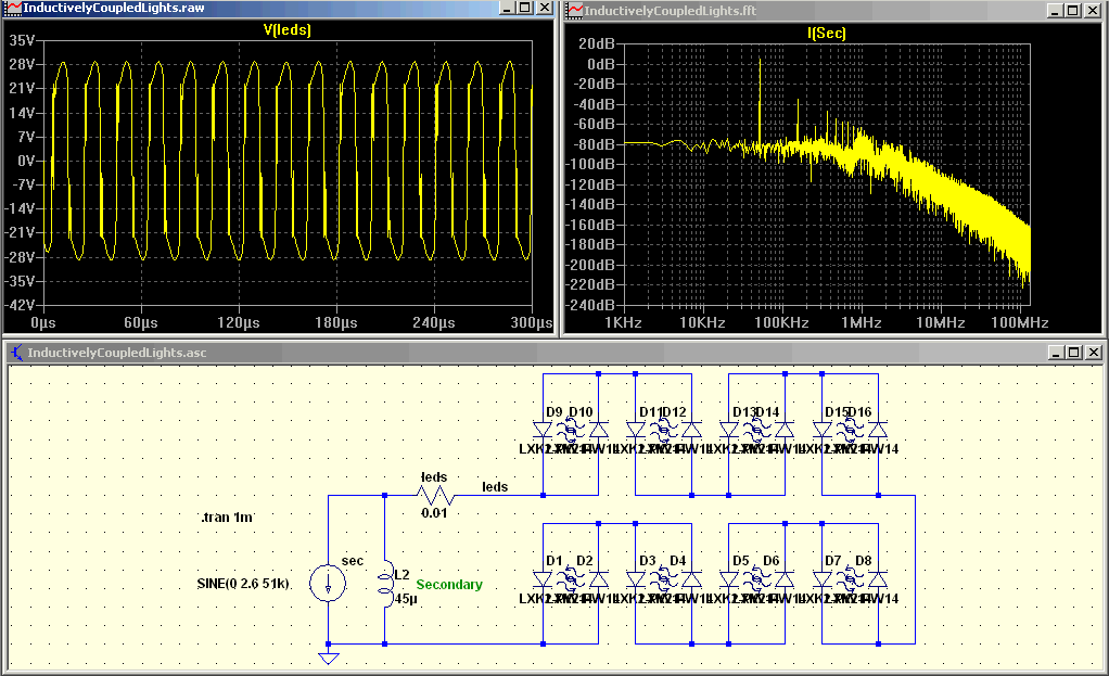

The LEDs will generate considerable harmonic content in the secondary current, which will be reflected in the primary (the twisted pair). How is this handled to prevent RF interference?
...the graph isnt like what you show, theres cctry there which means its pretty sinusoidal in the iBus....and in any case, think of a fluorescent strip tube, and the horrendous harmonics in that (large) current loop....nobody complains about florescents

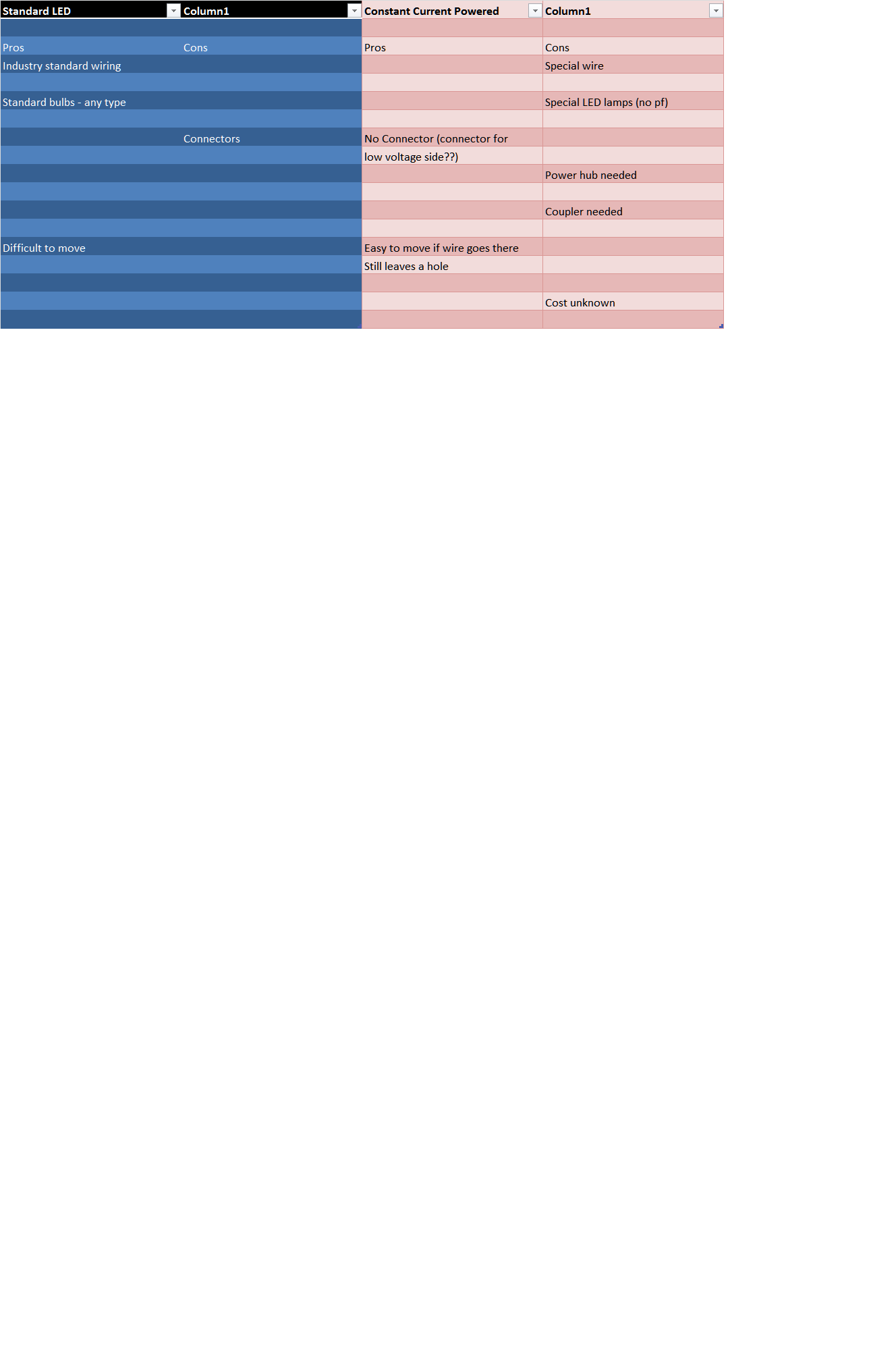

We should put some cost figures next to the pieces, but I bet we don't have any cost figures.
It looks like there is a connector from the coupler to the LED. Could that be?
