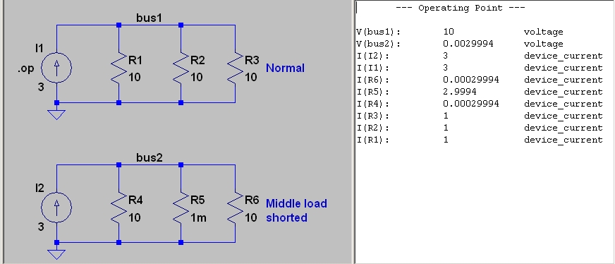

The isotera system is short circuit proof............its a current regulated bus.....that current regulated bus dosnt care if it puts current into a short, or into a lamp.
Please explain how a real current bus can do that. Here is what happens to a current-regulated bus if one of the loads shorts:
You mean that the "bus" is really a series string, like a Christmas Tree light set? I question the reliability of a series string, where an open failure of a single device takes out all the others...

sorry i have not explained well......its the isotera current bus i speak of......the power source is magnetically connected to the loads. not with wires as in your sown schem
