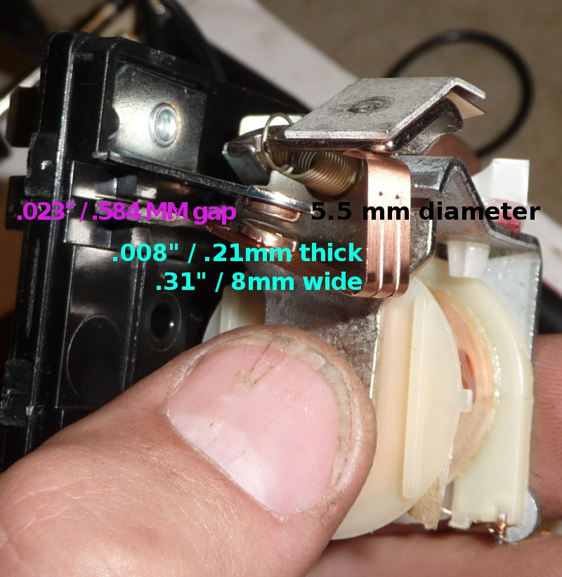

also, contactors for dc have to be expensive because everyone makes them so incredibly cheap otherwise.
here's a 35 amp 277vac contactor: 35amp_277.JPG
