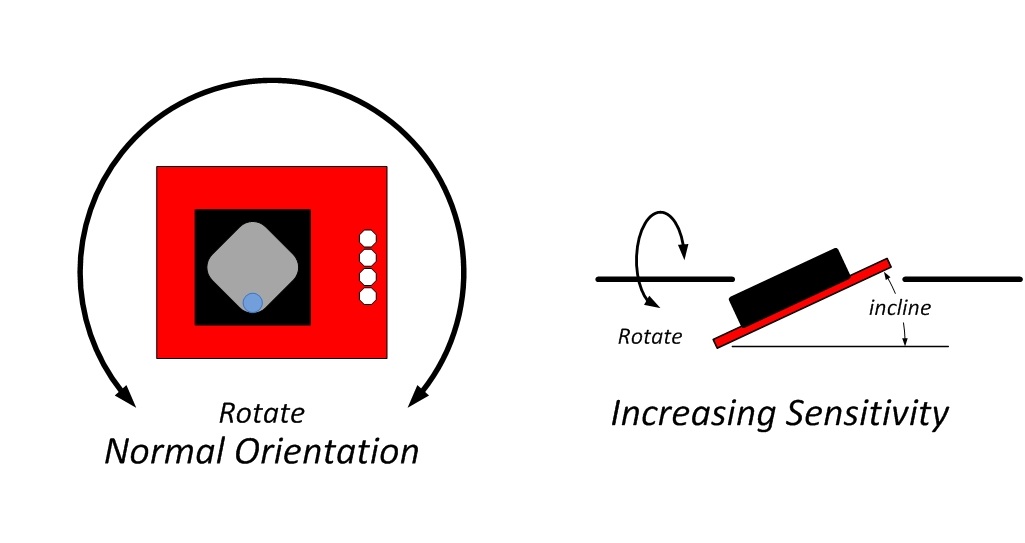

So apparently you didn't read post 20. The RPI-1031 is not so much a tilt sensor as an orientation sensor. Man, I should have learned not to waste my time explaining things to you. And of course, the time spent doing the drawing was a wasted effort as well.
Furthermore, you ignored the advice in post 20 to use the PICkit logic tool to easily test the sensor. You wouldn't want to inadvertently learn anything.

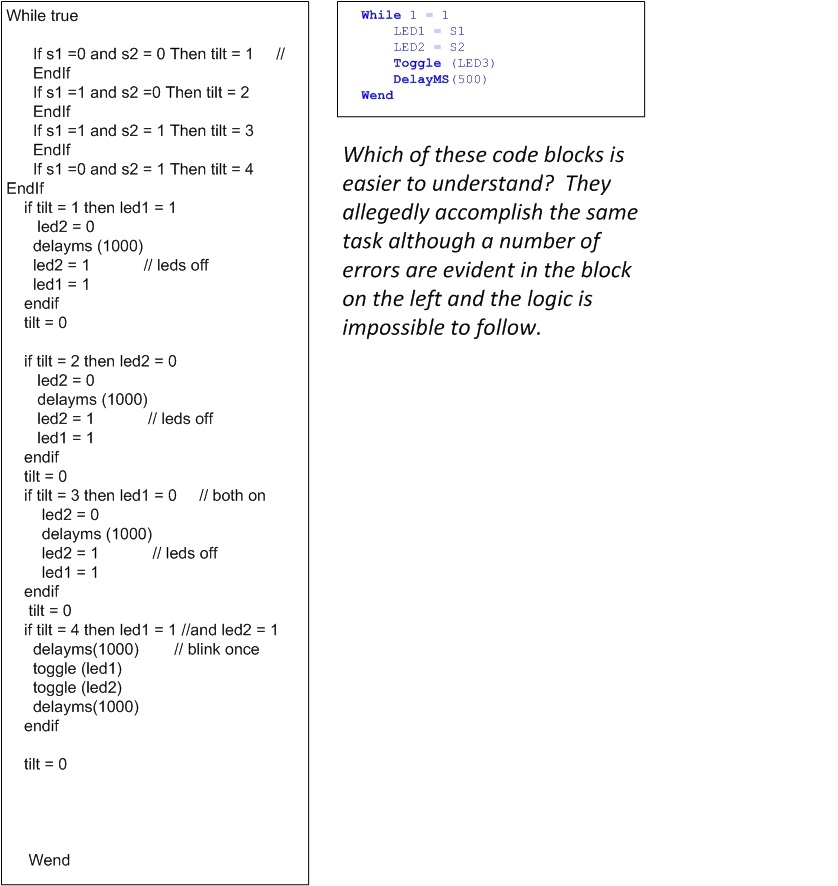

So here is the code you need to do what you are trying to do.
Device = 18f242
Clock = 20
Include ("utils.bas")
Dim S1 As PORTB.5
Dim S2 As PORTB.4
Dim LED1 As PORTA.5
Dim LED2 As PORTB.3
Dim LED3 As PORTC.0
Dim LED4 As PORTA.3
SetAllDigital
Output (LED1)
Output (LED2)
Output (LED3)
Output (LED4)
LED1 = 1
LED2 = 1
LED3 = 1
LED4 = 1
While 1 = 1
    LED1 = S1
    LED2 = S2
    Toggle (LED3)
    DelayMS(500)
Wend
Notice the order of defining the port pins, setting all the analog pins to digital, setting the LED pins to outputs and then defining the initial state of the LED pins.
The state of LED1 and LED2 equals the state of S1 and S2. Close a switch and the LED turns on. Open a switch and the LED turns off. Compare the simplicity of this to the EIGHT compound if/then statements you code uses to accomplish the same result. Also notice that my code is easy to understand; your code is not.
I'm also toggling LED3 each time through the loop with a half-second delay so that I can tell the code is running. This has the effect of making the switch condition display for half a second and not be responsive to changes during that time.

LOL we now no how to pass a high on a input to a output nice LOL. Jon is your head hurting from the left side.
True Burt. My head hurts....but it's caused MrDEB's complete and total confusion and inability to code!
And yes, my four lines of code are as simple as can be, but apparently beyond MrDEB's ability to follow simple logic. But those four lines were what MrDEB was attempting to do.
Also, if there are questions about whether and how the sensor works, lets not compound the problem with unfunctional software. Got to have something that works or it's a hopeless task.

No, no, no. I wasn't referring to your code; I was talking about MrDEB's code!
Unfortunately, MrDEB can't (or doesn't) think his way through the code. Line by line, what happens if the inputs are 0, 1? What happens if they are 1,1? It doesn't take long to spot several errors in his code if you mentally work your way through it.

MrDEB, did you get the point I tried to make....this sensor is not designed to measure tilt, it's designed to measure orientation of the board with the board being VERTICAL.

Somehow, you're not convincing me that you understand what they were designed ffor and the orientation they should be used in...if you don't understand that, you won't get good results.
