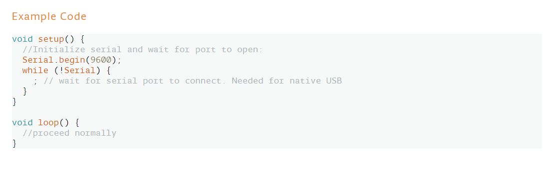

I just have one thing to say about this I looked at hardware serial for both uno and everything else I cant see why
while (! Serial); will not work the same on the Teensy
And I see the dtr
Read the DTR signal state. By default, DTR is low when no software has the serial device open, and it goes high when a program opens the port. Some programs override this behavior, but for normal software you can use DTR to know when a program is using the serial port.
The teensy has both dtr and rts but from what i see it still can
Use while (!Serial) ; // wait for serial port to connect. Needed for native USB
It has
Native USB
If you look at the files it adds it doesn't add Serial it's using the arduino Serial libraries it does add to them the dtr and the rts
And I see the dtr
It has
IT DOES WORK ON THE TEENSY that has been spelled out and it works on the Teensy because it forces a wait until DTR is asserted and that is done by opening the serial monitor. Until DTR is asserted, the Teensy will not use Serial - and you will not miss anything that has just come in at the beginning of execution. As I stated I prefer while (!Serial.dtr()) ; because it is more informative. Also remember, using that statement on a Teensy is their board code.
It has absolutely nothing to do with stabilizing, waiting, resting or any other such nonsense. As far as I can tell, the Teensy is ready to go and waiting for the DTR signal when it completes booting. If it need time, then you could simply insert a delay. But inserting a delay, no matter how long, will not work, because it needs the DTR signal, which occurs when you open the serial monitor.
On the UNO, as far as I can tell it does nothing at all and is not needed. In fact, when you see the statement "while (! Serial); " in Arduino code it often times has the comment // only needed for Leonardo.
Now, as an aside that is separate from the discussion, when you open the serial monitor on an UNO it does a kind of reset and you can see that in the board lights, but again, that is a complete different situation and it is on the UNO.
This is not a new situation. In addition to the previously included Teensy links, even the Arduino documentation, which does not apply to the Teensy except as the Teensy people strive to make it compatible, here spells it out - but you have to understand that the port is 'open' or 'ready' after a DTR. If you want to see the explanation elsewhere look here and probably a bunch of other places.
