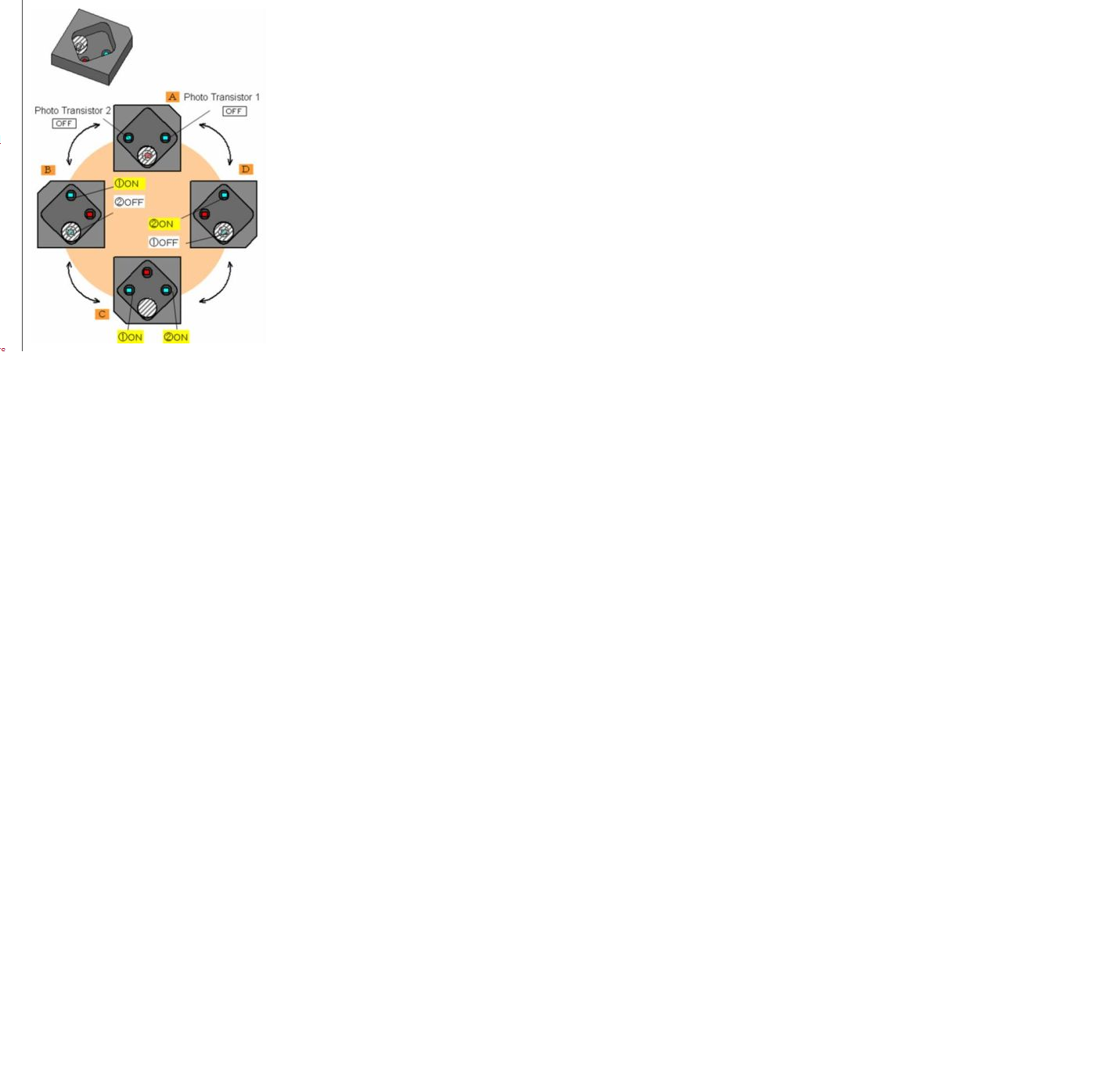

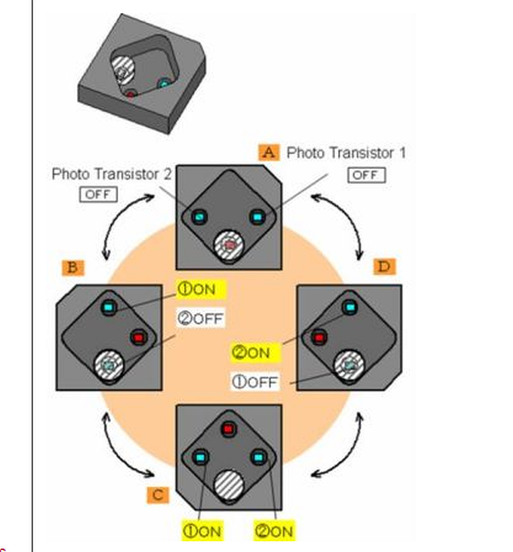

here is a diagram of internal workings. My posted code seems to detect tilt but won;t do it continusily. It reads, enables lED and stops. I reset pic and it read new tilt direction.

The RPI-1031 should be the easiest dang sensor in the world to use. If you look at the picture of the internal workings you posted, the cavity with the ball is a square. A unique output is generated when the ball is in each corner. This should be perfectly clear from the picture.
What you have most likely failed to understand on the hardware side is that the view you posted shows the sensor (and circuit board) in the vertical position. Hold the board vertically and rotate it about its center. When you've rotated just past 45 degrees....ker-lunk...the ball rolls to the next corner where it will stay for the next 90 degrees of rotation. It's designed to indicate which end is up on a cell phone or camera, and there are exactly four possibilities.
It should be a ten minute exercise to verify this using your PICkit 2 logic I/O Tool or a DVM. Follow the Sparkfun schematic connections for power, ground and the two output lines. Yes, power and ground must be connected no matter how inconvenient you find it.
So, a tilt of >45 degrees is needed to change states. If you get your ear to touch your shoulder, this should work. Perhaps not the best design choice, ya think? All may not be lost though. If you incline the board from vertical (incline the plane of the board), a smaller amount of tilt will be needed to move the ball from the rest position to either of the other possible corners. In fact, I would incline the board to maybe 15 - 20 degrees from horizontal so that a small tilt will cause the ball to move to the other corner while still biasing it to return to the rest position when not tilted.
So I think a basic lack of understanding explains the sensor problems. But what explains the software problems? This is like basic, trivial stuff. Fundamental stuff learned on page 2 of any guide.
