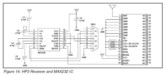

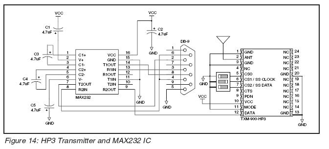

I want make a Circuit for wireless communication between Two computers.
It may in Serial , USB port ,a LAN or MODEM?
HELP me plz....
the information you provided is less then required but have a look at the links below. I have done wireless communication between two systems using serial port..
The main requirement is that to communicate between two computers for a distance of about 3killo meter i,e (from Khanna pul to Sadqa abad).

That is a hell lot of distance. Either reduce the distance or believe me you are in TROUBLE!

So what can I did. . . .If the rf ICs are not avaiable in Pakistan,
It is very costly to bring it from abroad.
What is your opinion. . . ..
Is I build a transceiver to using a
MAX232(Lavel converter),,
MT8880,CMT8880C-1(Integrated DTMF Transceiver),,
and MC1496(Balanced Modulators/Demodulators),,
OR using micro controller like 89c51, 89S51 e.t.c. . . . . .
If yes so please help me.....

I have just been looking at a few new ICs from TI, the CC1110 & CC1111.
Both are complete radio transceivers with an 8051 on board and will do data speeds of up to 500Kbit. They are only low powered +10dbm but can take a power amplifier. Sorry if it sounds like an advert but they do look interesting.

In my opinion go for the microcontroller...
