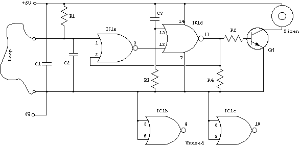

i am making a home security system for the complete society (comprises of 300 flats). so in that system there will be some wires which will be running through the society .so i want an alarm which will turn on if someone tries to cut the wires.
what i have in my mind is that run a sepreate wire along with those wires.
so if someone will cut the wires the wire will also break and the alarm turns on.
so i think i need a wire loop break alarm.
i get some circuits from the net but they have there own llimitations that u cannot increase the length of the wire ..but in my case the legth of the wire would be atleast 500 mtrs
if anyone have a better idea or circuit.i would like to go for that one.
any suggestions

It depends upon the total resistance of the wire loop?
Which in turn depends upon the wire length, you say 500mtrs, also important is the CSA [cross sectional area] of the wire conductor.
Simply, the heavier the wire gauge the lower the resistance/metre.
Also consider the effect of a local 'electrical storm' upon the loop being connected directly into semiconductor inputs.
The induced em pulses would destroy the ic's also you could get false alarms.
Wire loops in security systems are in common use, care must be taken in the routing and termination of the loop.
Does this help?

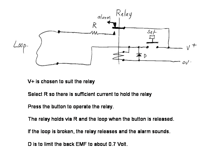

Also note that a relay will hold with a lower current through its coil than is required to operate it. So you could have a "set" button to operate the relay and let it hold via the loop and a resistor. The resistor value would be selected so that the current is greater than the hold current. Thus you can reduce the energy consumption.

This is what I mean.
You can use virtually any relay. Choose the supply voltage V to suit the relay.
Virtually any diode will be suitable, eg. 1N4148, 1N4004, etc.

The only improvement I would make would be to buy a DPDT momentary toggle switch rather than a push button as drawn in my circuit. Then you can prevent the siren sounding when the circuit is set, ie. while the button is pressed.
Sorry, I wrote this post in a hurry and confused myself.
What I should have written is this:-
The siren will sound when the power is turned on until the button is pressed.
You can avoid this by pressing the button before turning the power on so that the relay operates immediately.
