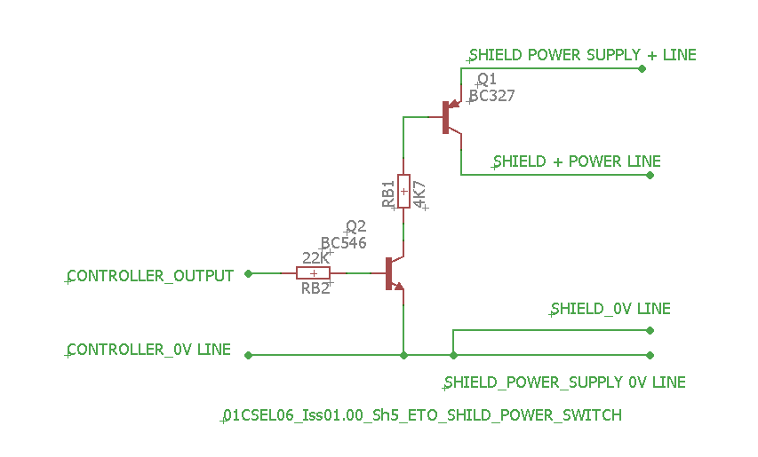

This is the best bet for switching shield power lines from a controller. It provides isolation between the controller positive supply line and the shield supply positive line so that the shield positive line can be any voltage you like within reason. Of course, the circuit can be scaled for higher voltages/currents if required. The circuit also gives a very low voltage drop between the shield power supply + line and the shield + supply line.

I made this exact circuit. It doesn’t work. The current to HC12 max out at 15.5mA..if I were to power the hc12 directly from my minipro VCC’s pin, it will work and I can see the current spike >20mA during transmission.. it’s like the pnp transistor don’t have enough current to power the hc12..what do u think?
