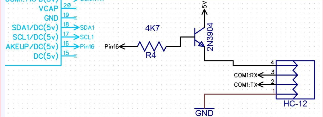

Will this circuit work
Did you not like post #35 .has my vote :woot:
Isn't post 35 what I replicated in post 37?

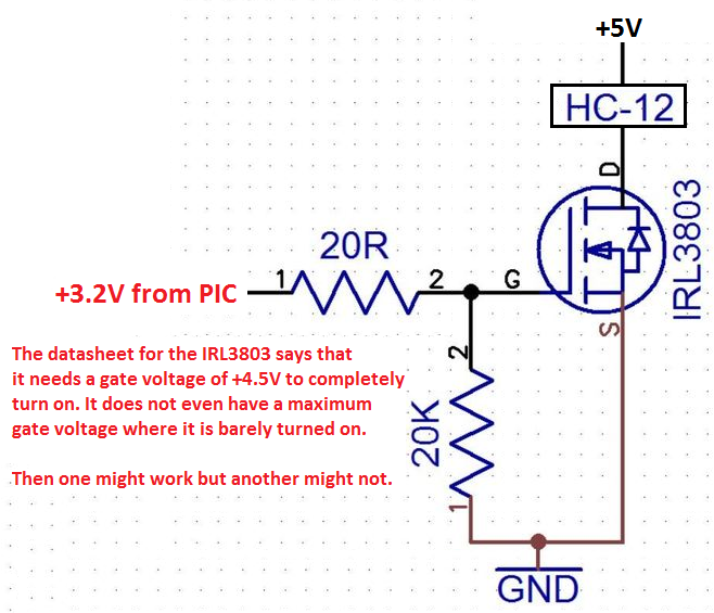

OR do I NEED the 100 ohm resistor across the HC-12? if I do then that defeats the purpose of the transistor as a switch
I need it to ONLY use current when turned on (ie when I need the HC-12 in circuit working) the rest of the time there must be no current drawn from the circuit - well that section of it anyway
Who says the IRL3803 Mosfet will turn on enough with a gate voltage of only +3.2V? It is spec'd with a gate voltage of +4.5V and does not even have a maximum threshold voltage listed like most Mosfets have. You cannot believe the graphs because they show a "typical" one that you cannot buy.

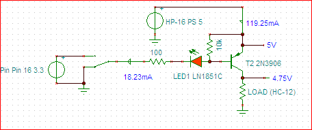

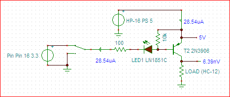

Lew you missed that it is a pnp transistor #35 your #37 npn
Mike's circuit will require PIC pin 16 low to switch 5v to HC12 led will be on ...

Can anyone explain exactly how the circuit works please?
I need to make sure that its not draining the battery when not needed
ie if the led is on all the time it's no use it would drain the battery
Am I right in thinking with the pin high it's turned off, the led is off, the transistor is off
With the pic pin low the diode lights, the transistor conducts and the HC-12 gets power?

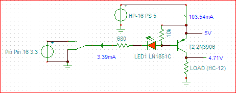

Lew It seem to take a time for ETO in USA to catch up , your last #44 looks ok , should work as required , Mike's post 35, explains with I presume a simulation , pin 16 at 3.3v ( or 3 state , input ) holds off led and pnp base , at ~2v at pin 16 , current flows in base , led glows transistor turns on , 5v available for HC12, bytes move !
Edit Led needs to have a 2v forward voltage ( red )

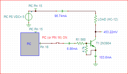

Going back to your original idea, but putting the load in the collector leg and assuming that the HC-16 is pulling less that 100mA:
and assuming that the 5V on Pin 16 is the same 5VDC Vdd as from the PIC PS,
a sim of, essentially, your first circuit:

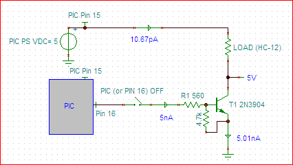

No sig to NPN:
Sig to NPN:
Note the 4.7k resistor: with a loss of Sig from PIN 16, this will pull the NPN base to GND, shutting it OFF .
I may have PINs 15 and 16 reversed as to function. But, as you can see, the circuit functions just fine as a switch, with minimal current draw (≈5nA), when quiescent.
Lew , I think the (MikeM) circuit on #44 is 'elegant' it has the led indicator, and is on the high side , so the TX from the HC12 cannot try to power the PIC RX pin, even during PIC reset power up (all ports are inputs) the HC12 5v will not be active. bread board it see how it is in real life...
granddad is right.
And yes, the PIC pin 16 has to go LOW for the circuit to work.
granddad is right.
Cowboy lowered the resistor between the LED cathode and the pic port from 680Ω to 100Ω. I specifically selected that resistor to provide sufficient base current to saturate the PNP. Lowering it just wastes power without much benefit.
