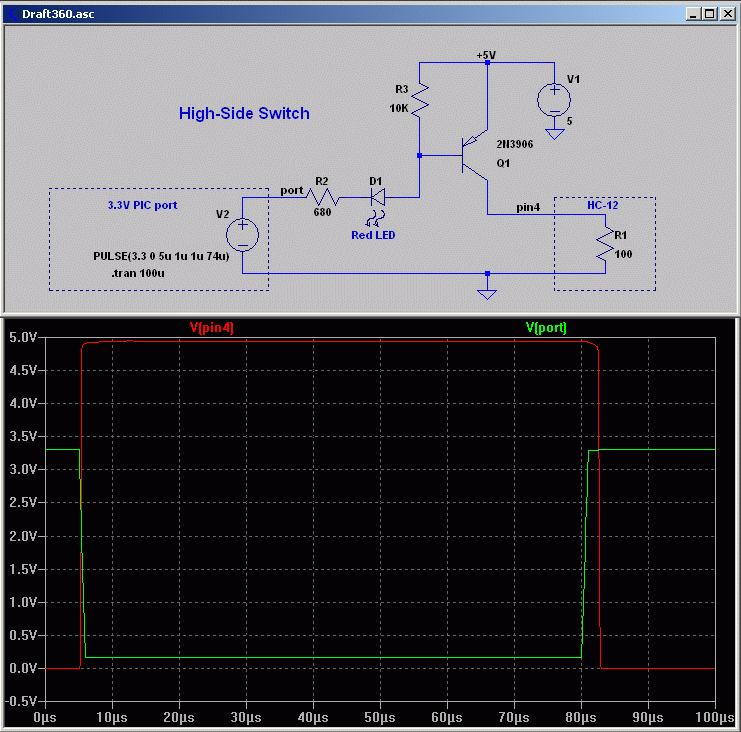

Still leaves the problem that the PIC port TX and RX pins will always be sinking current, even if they are tri-stated off!
Here is another way to do it: The Vf of the Red LED is used as a 2V level shifter. Note that the logic levels at pin 16 of the PIC must be inverted.

That's fine if you're sinking current, but sourcing (with different supply voltages) requires two transistors. (or an LED like Mike has posted - or various other means as well).
From a personal point of view, I'd prefer to switch the positive :D

Hopefully this will work?
but Why the LED? is it on or off when the switch is off?
The only thing I don't understand is does the pic pin go high or low to make the HC-12 work? (get power) I'm assuming low???
That's no good then,
The idea of the switch is to conserve battery consumption not increase it
Although if the pin was high on power on (or told to go high) wouldn't that stop the led working and have no current draw?
Then if the pic pin went low, the transistor would conduct?
