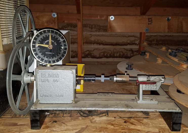

I used to hand wind bobbins for a living lol They were on ferrite C cores though, there were the occational ones which just had a ferrite rod going through them too.
(I say hand wind, we used a mandrel which had a gear ratio of about 1:3, but with a 2500 turn coil, that is still a lot of turns of the handle)
