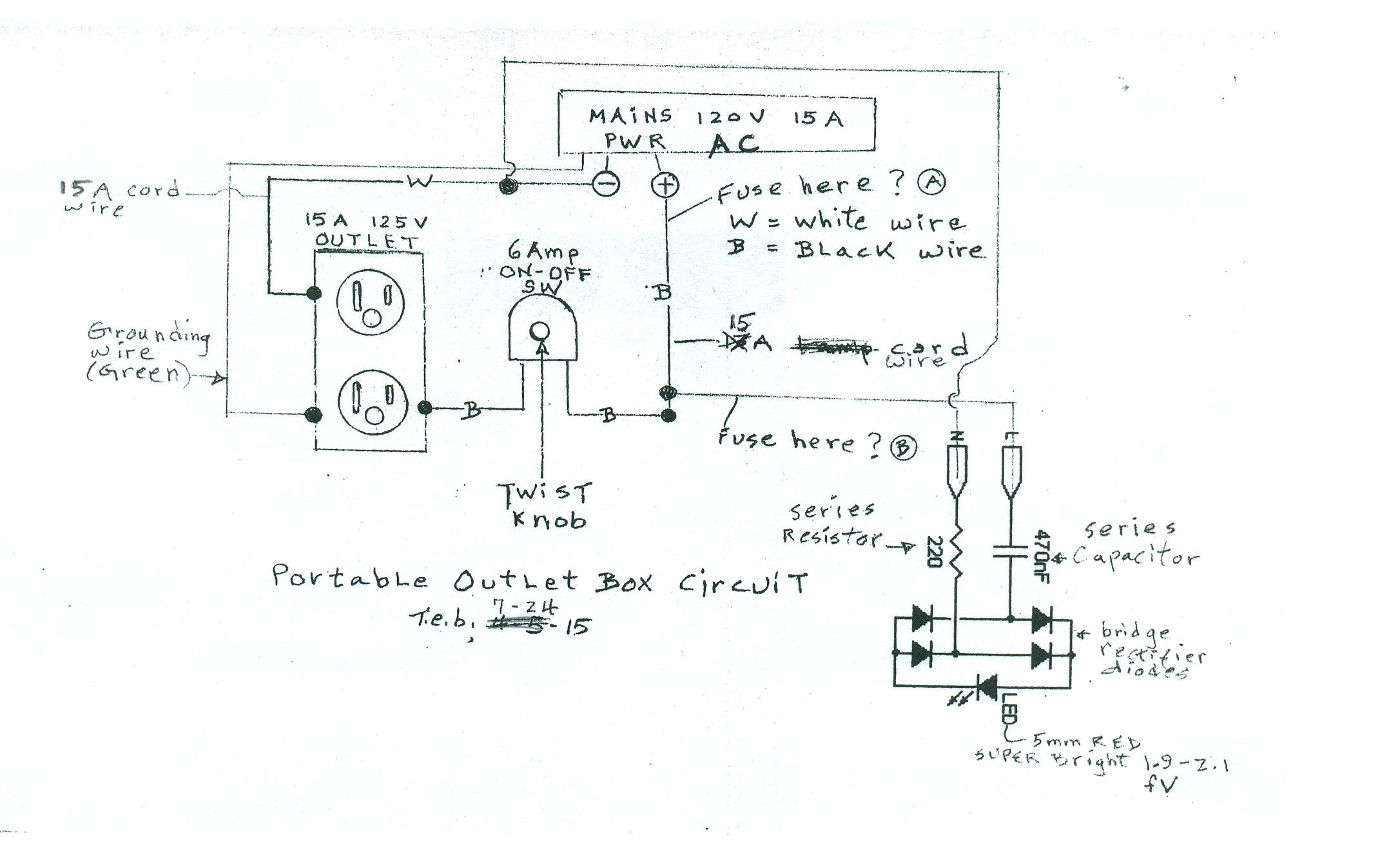

This post was edited by ToddB74 on 7-29-2015 and again on 8-05-2015, to up-date specifications and attach my latest circuit drawing.

Note, on the attached up-dated circuit drawing I have indicated two possible places for the fuse, i.e. letters A and B within circles. I'm leaning toward B, but thinking it probably makes little difference. What would your choice be ? Misterbenn replied fuse location B.
Another thing I would appreciate is your critique of the above specifications and the attached drawing and letting me know if you see any problems.

I'd just use a neon indicator lamp, these are able to work straight off mains voltage. google it and see if it will fit your purpose
There are Electrical Code requirements mandated for hard wiring AC that you ought to be aware of . Using a bridge & series R to drop 240Vdc to 1.6V means power lost in the resistor sharing the same current will be P_res.=150x P_led because of 240/1.6. At half power or 30mW, the resistor would consume, 4500 mW. Bad idea.
But using two LEDs in parallel but reversed, you can choose a series 500V rated film capacitor X1 type, that draws 10mA across 230V at 50Hz. Zc(50Hz)=23kOhm=1/(2pi*50*C)
Can you compute C?

+1 on the Neon, also the mains input is never referred to as + & -, it is AC.

Thanks for mentoring me on the proper term for mains input. The + and - on my circuit drawing was meant to indicate the circuit polarity, rather than the mains ; regardless, I stand corrected. :sorry:
Can you compute C?

Because of the hazards involved with shock and fire, and the specialized parts required, this is not a project for a newbie.
I'm an electronics newbie and while I really appreciate your comments and suggestions, they are "over-my-head" at this point.
Its exactly because you are a newbie that everyone is suggesting neon lamps.
Don't get me wrong I encourage learning, but this is a potentially dangerous project to start off on. Unless you use a isolation transformer (and i suspect you wont due to complexity and size) you are talking about a mains connected circuit without a proper understanding of electrical safety and component failure modes. You could hurt yourself on this endeavor, but to be honest that's not what I'm concerned about. If you hurt yourself well that's your own fault but the set up you suggest could be used by a layman (general person) and hurt them and that's far more concerning.
If you want to learn I suggest getting a 230V to 12 or 24Vac step down transformer and fast blow low current <<1A ouput fuse. This will let you create practice circuits and develop understanding while not endangering yourself or anyone else.
If you want a quick solution which is quick and for the most part safe (not completely because the neon could have exposed wires if your enclosure isn't very good or not grounded correctly), then just buy a neon.
Again i just want to say i encourage learning and if you're proceeding safely I'm sure we'll all be happy to help guide you. But main's voltage is not something a "electronics newbie" should be playing with and its certainly not suitable for just lifting a circuit off a forum without deep understanding of what you are doing.

I appreciate the concern for safety expressed in your post #13 and fully agree.
Unfortunately, I allowed myself to get in too much of a hurry when designing /making the Portable Outlet Box and knew better at the time, but went ahead and used a 2-wire lamp cord with no ground wire. That was a mistake and probably what "spooked" you and others when viewing my circuit sketch......and justifiably so. Then when I admitted to being a newbie in a subsequent post, that was the "clincher" ! However, let me explain. While I am a newbie to electronics, I am no stranger to the basic fundamentals and safety requirements when working with electricity. I hope the following will help to raise your confidence in my knowledge when working with electricity.
As for the circuit sketch attached to my starter post, I am going to re-design that circuit to use a different power cord that includes an earth (green colored) ground wire for attachment to the duplex outlet metal frame (normally not current-carrying unless there is a fault) and plug with ground tang. Also, since I'm using a plastic receptacle box and cover plate, even if a short happens inside the box no current can reach a human hand or other material touching the box, anymore than would a store-bought outlet bar with plastic enclosure.

ToddB74,
I can understand the concerns about you safety by people replying to your post. In your first post you label an AC supply with + and -. You have no earth connections and you use an internet calculator for a simple thing like calculating the value of the series resistor for an LED. When someone mentions the use of + and - you say it is to indicate polarity. The polarity of an AC supply reverses every 8.3 mS (Assuming a 60 HZ supply.)

Thanks ToddB74, Its always helpful to have an understanding of a persons background and experience. I always start off by assuming the OP is a school student.
Tony has given you the start of an answer here.
This link should help http://www.marcspages.co.uk/tech/6103.htm

I copied and printed the bridge rectifier circuit drawing and all relative text, including the NOTES at the bottom of Marc's document. After digesting this and making final decisions on the exact components I want to use, I'll accumulate these components and temporarily install them on a breadboard for testing before building the final pcb and incorporating it with my Portable Outlet Box circuit.

Just a note on your test setup. Breadboard is not designed for hv and i suspect will have corona if not actual arcing.
I suggest using veroboard for the proto with some copper tracks scrapped off.
Also make sure to use a fuse, but I'm sure you know that.
