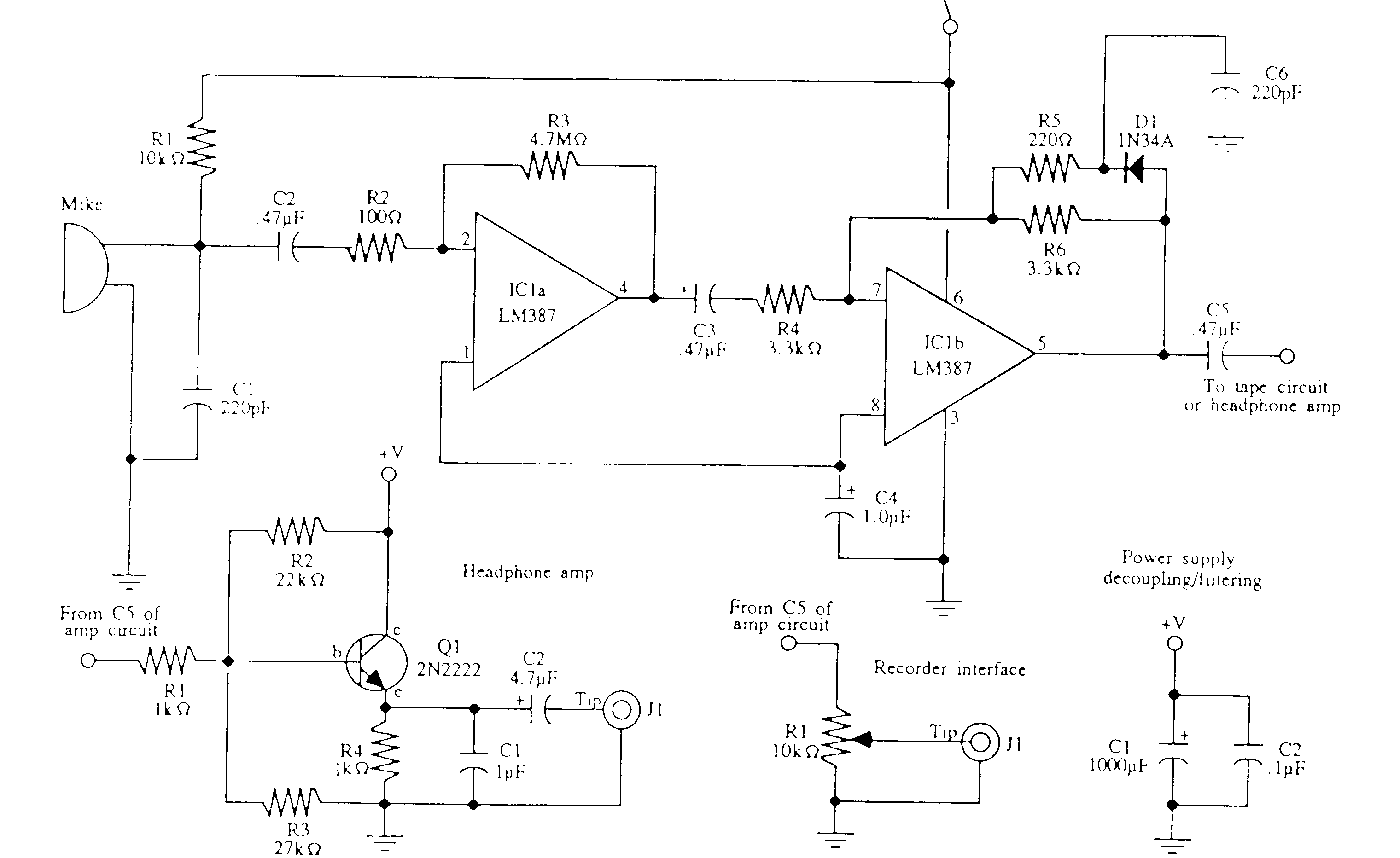

Just want to get someone's input, is this a good parabolic mic amplifier? I like it because i already have all the components to make it :lol:

Yes it should be OK, But as I said before, A Bandpass Filter is a Really good idea. And on that Preamp I would connect it between the two stages of the IC.

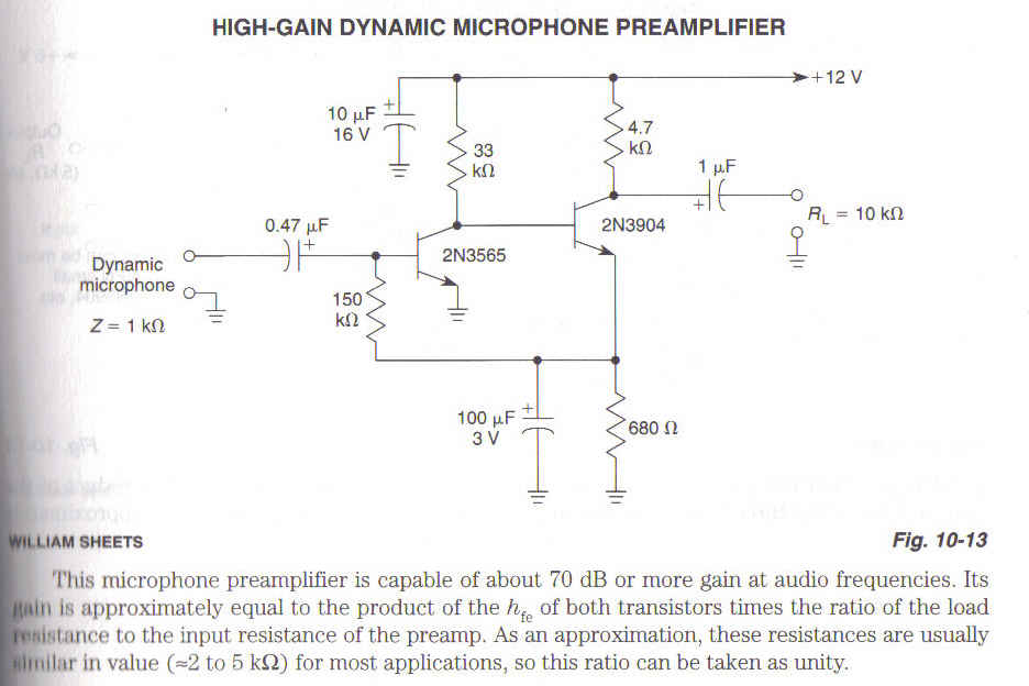

I have built that amplifier in the schematic above.It is sensitive, but it also has alot of noise in it.I thought the LM387 would be a good one to use.After the noise,I used an NTE replacement just to see if it was the original IC or what.After replacing it with the NTE cross-reference,it had the same noise level as before.I did a search on this site(which is great by the way)and found this circuit.It looks pretty simple and might do the trick.I like ICs,don't get me wrong.But I also like a simple approach as well.Any inputs on this circuit.I have got some 2N3904s around and I know the hfe on each is 242 to 245.Any way to calculate the gain knowing the hfe's of the transistors?

Both the LM387 and the two-transistor circuits have a gain of about 3,200 but the transistor circuit would load-down an electret mic less, and therefore be more sensitive. That is a very high gain, maybe the noise is from the Jfet inside the electret mic. :)
I did'nt think of trying a different microphone other than an electret.Dang,wish I had kept the circuit now.Live and learn I guess.I looked at chemelc's website.I LIKE THAT ONE.I noticed he had a plan to use a speaker as a microphone.The thought of more area coverage is appealing but I might have to sacrfice sensitivity.If I used the speaker-as-microphone circuit instead of a electret mike and given the speaker was an 8 ohm load,would the circuit,once built,have an output of 8 ohms or would the load be higher like that of an electret microphone?I was reading the text under the schematic I attached.The gain is determined by the sum of the 2 transistors' hfe,which are 242 each(hfe1+hfe2=484)times the ratio between the input and output load.The output being 10k.So would'nt a lower load(the 8 ohm for example)make the gain higher since there is a greater ratio between the input and output?Man,this is fun!!!!

I was reading the text under the schematic I attached. The gain is determined by the sum of the 2 transistors' hfe, which are 242 each(hfe1+hfe2=484) times the ratio between the input and output load.
The text says the gain is the product not the sum of the transistors' hfe but I don't believe it since the transistors each have an hfe of about 220 and thefore the calculation is 48,400 which is impossible. The low input impedance of the 2nd transistor loads-down and decreases the gain of the 1st transistor. I think the circuit's gain will be only the sum of the transistors' hfe as you say, about 440.
No. I don't think the circuit's gain has anything to do with the ratio.
The circuit's input impedance is 3k to 5k and is not the same as the mic impedance, except a very high impedance mic would be loaded down by the circuit's 3k to 5k. A very low impedance mic wouldn't be loaded down and would provide its full output. A 3k to 5k mic like an electret would have its output cut in half.
The gain of the 2nd transistor is max with no external load and is cut in half with a 4.7K load. A 510 ohm load would cut the gain to 1/10th.
Bootstrapping a transistor and an emitter-follower for its load can provide a very high gain. But it's late here now and it is another story.
