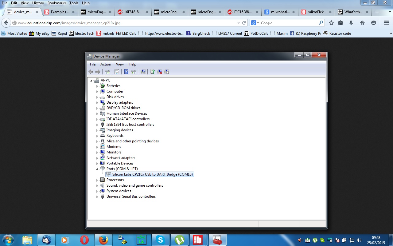

Hi Scott, here is the pic of my devman. That is with the CP2102 plugged in and light on and connected to my analyzer.
Al

Looks fine to me! Com10 it is, sadly, I have so many USB-serial bridges... FTDI, siliconlabs, AVR, my own homerolled ones.. that my poor PC is on.. Com23 now...
Good call on the options in windows for power control. On laptops especially to save draining the battery, they often default to 'low power', which means windows turns off power to USB unless you tell it not to. Annoying at best.

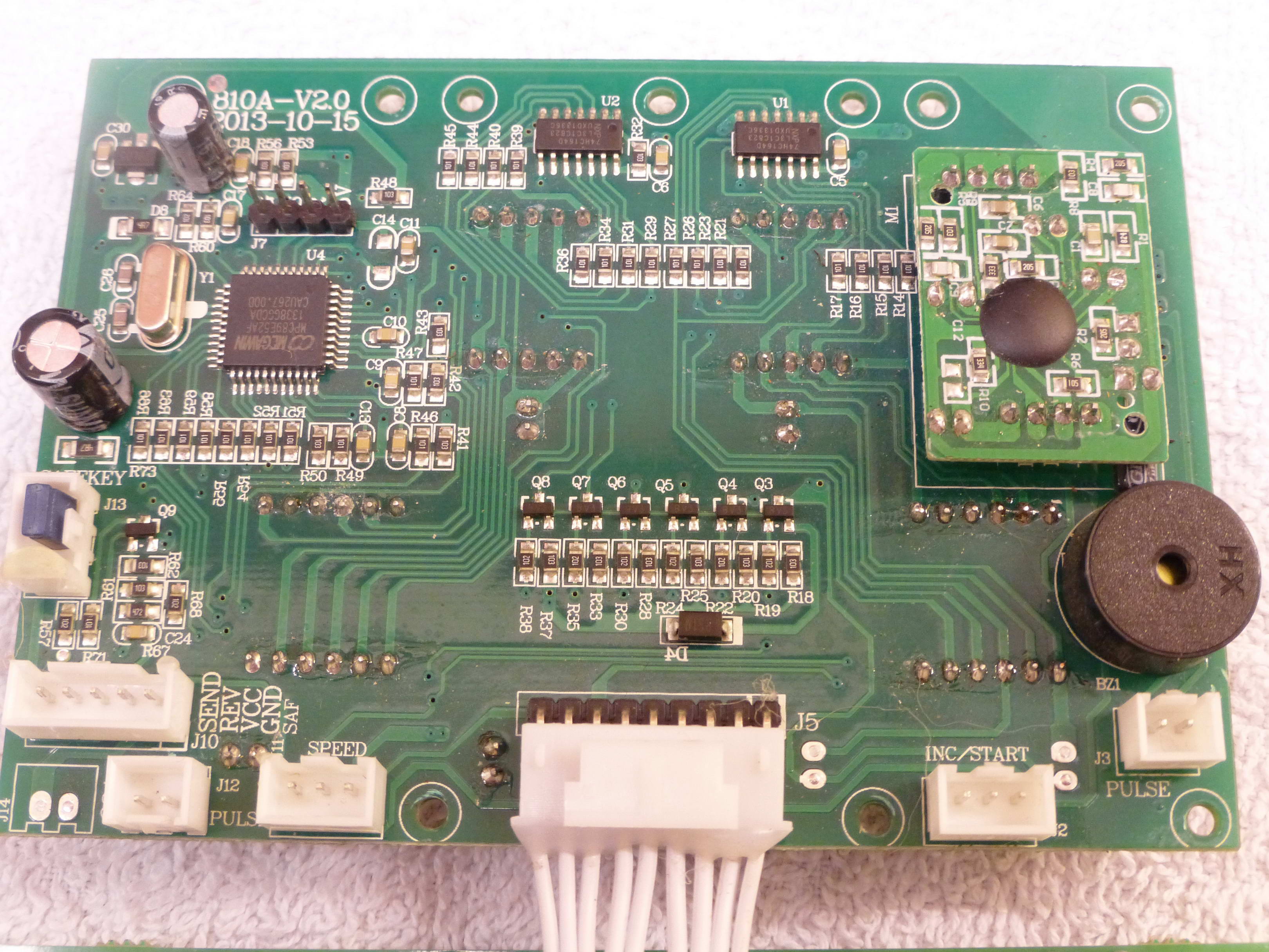

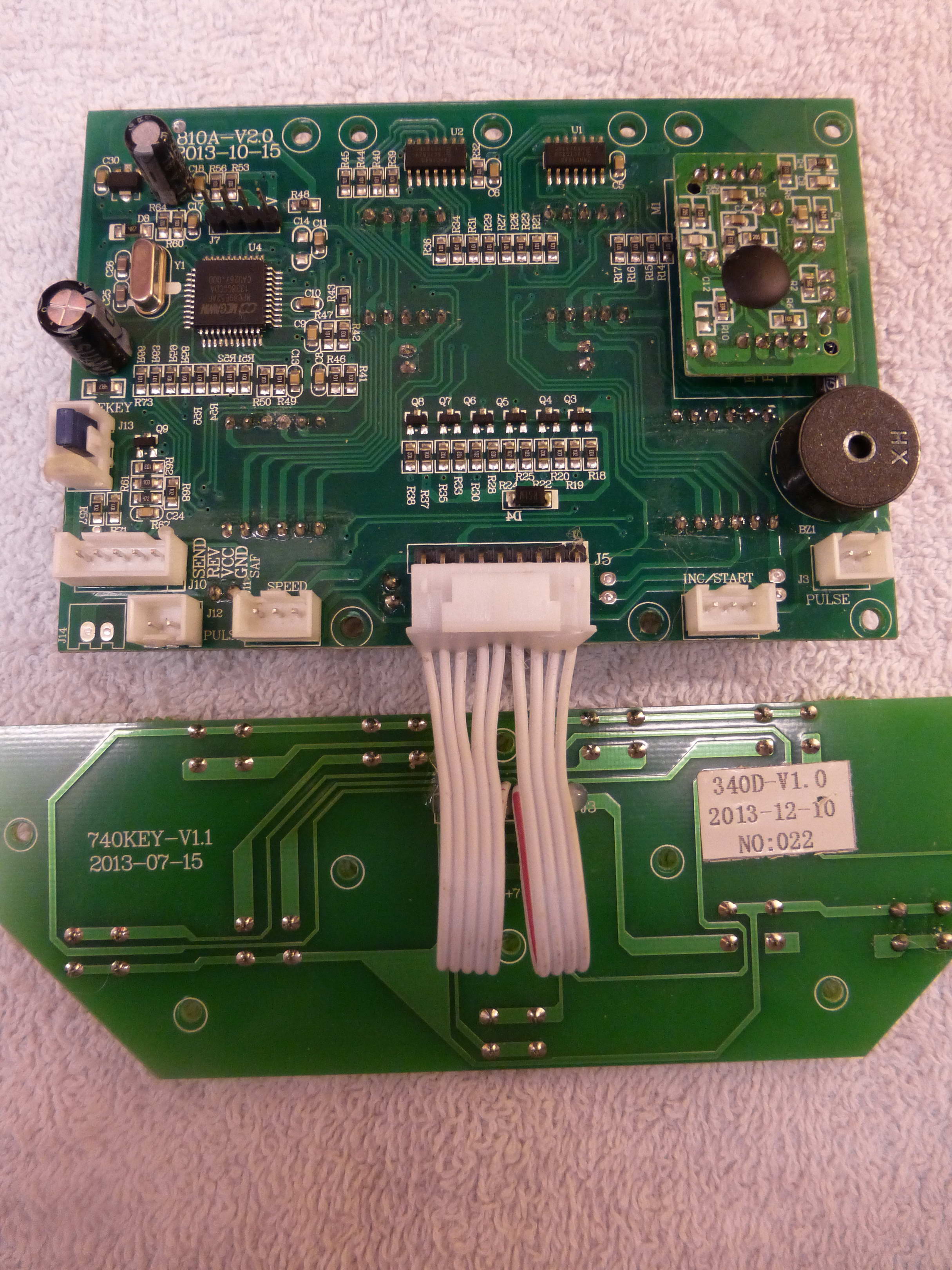

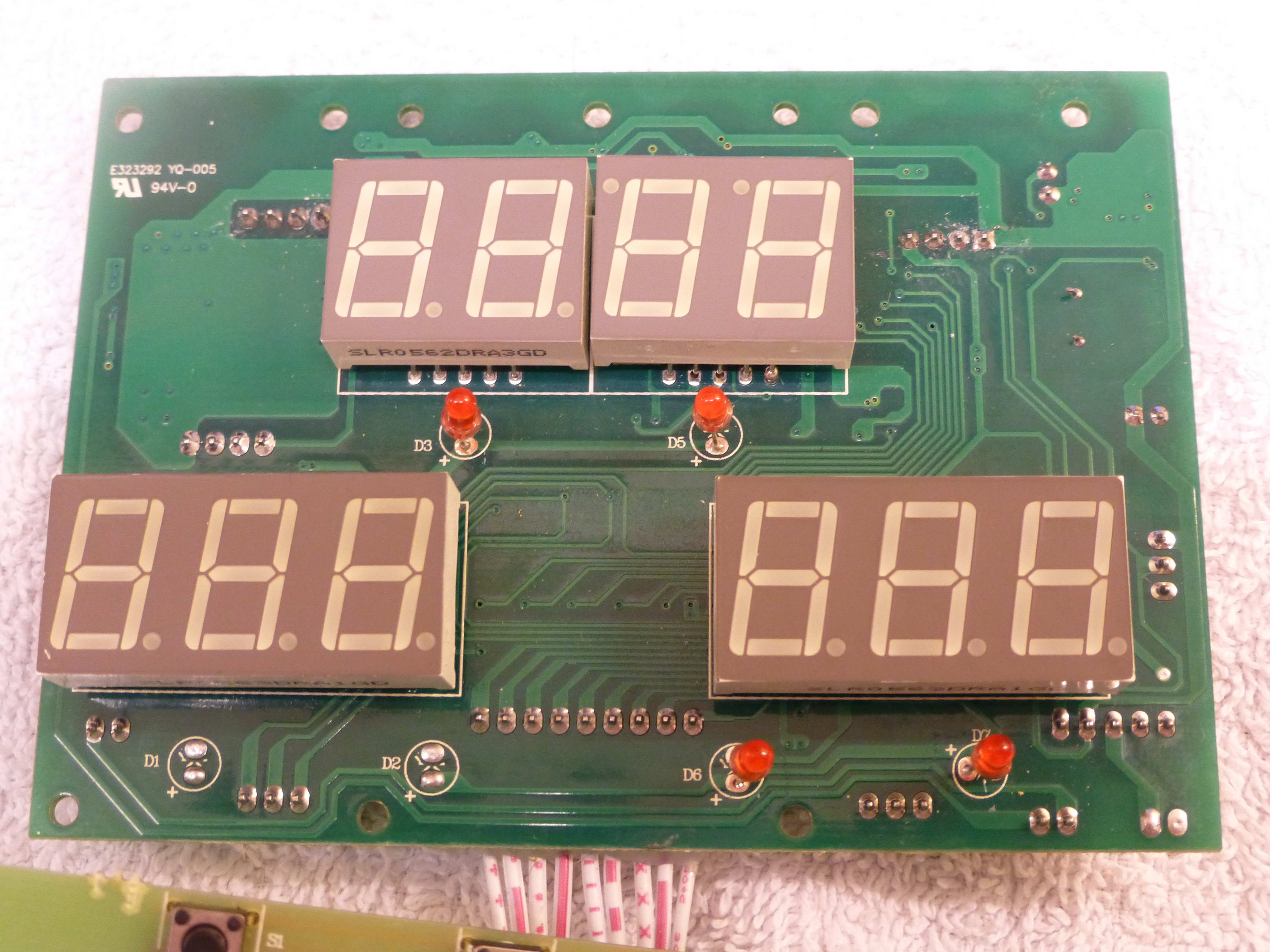

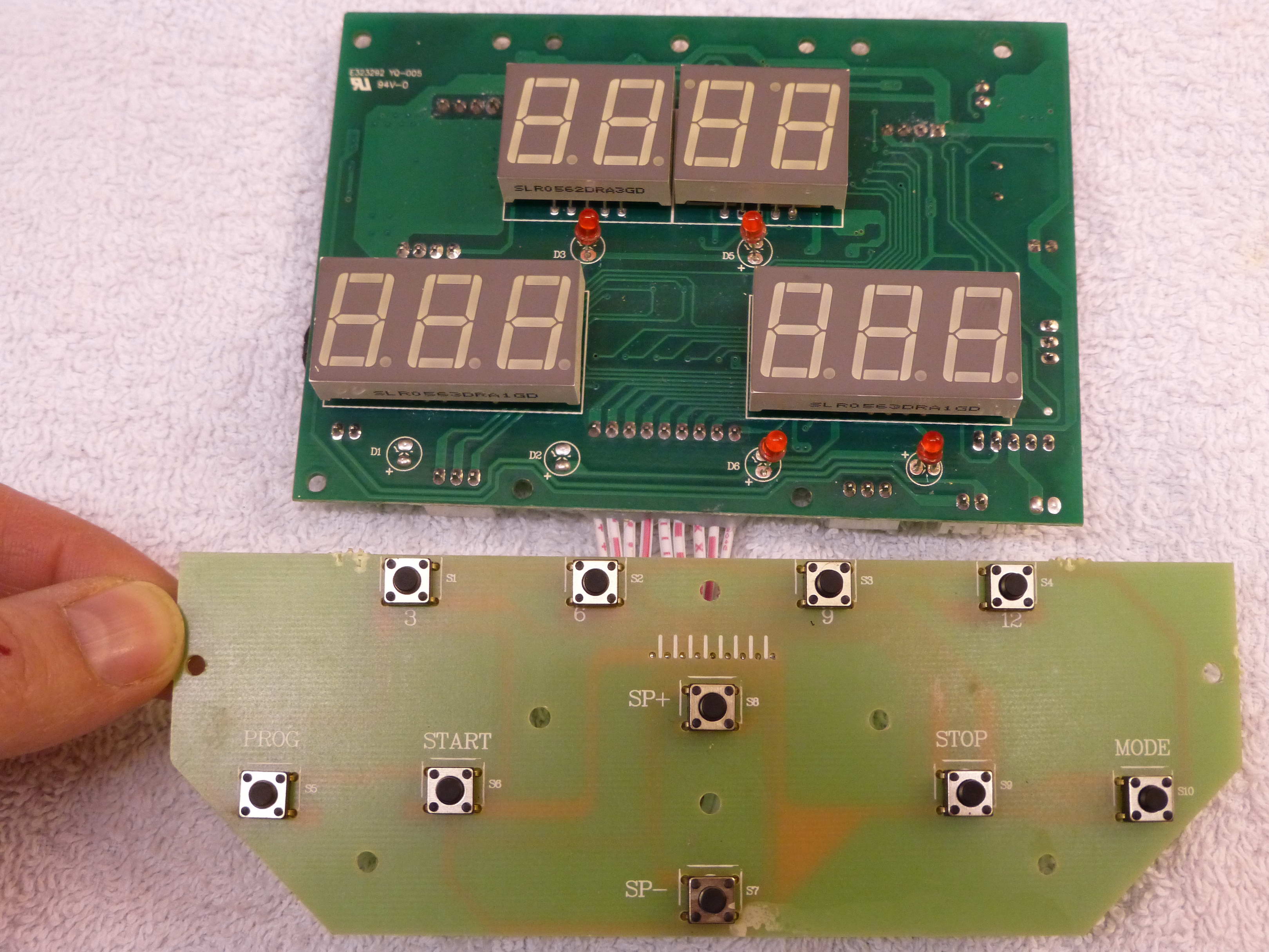

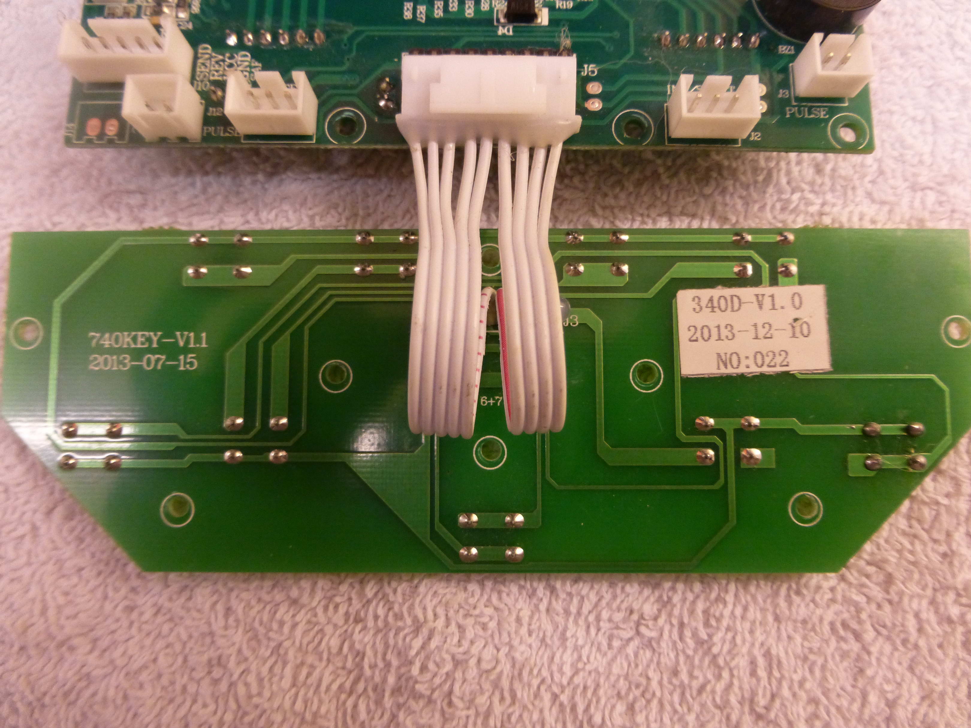

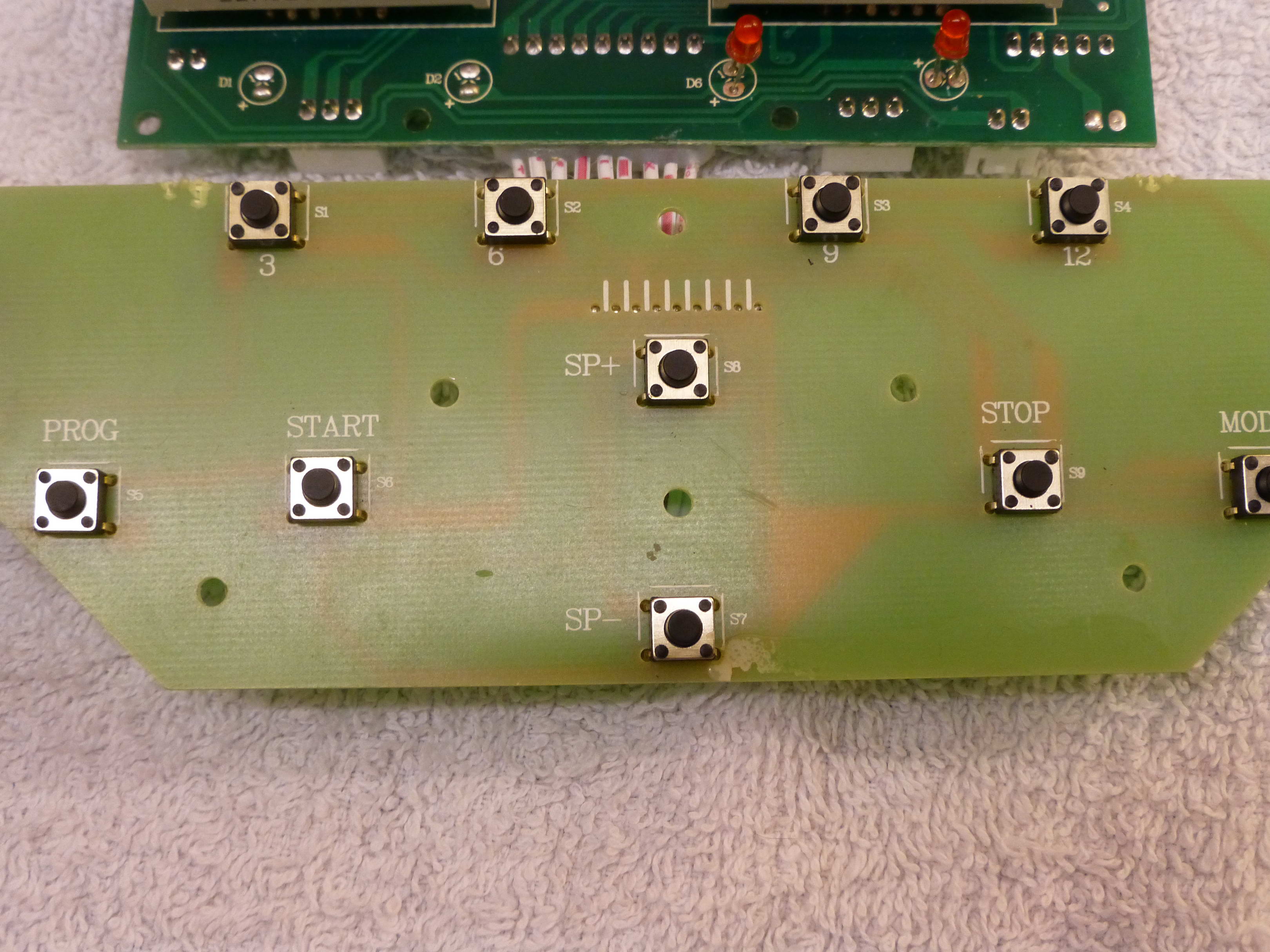

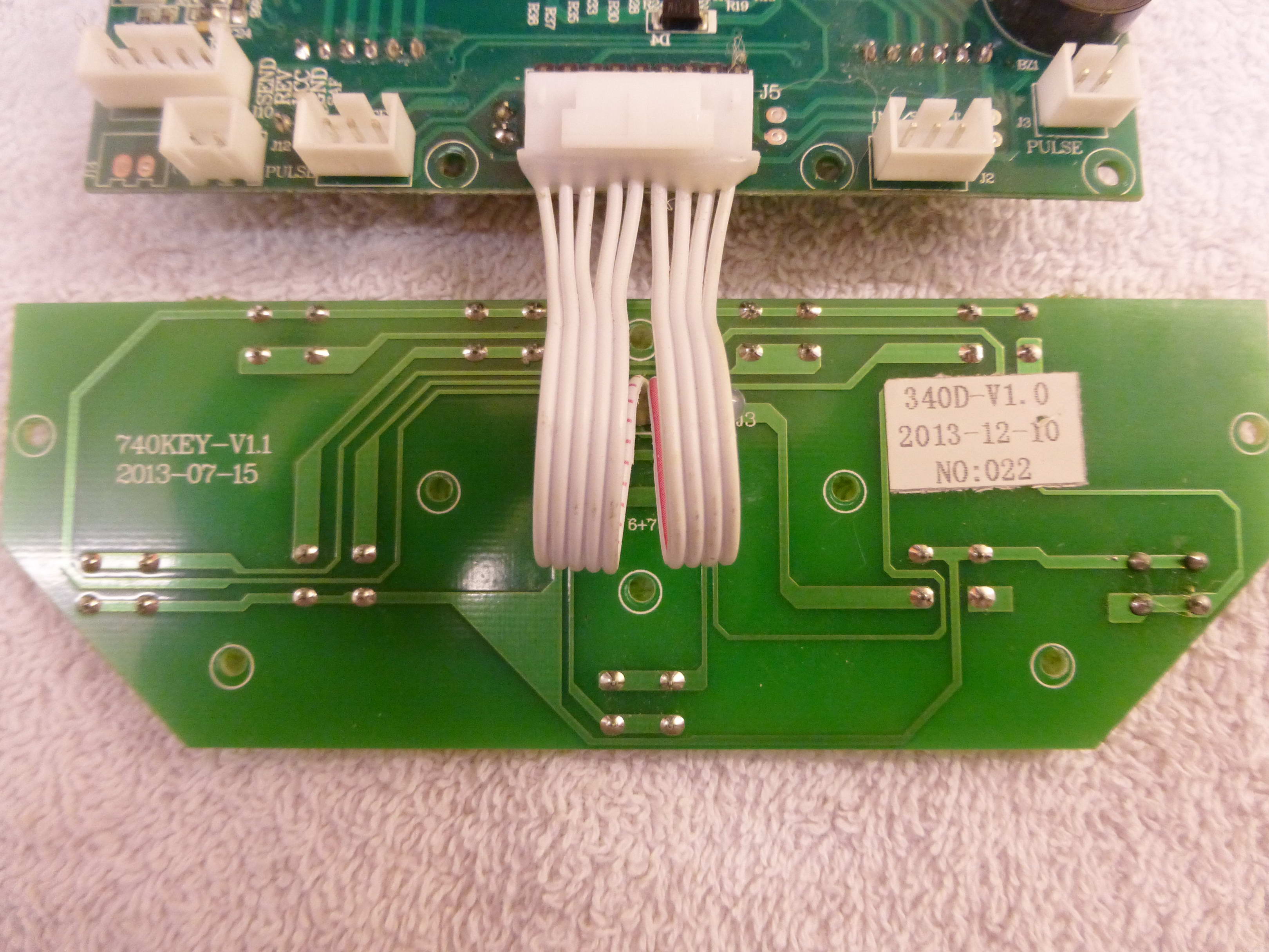

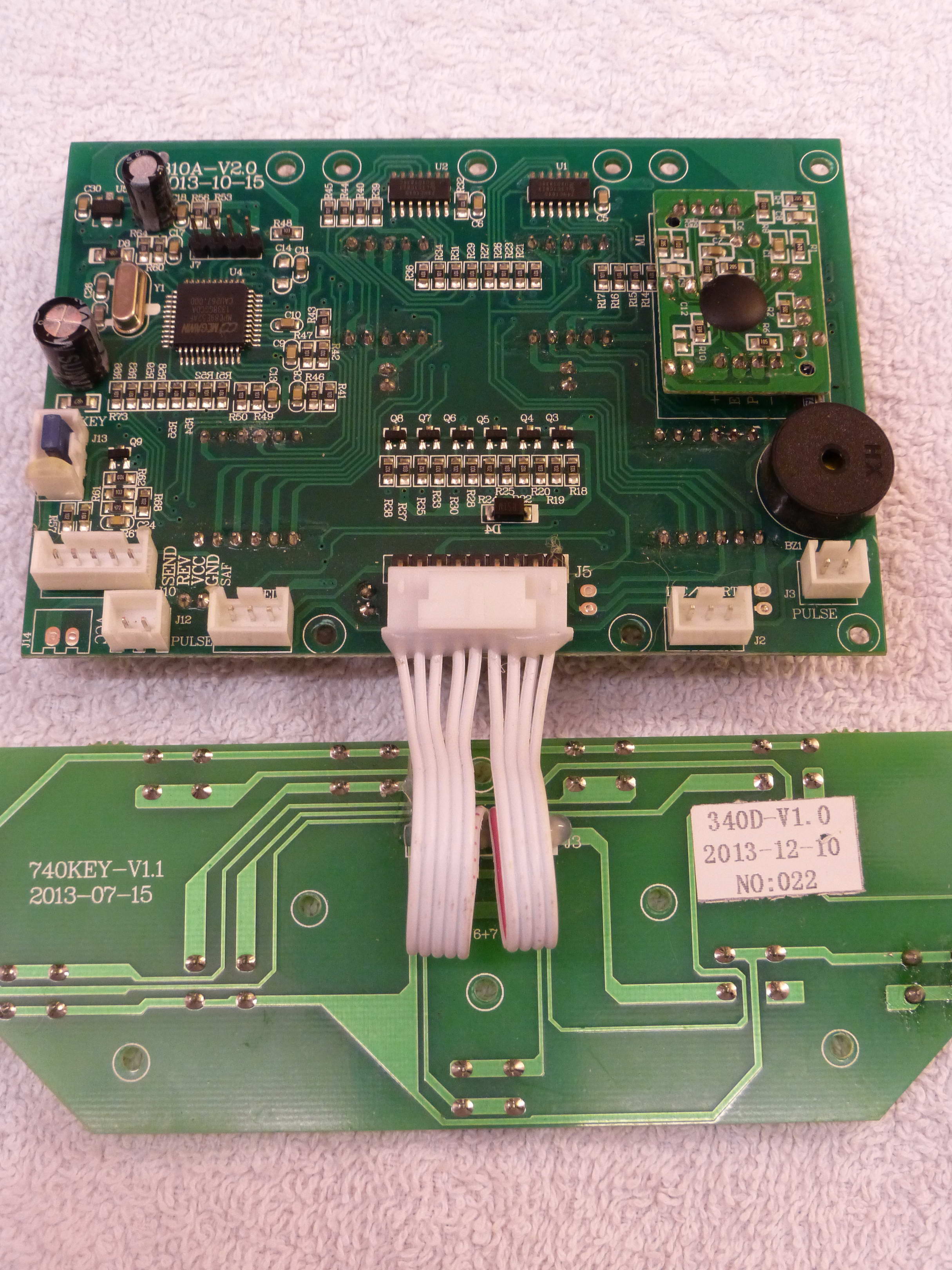

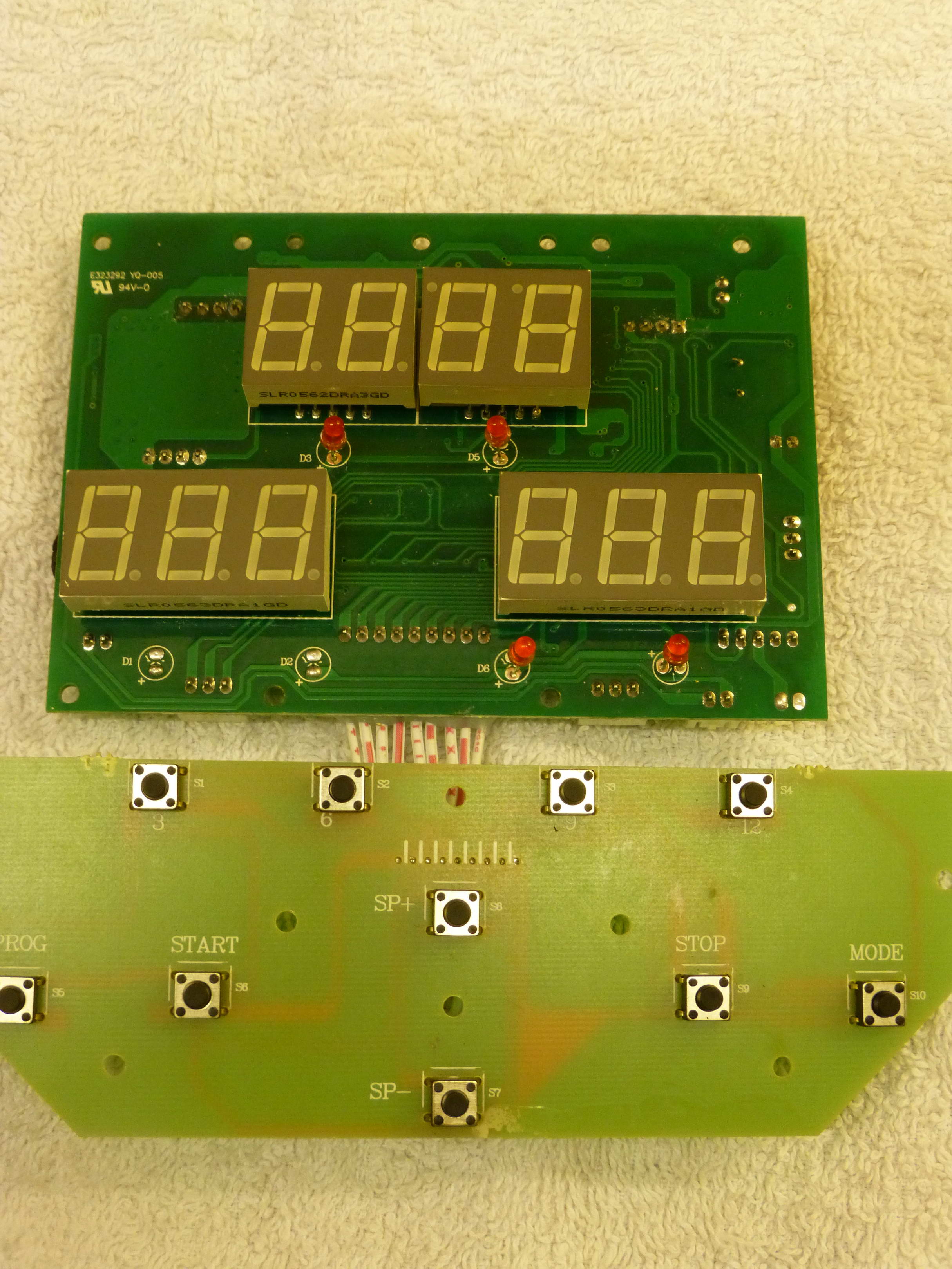

Hi Scott, More Pics as promised.
Al

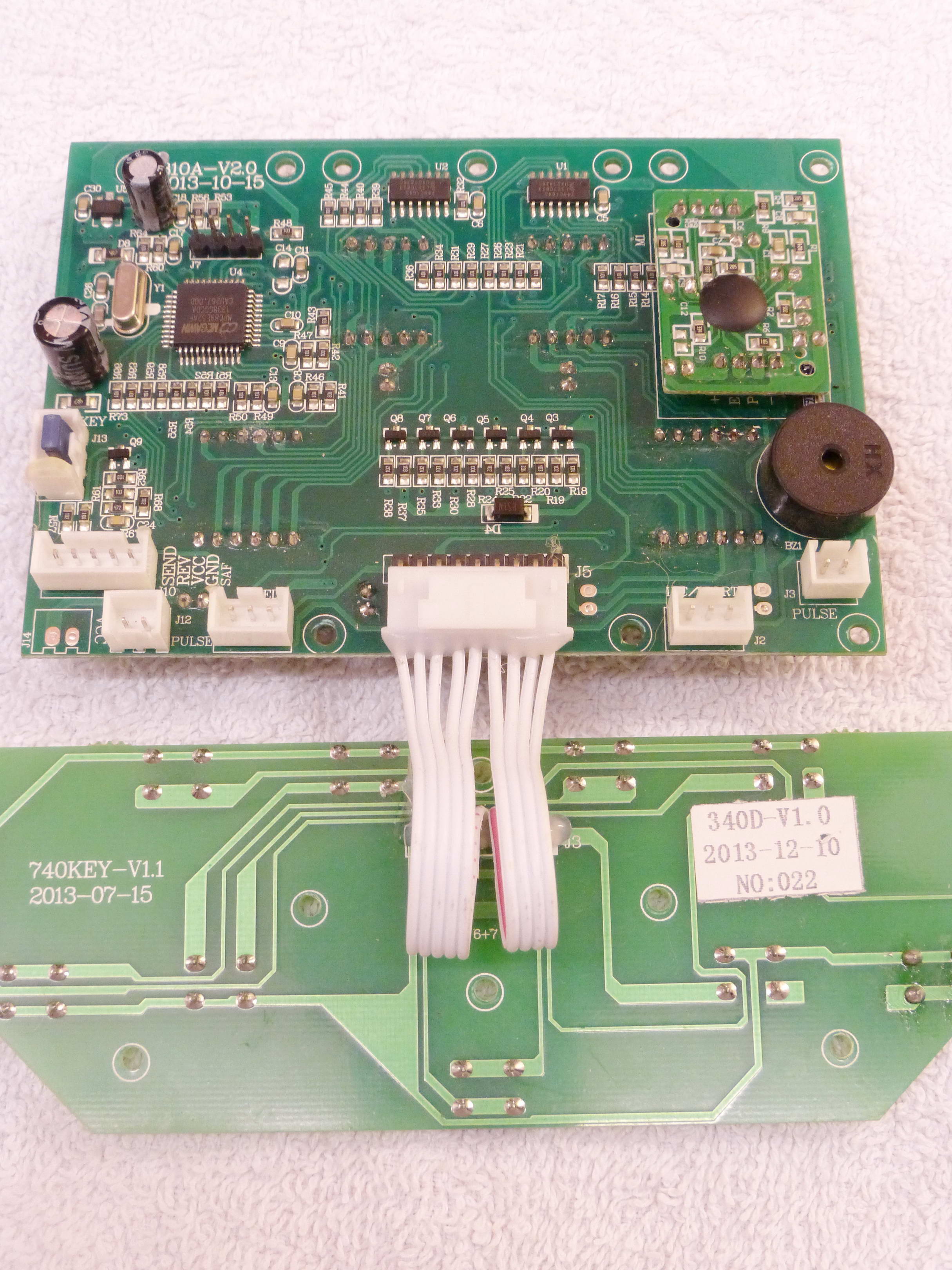

Al sent me the boards, sans motor (the postage would be astronomical..).
I've traced out a schem of the motor control board, and the 'front end' of the display board (which just uses transistors for level conversion from TTL to the ~12V bus).
Please note: The two lines going between the control board, and display board are digital (opto isolated) and both go to the on-board micro. These aren't direct PWM signals.
The good news is when the 'start' button is pressed on the display board, nothing is sent to the controller board - the annoying countdown which delays start-up is all down to the display board. As soon as it finishes its countdown, it starts a signal to the controller board, which turns on the relay to the main power supply, and starts PWM. The controller board also sends a signal back during operation, which I can only assume is a 'tach' signal indicating motor speed. There is no opto sensor input - the connector footprint isn't populated, so I'm assuming it uses back EMF, motor+/- voltages, and current measurements to get its RPM.
I was way off when I thought these were serial-type data bytes. They are both a form of PWM, that seem to 'embed' data in them. I don't have the motor attached so often (95% of the time...) the display board will come up with an error code (E01, E02) probably because no current is drawn, and the motor voltage is high (nothing to load it down). Because of this, I cannot get the display board to send out its 'commands' (or even view the frequency/duty) of the signal it sends to the controller - it expects a return signal of unknown ferquency/duty, and possibly will embedded commands. Without this signal, I have no way of knowing what signal the controller board needs >>. And I'm afraid I don't happen to have a 1.25HP motor to hand :D

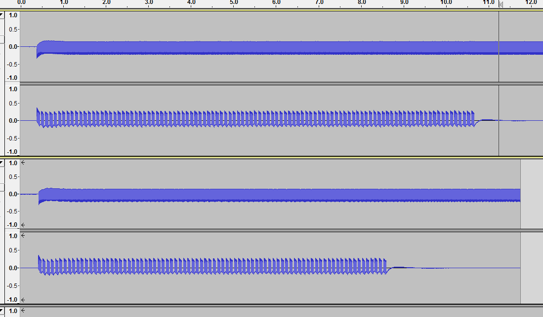

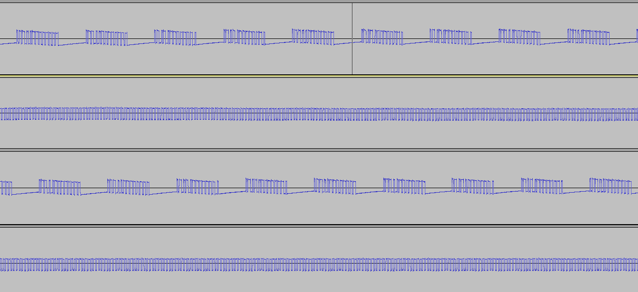

After knocking up a variable frequency/duty oscillator with a wee 8-pin PIC and tweaking it until the console board is happy, I recorded the output
of the console with audacity as a crude deep storage oscilloscope.

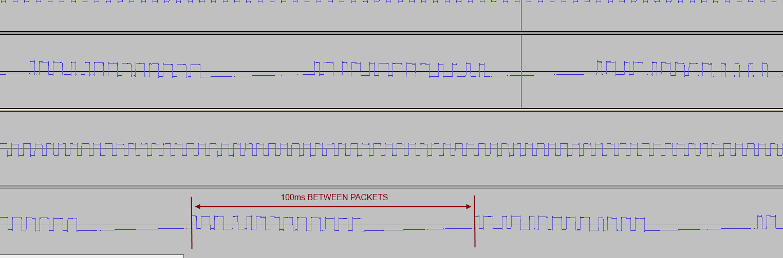

The console board sends out regular 'packets', every 100ms (+/-0.5ms) that does not change at all with speed, I think this is just a regular update so that should the connection between the two boards get broken, the motor stops.
There are two types of 'packet', one includes a 5/6 bits speed value, the second is always the same. If we call the one with the speed value 'S' and the second packet type 'C', they are send twice each -> S - S - C - C - S - S - C - C etc...

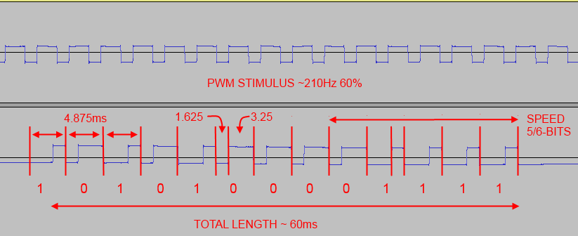

Each 'packet' has 13 pulses. The pulse length determines the bit, with short pulse (3.25ms LO, 1.625ms HI) being a '1', and long pulse (1.625ms LO, 3.25ms HI), idle line is low. Like inverted PWM with either 33%, or 66% duty. Similar protocols are used for PT2262 remote encoders, its self clocking as every bit has two edges.
Note, the micro drives a PNP transistor to drive the optocoupler on the motor controller board, so the micro's signal is inverted, with idle high.
The format of these packets is as follows:
Bit 1: |______---| 3.25ms low, 1.625ms high. Total: 4.875ms
Bit 0: |___------| 1.625ms low, 3.25ms high. Total: 4.875ms
Speed = 1010100000000 - where the last 5 (or maybe 6) bits are speed, ranging from 00000, to 11111.
Control = 1001100000000 - always the same, regardless of buttons pressed. I have no idea if there are any variables in this.

Included are several captures with added notes.
