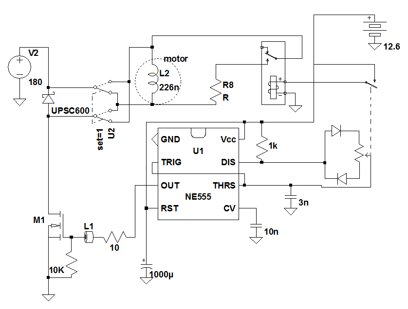

Untitled.png just an idea, not a design
Hi Kinarfi, Hmm, looks workable but like all the designs I looked at so far without a PIC or similar there is no real soft start, which is one of the reasons I went for the DC motor. Like how the brake works though. I was thinking similar but was worried about the relay needing to be energised before the driver started giving power output and holding on until the driver had stopped giving output. Dunno why but a dead short at 180v and a good few amps scares me! ;)

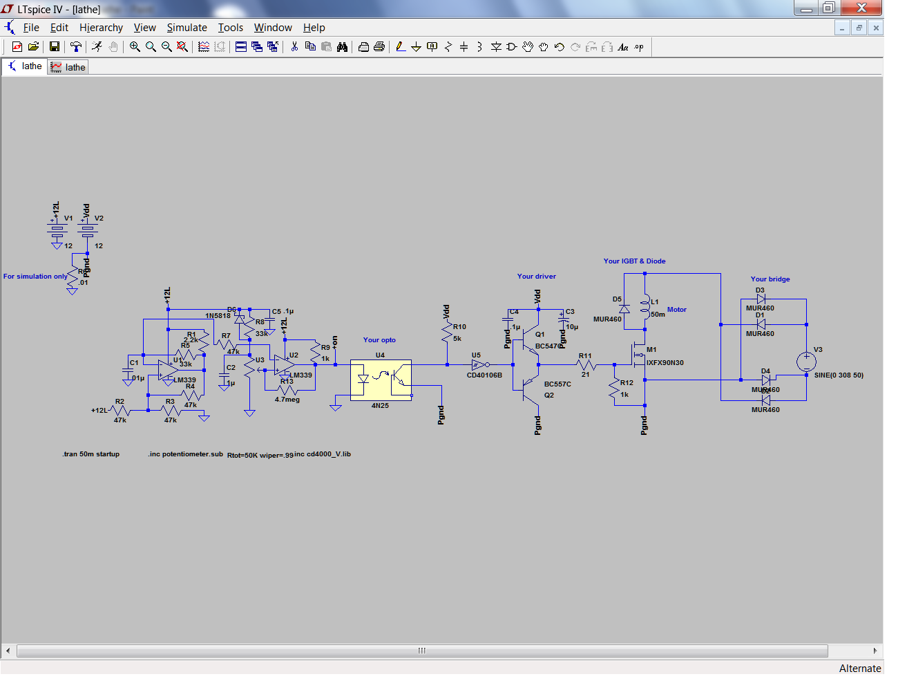

Here is a beginning.

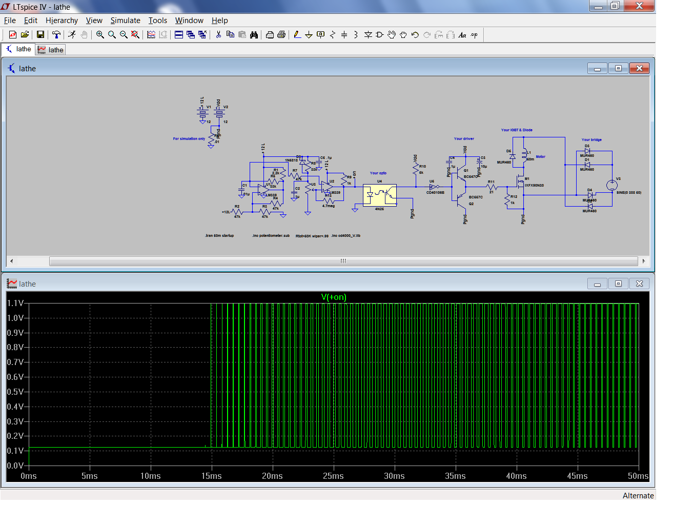

I made the soft start short so you could see it in the simulation, but we can make it longer by changing the 1 ufd. cap.
The 2 power supplies are so the high voltage is isolated from the pot. One concern I have is that it is important that the IGBT has plenty of voltage to drive it before the PWM starts, but I think the softs start will take care of it. Do you have a scope? If so we could look at the time it takes for the 2 supplies to turn on.
I didn't draw the brake and power on switch.

Hi Ron,
Just had a look at the design and now I need to check which components I have and which I need to find. :)
I do have a scope, its an ancient Scopex 140-10v which hasn't been turned on for a few years. I got it a long time ago and repaired it with help from Eric Gibbs and others on this forum, but never got round to using it, or learning how to. If it does still work I could with guidance hopefully check things.
Anyway I will look for the parts first.
Thanks, Al
Ron, can you post the .asc file, please
Sure, Here you go. Let us know what you think.

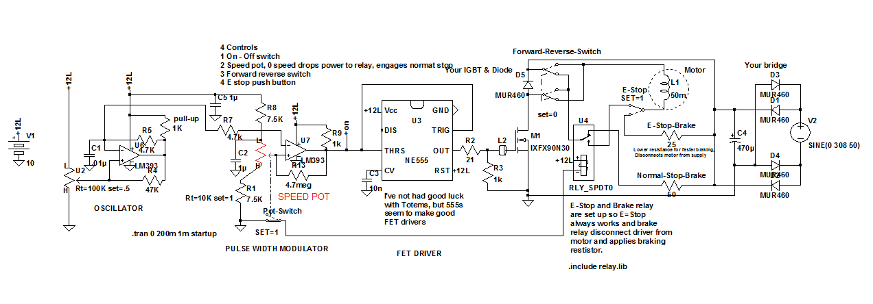

Here's my suggestion, Probably needs some improvement, maybe some safety improvements.
I ran a motor using this type of control and it did NOT provide any braking at all or any soft stop, unless coasting to a lower speed is soft stop, Naaaa, don't thin so

That's a slick oscillator! I like it, I like using the comparator also, allows for full on and full off.
Another thought just crossed my mind (could be dangerous).:rolleyes:
Maybe we could just build a little logic circuit to simulate the button push to change speed.
I don't know how many step there are, but we could make it 2, 3 or 7 steps a second if the micro is fast enough and it probably is.
