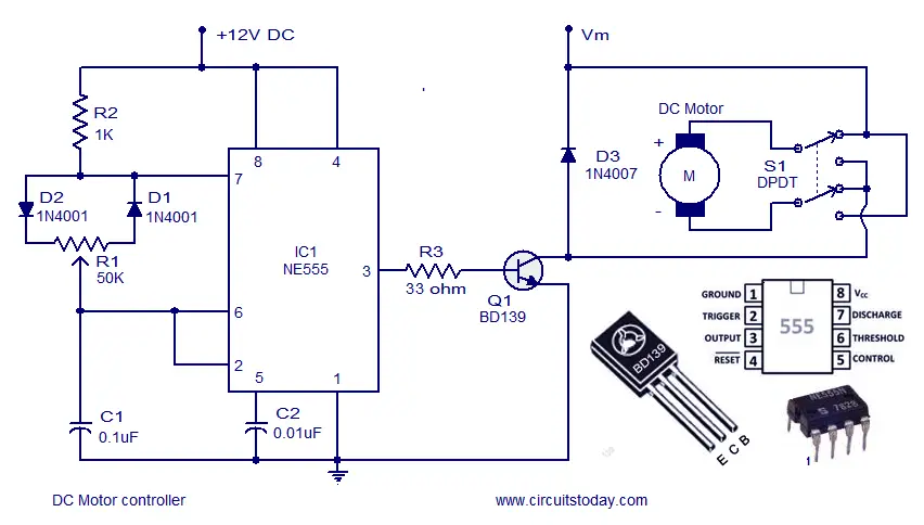

how about this?
https://www.circuitstoday.com/dc-motor-controller
Use your igbt &diode and make your own PWM

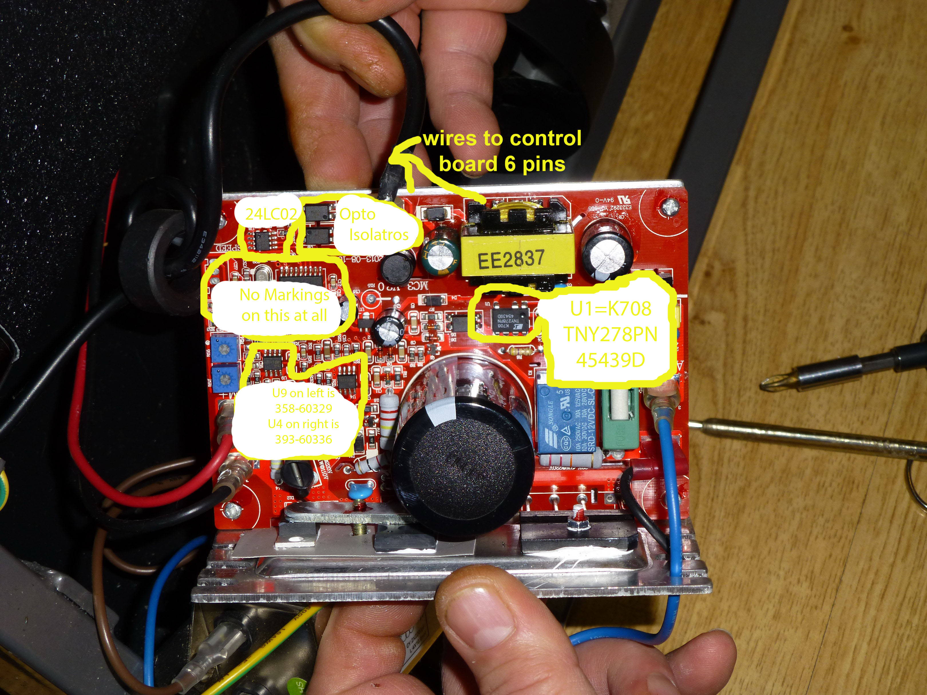

Where does the wire go that is glued to the board?
The pots may also be MIN and MAX speed.
The control panel may be ramping the speed thru the speed control input to the board which may be that wire that is glued to the board.

Hi mate, the pots don't seem to affect the ramp at all but one of them causes the motor to stutter at full scale so I think you are right about them being min and max.
The wire that is glued is actualy six core going to the display and buttons. I have not been in the display part but I will do and report back. There may be more electronics in there than is needed for the serial LED displays etc. I will check.

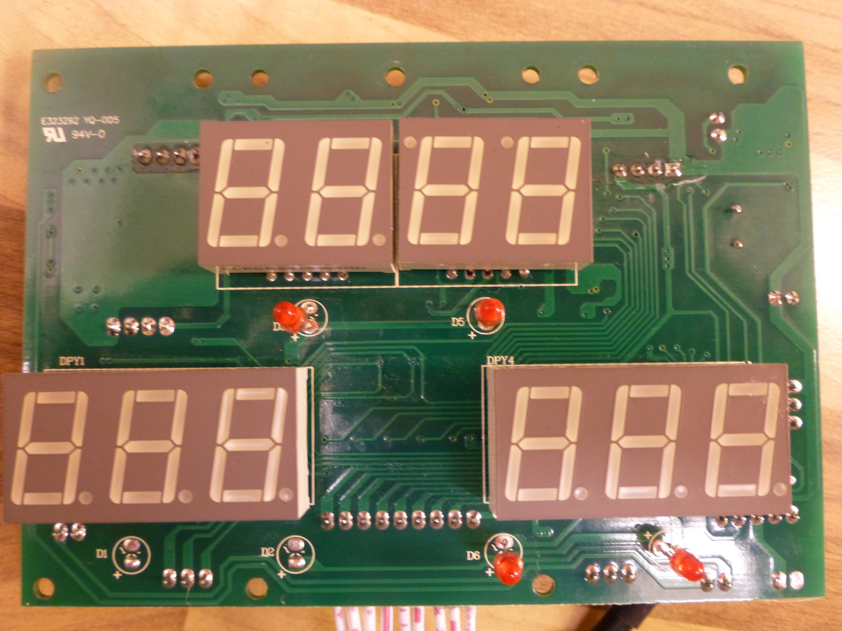

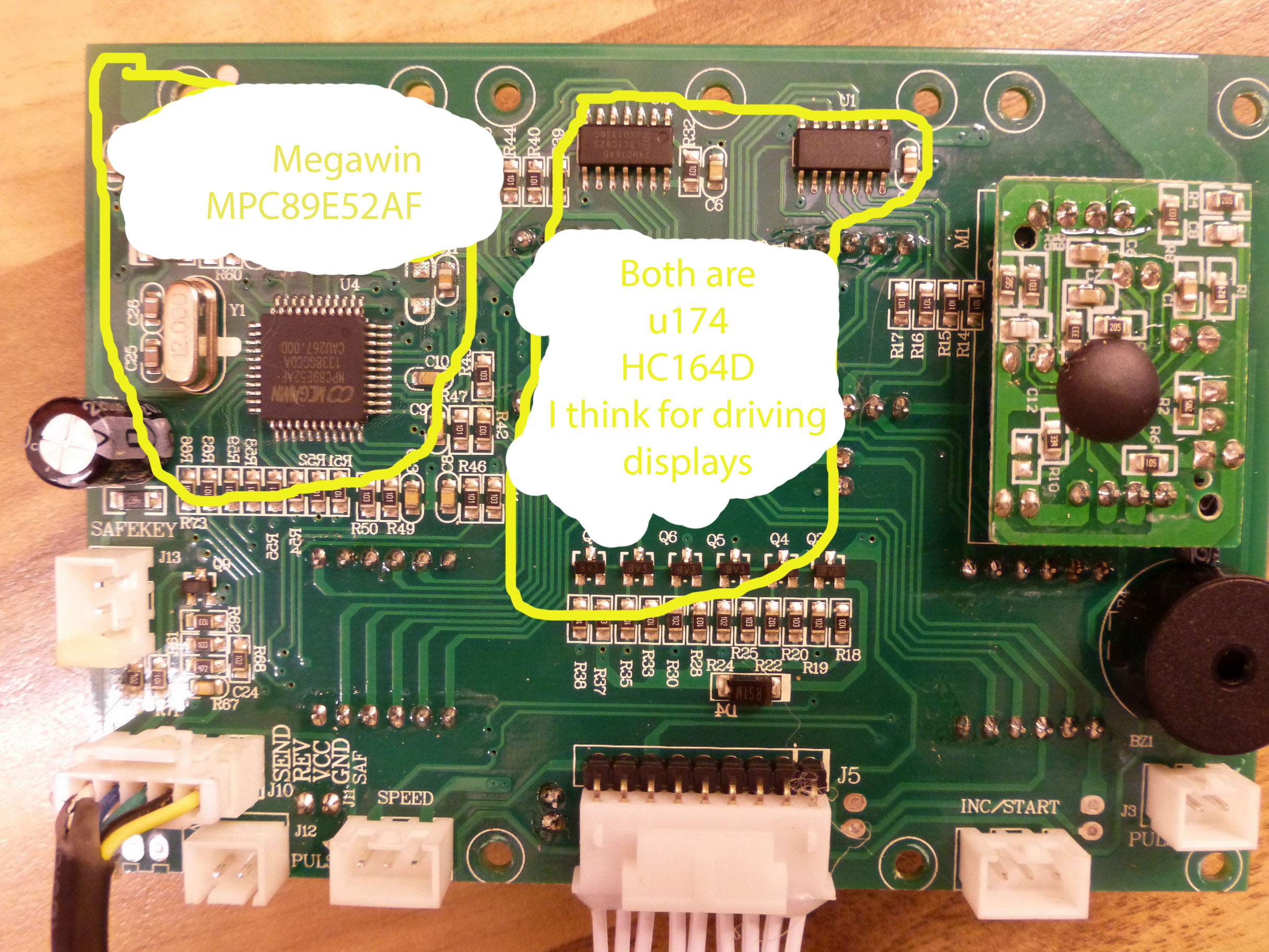

Now I have the motor our I can see it has brushes! Was hard to see in its space. Also I have found more electronics, another 2 boards from the display! One just has switches and a nine pin sil connector to the display board. The main display board is much more interesting though.

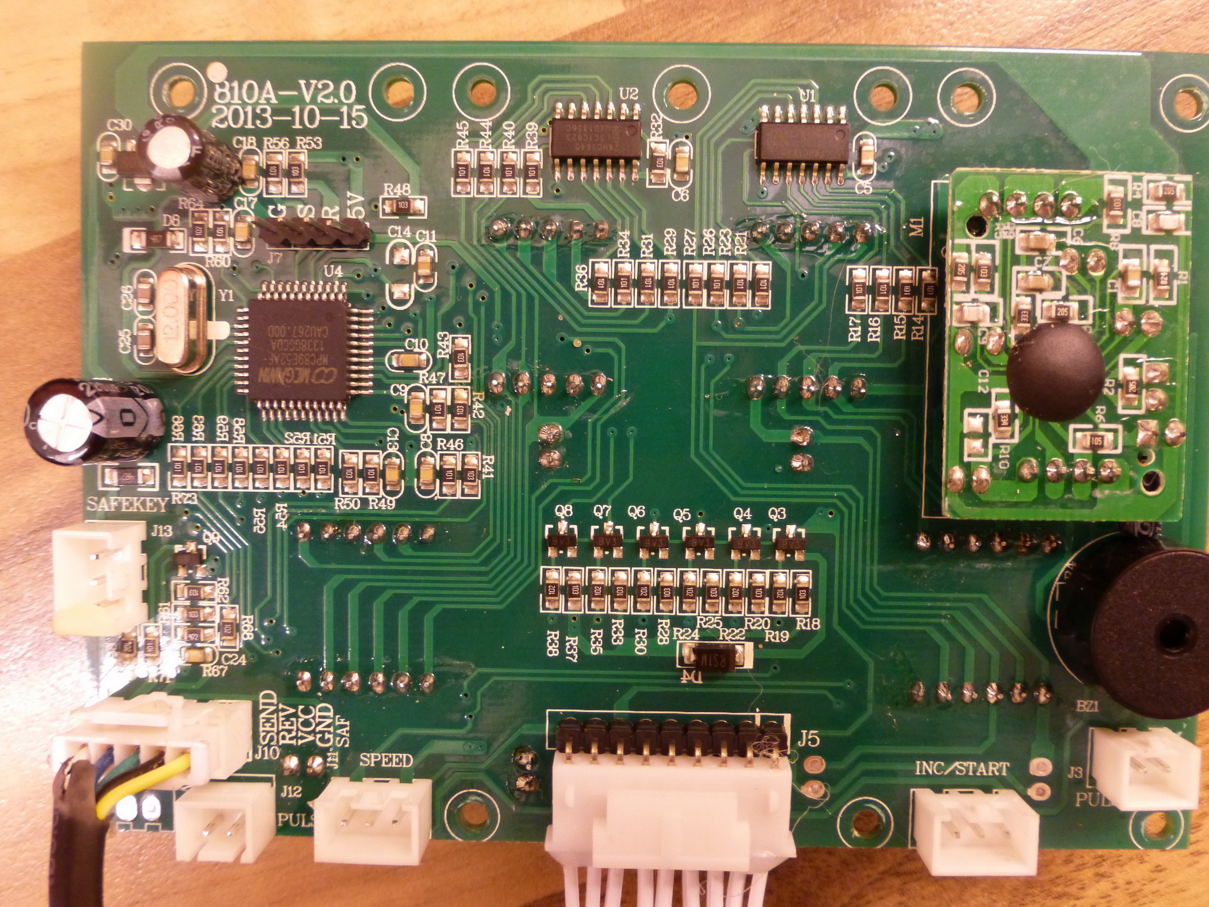

It has 2 x 2 pin pulse connectors, 1 x 2 pin safe connector for the safety pull tag and the 9 pin connector to the switch board. Besides those there is a 5 pin connector that goes to the motor board and is marked Send, Rev, Vcc, Gnd and Saf. Another connector with all the same markings except Saf and 2 separate UNUSED connectors marked Speed and Inc/Start, they are both 3 pin.
This board also has a 12Mhz processor and a couple of 7 seg ICs, also there is a small daughter board on legs with one of those black blobs on it like the kind on boards from childrens toys etc. The processor I mentioned is a MegaWin MPC 89E52AE which according to google is an 8 bit 8051 series Microcontroller.
This board seems way too complex just to be a pulse monitor and LED segment driver so I wondered if it contributes to the actual running of the machine and further wonder if the board was made with multiple models in mind? This leads me onto my final thought. Does the board accept input from the switches EITHER/OR the other two 3 pin connectors which, hope beyond hope I thought may be for a more basic model with just a couple of pots to set the speed and other details?
I will get some pics and hope someone knows more about it.
Edit: here are the pics.
Al

I just had a thought. If the speed connector was designed for a pot then two of the pins should be Gnd and steady +v?
If this is true then is it worth trying a 10k pot on it?
This seems some sort of serial communications plus a safety line.
Does the motor do anything with the 5 pin connector disconnected.
At this point I am going to say its not an off the shelf motor controler but we still may be able to get it to work.
Can you try to hook up a pot to the spot where a connector would be labeled "speed" on the motor controler?
The pot should be around 10k to 100k ohms.

I can see where you are tempted. Almost everything you need is on the little red board.
Top right is a little switch mode power supply - probably for the low voltage circuits. It uses the TNY278.
Bottom right input power and maybe a relay to enable the high voltage.
Across the bottom the high power bridge, IGBT and clamp diode.
But then the top left that looks like a small micro. Therein lies the challenge. :D
But tour right there is not a lot of "stuff" coming into the board.
Where does the black cable go?
Is that a connector below the word speed?
Black cable 5 conductor goes to the display controller board. May be serial communication.
I think the spot labeled speed is where a connector would go for a speed pot.

If you could find the driver ic a 1 chip pwm and an opto isolator would probably do it.
Maybe part numbers of the ICs at the bottom left??
Here are some updated pics with all IC markings I could find.
Are they any help?
Al
