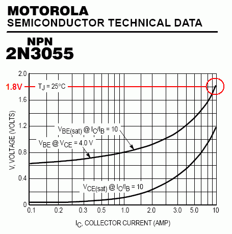

Hey Jim,
A 2N3055 is a silicon transistor with a 15A max collector current. At only 10A, its Vbe is typically 1.8V and could be much higher with a 15A collector current:

OK point taken.
But for the average small signal transistor.....
1.4 Volts Vbe = Busted!

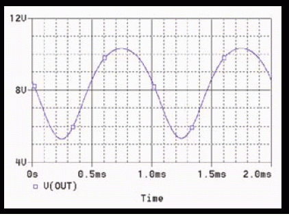

In a common emitter amp without an emitter resistor providing negative feedback, a low impedance voltage input would result in severe distortion at the output.With the output swinging less than half the total supply voltage, the distortion is 15% as shown here. The distortion increases with a higher input/output.

audioguru said:
Yeah, Len.
An emitter-follower has 100% negative feedback so the tiny amount of exponential change in the base-emitter voltage is nearly negegible.
We're talking at cross purposes. You're referring to the AC situation, whereas I'm talking about the fundamental theory of transistor operation - the DC bias voltages and currents.
In a common emitter amp with or without an emitter resistor providing negative feedback, the collector current is an expontential function of the Vbe. Vbe is the DC voltage across the base - emitter. Certainly the AC signal has to be a small fraction of this voltage in order to prevent distortion - as you said.
In any circuit where the transistor is in the active region (ie. not in cutoff or saturation) the collector current is an expontial function of Vbe.
