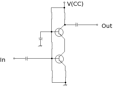

I haven't tried it but maybe some linear IC's work like this:
1) Connect the collector of the common emitter 1st transistor to the emitter of a common base 2nd transistor.
2) Maybe the collector current of the 2nd transistor will be linear with a linear voltage into the base of the 1st transistor. I think the distortion will cancel.
That would be a "cascode" configuration. Useful for a variety of purposes: as a high frequency, high input impedance RF amplifier, a single-ended mixer, and one way to increase negative feedbacl to improve linearity.
It's late, I don't want to do more maths since I just finished doing my daughter's income tax for the 2nd time in 2 days (she found more receipts today) and now I'm thinking that a cascode connected transistor pair doubles the distortion of only one transistor. :?
Perhaps it does, and perhaps it doesn't. The usual applications I put this configuration to have always been RF apps, where tuned circuits and/or filters makes that irrelevant. However, **broken link removed** recommends this as a possible implementation, not specifically because it has a lower inherent distortion, but rather as a means to increase the negative feedback. Being able to increase that feedback improves linearity, and reduces distortion.

It's commonly used in oscilloscopes and TV video output stages, the configuration gives good linearity, low distortion, wide frequency response, and a very high output swing.
Yeah, the bottom transistor in a cascode pair doesn't have any Miller influence since its collector isn't swinging up and down. The upper transistor also doesn't since its base is at AC ground. The result is a very wideband amp.
Now I see that the upper transistor doesn't have its non-linear transconductance multiplied like the lower transistor, therefore the total non-linearity is slightly more than a single transistor. :)
