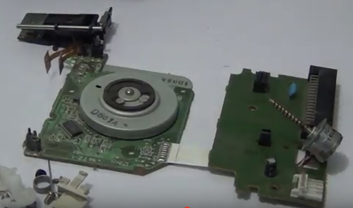

What kind of Motor is this and can it be used in some if any small hobbyist projects?
Nerkec
Sorry if this is not in the right subforum I'm new here.
Okay so I found this baby today in a box and after googling for a bit I came to a conclusion that this is in fact a motor. It sparked my interest and now I want to do some simple electronic projects.
What motor is this though, it is what I failed to understand? AC? DC? Something else? Can it be used in some projects? Thanks a lot!
Looks like parts possibly from a floppy drive?
Both parts are motors and can be used in projects - the left one may be a 3-phase, or "Brushless" motor, and the right one may be a bi-polar stepper motor.
An internet search for those terms will help you to identify the type, as you have the items in front of you, and can confirm the number of connections each motor has. Once the correct type is identified, suitable drive circuits can be sourced or built.
Hey thanks a lot! Yes they're from opened floppy drive I found. Time to dive in some tutorials! Thanks once again. Cheers

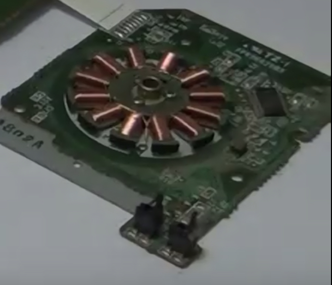

The large one looks like a miniature version of an LG direct drive washing machine motor. It might be worth googling as some people have designed drive systems for them.
Yes, it is commonly known as an 'Outrunner' similar to now used in RC brushless motors.
It basically a 3ph motor/generator.

I don't know if disk drives used motors like this with linear motion but all of the cd and DVD players used them. Something had to move the read/write head for magnetic disk drives too. I vividly remember the sound of a stepper motor whining so, I assume it was a stepper motor and a screw as shown. If you've never seen one in a magnetic disk drive, how do you propose the read/write head was controlled?
Oh, look, from 2:01 of this 3.5" foppy tear down video...
A photo of the OPs motor - it moves the read-write head...
And look, from 2:27, the other motor that's the floppy spinning motor...
shortbus= Nailed it.
^ The worm on the shaft of the motor, in the penultimate pic, is the drive part for moving the head carriage.
That shaft does not move in and out of the motor.
Correct. True for the OPs motor and for the one in the video.
And for every single CD and DVD player, of which I've repaired hundreds - they work in the exact same way, a rotary motor (usually just a DC motor, not even a stepper) the shaft of which has a coarse screw thread on it (as in the pictures here), with the sled directly mounted on that thread and running along it.
