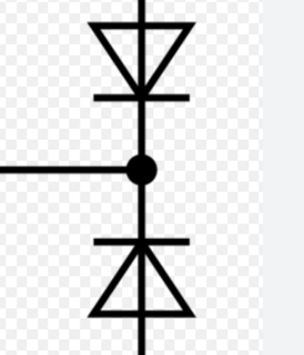

What is the function this united Ds instead of a D
What is the component function has united two Ds, it's seen used just to function a D rectifying from the 2 || pins at right to output at left
No real image, just it looks like Fet transistor
is there a necessary function else than such, so it's favored to be produced as a integrated component?
Note normally used to seeing them connects as :

Without a total schematic not easy to answer your question.
If connected to a I/O pin of a cmos part its normally to insure pin
never violates Vdd >= Vpin >= Vss. To insure no significant current
flows thru onchip parasitic diodes which can cause CMOS latchup.
Regards, Dana.
Is this symbol connected with a real part?
Not sure what you mean by a "FET transistor". Did you just make that term up? Literally it means "Field Effect Transistor Transistor".
