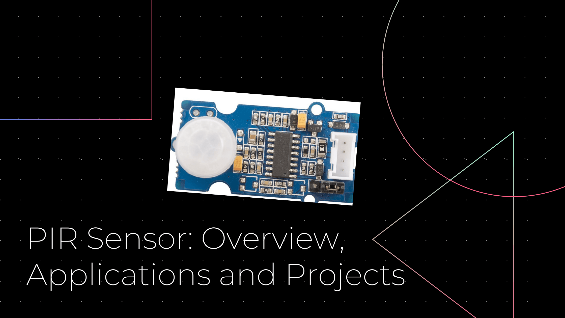

You need to make a lot of choices - first off, what power source are you planning using?. Then you need a micro-controller (to do the timing etc.) and a motion sensor (PIR module).
Small size requirement may well make life difficult.
Your best bet will be to use a small (8-pin) microcontroller to monitor the sensor, light the LED when required, and time out the interval.

Dana, many thanks for the url's. After following I see that the mini PIR motion sensor module is 0.75". Is that to your knowledge the smallest PIR available? If so then I'll have to upscale my project size

It maybe but (s)he's not told us their needs so anything is a possibility, also, 0.75" (18mm?) diameter (2 or 3D still not known) would require the PIR electronics to be part of the design. The PIR sensors I linked earlier may provide what is needed (circuit wise) but without knowing the application we're just guessing.
If you look at the link on post #13 those are the only sizes I am aware of.
Alternatively a doppler radar sensor potentially smaller -

My apology, I have forgotten to mention I am looking at a CR2032 as the power source.
Update---after looking at the PIR motion sensor the smallest one requires 3.8-24v and a CR2032 is not sufficient at 3.0v.(https://www.futurlec.com/Mini_PIR_Module.shtml)
It appears that since all AA, AAA, C & D batteries only supply 1.5v that none of them will be sufficient. Not sure where to go from here.

A CR2032 will certainly power a small LED for 60 seconds at a time.
The voltage of a CR2032 is close to the voltage of a white LED, and some cheap lamps will just connect them directly. The problem with that approach is that the brightness is very dependent on how new the battery is, and the battery can't be used down to completely discharged, which is about 2.5 V, because it won't have enough voltage to turn on the LED.
A proper current control circuit and boost regulator could easily give 5 times the life for a particular brightness.
The other issue is the power to run the PIR detector. I know that those are quite low, as there are battery powered PIR lights made already, but you do need to make sure that the battery life even without turning the LED on is enough for your application.
If you can't get a PIR module that will operate directly off the battery, then you can use a DC-DC converter, e.g. a inductor-based boost converter, or a switched-capacitor/charge pump. The QX23xx series look alright; they don't need many support components, are cheap, small, and have low no-load current of ~15uA. ref: https://www.lcsc.com/search?q=qx230
Also note that they progressively drop to around 1V as the discharge, over their useful lifetime.
To guarantee 3.8V minimum, you would need four cells.
A 9V battery would work, that would still give at least 6V at the end of it's life.
As Diver says though, you need to allow for the permanently ON PIR module and the current that takes.
The data says "<1mA" so allow 1mA permanent load, and work out the possible battery life from that before choosing a power source.
A good named brand alkaline PP3 / 1604A battery has a capacity around 550mAH.
That means the PIR would run for 550 Hours, not allowing for alarm / LED triggers and the power that takes.
That means a battery life of just over three weeks.
In comparison, a high quality 2032 lithium cell plus a boost converter (and not allowing for the power losses in that) would be roughly equivalent to a 6V 100mAH battery, so a maximum life of about four days.
