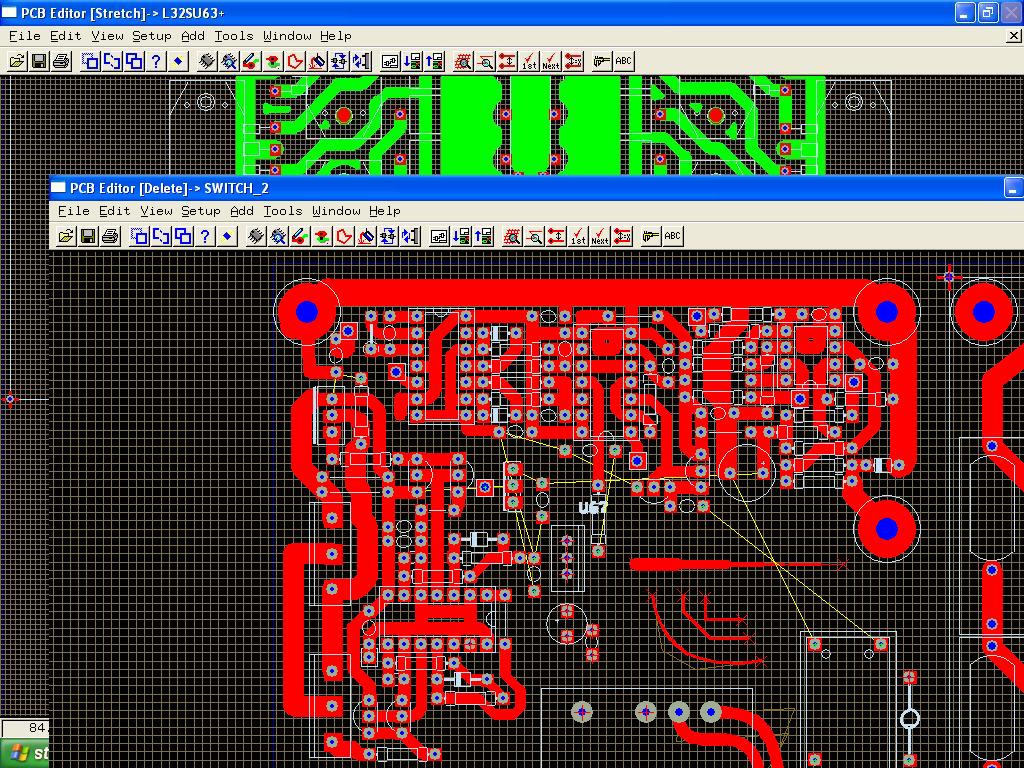

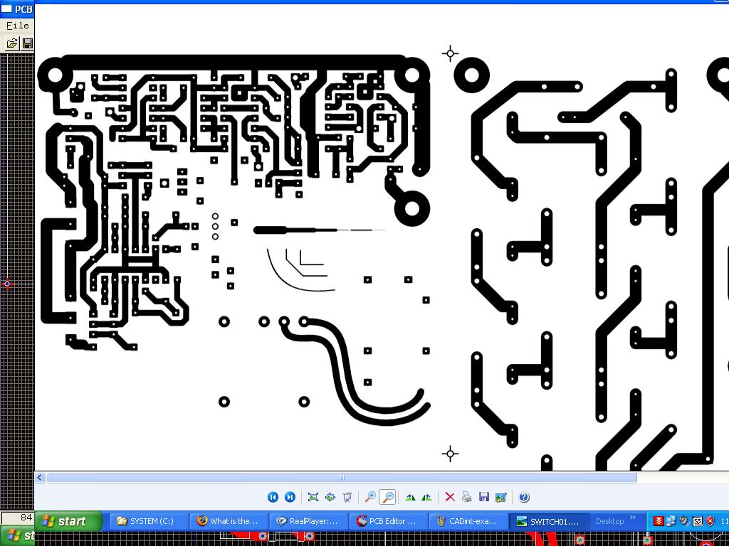

About the CADint demo version
OK, might be not the best CAD software, but I used it.
I also used Eagle for fast design.
Here more picture about environment and printed layout.
Demo version is limited for 250 unit net used. They using Netlist.
