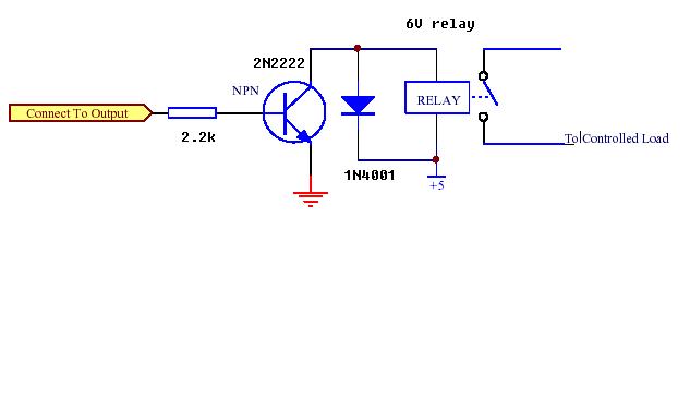

I using a 6 volt relay to operate my DC motor, the signal is from microcontroller.... is rated current is around 2mA.. then i using one transistor 2n2222 to swtch on the relay.. at first it work well. can switch on the relay.. but after i connect the DC motor together with the relay....
when a signal is send from micrcontroller... relay doesn't work anymore..!!! why ya~~~~!!! pls pls pls......urgent.!!!!!!!
I'd say the relay did its spiking thing (it does have a technical term) when the contacts closed, and this destroyed either the transistor, the IC, or both.
You should always put a diode across the coil of a relay to stop this happening 8)

Hey...... i tired to add diode (1n4001) between the relay oledi... i works well.. the relay can switch on the dc motor.... but when i but a high torque motor one.... but cannot switch the relay .`~~~ what happen?? any idea???
I using.... diode 1N4001, RELAY 6v, transistor NPN (2N2222), signal from Microcontroller... rated current around 2mA.... !!
PROBLEM>...... when put the normal dc motor.. relay work perfectly... BUT>>> when put the HIGH torque motor... The relay just click one time... then cannot work anymore.~~!!........ i want learn the solution..!!!! :?

This is my connection for the relay...!!!!!

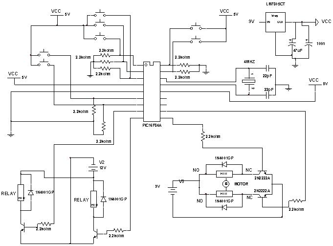

thanks for ur suggestion... but i still not clear how is the conneciton for the capacitor?? to which +5 supply~~~ below is my circuit to control the motor using relay~~~!!!!!
for the motor part i didn;t put any capacitor o wat... just as shown above the relay connection..... !!!! i have no idea at all .... when use high torque motor... the PIC will deep loop....!!but i refer to other's people connection.... they all also the same..!!! how ya??

That's more like a block diagram that a circuit diagram!, I'm presuming there's a lot of parts that you're not showing?.
We need to see the exact circuit, as you have it connected, including the power supply, and all decoupling capacitors - everything!.
As you show the motor being fed from +5V, I'm presuming that you are using the same supply as the PIC?.
If your power supply uses a 7805 regulator, as soon as the motor turns ON it's liable to draw more than the 1 amp maximum the regulator will provide - so the +5V rail will fall drastically, the PIC will reset, and the motor will stop again. It's advisable to feed any heavy current devices from a different supply to the micro.
This is why we need the FULL circuit, instead of just guessing!.
here is my circuit.... i hope that can make everyone more clearing.... erm... i using 78L05 as my Vcc .. supply... yup..motor supply is separately...!!! is it possibly i connect the smae suppply to all the motor together???........... i didn;t use any capacitor in my this circuit..... as shown .... thanks~~!!!!! :roll:

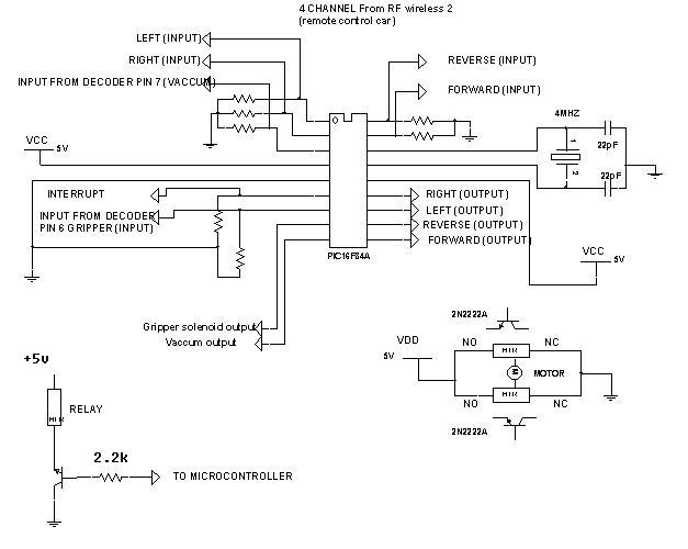

sorry~~~ this is my circuit....... wat uis NTC thermistor?? how about if i use 9v relay?? like soneone suggected above??? is it possible to solve the problem ????

You're now showing four different supplies, but with no suggestion of where they come from? - are they four totally seperate batteries?. Also, you're still not showing the 5V regulator, so we've no idea what interaction might exist between the 5V supply and the other supplies, or if you've fitted the essential capacitors close to the 78L05?.
Okok... erm.... i using 3 separate supply... all the Vcc is from voltage regulator 7805.... and V2 is 12v for both and V3 is 9V for another part... total 3 supply... i didn;t put any capacitor at there except for the voltage regulator.......... is that ok?? erm... shoule i put any capacitor at the supply of the 12V and 9V?? hope this will make sir clear.. about the information....... :wink:

You certainly need some capacitors about, for a start the spec for the 7805 requires capacitors as close as possible to the input and output pins, you show capacitors on the output, but not the input. I would suggest a good size electrolytic (470-1000uF) on the input side, as well as a 100nF close to the pin of the 7805. I would suggest you also add similar large capacitors on the other supplies.
I would also suggest you mount capacitors as near as possible to the PIC supply pins, a 100nF or a 1uF would be suitable (a 1uF electrolytic may well be smaller than a 1oonF).
You say you have three supplies?, what feeds the 7805?, is it the same 9V that feeds the motor? (in which case you've only got two supplies) - that could be a prime reason for your problem?. Are you using three totally seperate batteries?.
YEAHHHHHHHHHHHHHHH.... i solve the probelm oledi........thanks everyone.............. because u all give me suggestion and wat is the problem ...!!!!!! i tried to solve.. it...... finally.... its work perfectly...!!!!
under using high torque motor.........!!!!!!
Soluiton...at first i put filtering at supply , across relay.. all cannot...still the same thing happen ....then i tried to put capacitor acrosss to the motor's leg..... as shown the circuit !!!!!! i put 100uF.... .... its work....!!
