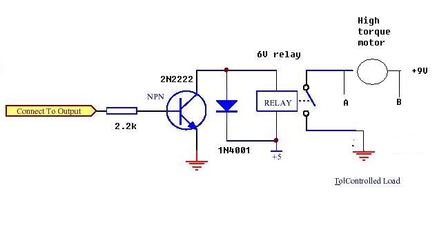

What happen to the relay????

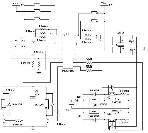

I recommend to use optocouplers in the motor circuit, in this case no common GND with the high-current motor.
have you connected the grounds together?
this is a common problem with using different power supplies..
without the grounds connected the signal comming from the pic has no reference, thus it will not work properly..
conclusion :: connect all grounds together.!!
Yoo... if i use different supply for different motor...... fro exmaple 9V fro motor 1 12V for motor... 5V for PIC... all supp,ly is separately..... i didn;t connect all the ground together...!!!!
cos i tried before when i cpnnect all togther with same suply... i pic burn. damage.. immediately...!!! sad..... :?

his motor load is too high for an NTC thermistor
@Gundam28
what are the specs of your motor ,current consumption as well as voltage requirements?
hey.... erm.. i got one motor is needed 12volts..... then another is 3 to 5 volt...
at first turn on 12V.. relay no problem.... but when i using high torque one.. its a dc gear box..... relay problem happen~~~!!!! its only 3 to 5 voltages only.......!!!!!
