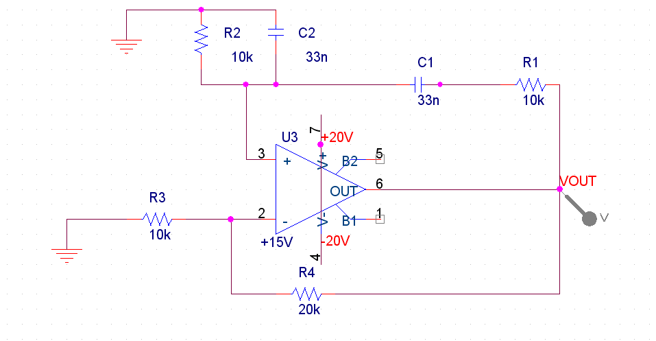

i have done a simulation of a wein bridge oscillator (without amplitude control)
from the simulation, i noticed that the output voltage(pk-pk) of the wave is approx. 2.2V and is the sine wave is not really centered to the x axis of the graph.
My circuit and simulation results are as attached.
Considering the fact that for oscillators, any transient noise signal is able to cause oscillations,
How do i determine the value of the output amplitude signal considering that there is no input source involved? (How is 2.2Vp-p in simulation obtained?) From the simulation, it is also seen that the initial start up small oscillations start from slightly below the x axis (below 0V).Why is this so?
The power supply voltages for the op amp are +20V and -20V in symmetry. Why is the wave still not centered evenly on the x axis? Is there any theory behind this or its just a simulator related problem?

Besides that, it is stated in theory that if the gain on the negative feedback loop is increased higher than 3, oscillations will increase in amplitude .and if the gain is reduced to less than 3, the oscillations will diminish to nothing..
From the feedback formula Avf= Ao/(1-Ao*beta)
i calculate that
  • when i increase the gain to higher than 3, AVF will be a negative number
  • when i increase the gain to lower than 3, AVF will be a positive number
why does a negative gain increase amplitude while a postive gain reduce amplitude? shouldnt it be the other way around?
or is my approach on the concept wrong?
________________________________________________________________
In the Barkhausen criteria, a 0d phase shift is required.. I understand that the frequency selective feedback loop provides a phase shift of 0d. How about the gain feedback loop involving the 2 resistors? My lecturer says the opamp provides a phase shift of 180 and the feedback gain loop provides another 180 totalling a 360.. but some teaching material on the internet says there is no phase shift by the op amp...
Help is very much appreciated=)

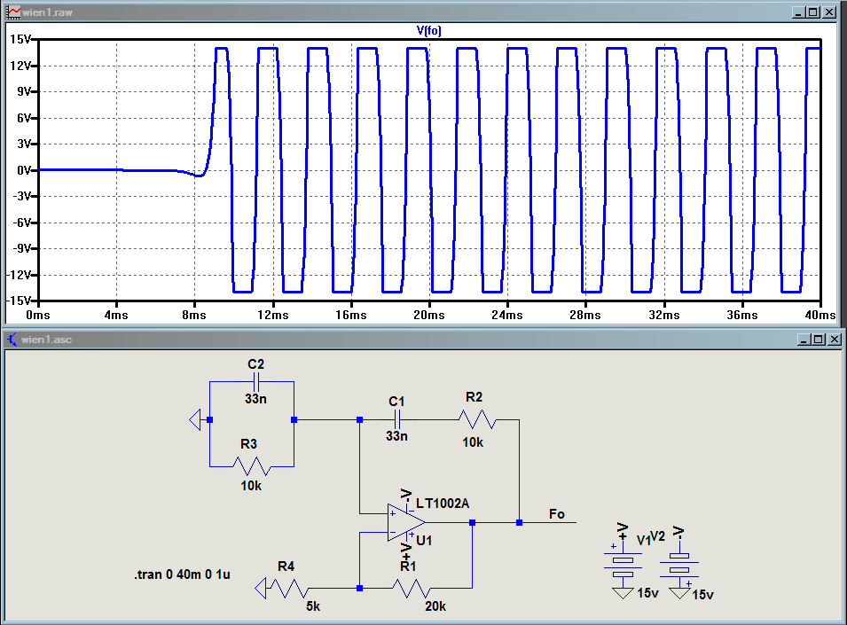

For comparison I will run your circuit in the LTspice sim.
Ref the 180deg phase query, as you maybe aware the INV input and OPA output are inverted, so its '180deg' phase shifted.
In an ideal OPA, amplified signals should not be phase shifted.
Are these the two versions you are mixing up.?
I'll post the LTS sim later to day.:)
Using your circuit the osc dosnt start up, the gain is 2.
With a gain of ~4, it starts, but as you would expect its a square wave output.
The plot shows no dc offset in either case.
The fact that it oscillates and produces a sort of sine wave in your sim, suggests its an artefact of your simulator, which sim is it.?
To get a sinewave output you must have auto adjusting gain control, using either a small tungsten lamp or FET or diode bridge.
hey eric
thank you so much for your replies and for your time=) i really appreciate it.
im using the Orcad Capture Lite Edition..
If it helps, i was using the L411 opamp but i just changed it to the uA741..using the latter, i got a square wave if R2 is exactly double R1 (Gain=3)
When i adjusted the gain higher by increasing R2, a sine wave was produced.
im actually kinda new at this stuff so im not too sure why i got a square wave if the gain was equal...
i understand that in practical-wise approach, if the loop gain =1 then there will be no oscillations unless i increase the gain slightly higher to overcome the dissipated power caused by resistors.
why is it a square wave output?

Must have auto gain control, a wire ended mini-lamp works well.
Look thru this OPA guide for the phase etc, useful pdf.:)

Your concept is correct. When the the gain is sufficient to make the denomanator of your equation zero, then you have gain that increases without bound, which is what is requried for oscillations. An oscillator is basically an infinite gain element, as the equation clearly shows.
The frequency determining RC networks are a lowpass filter with lagging phase and a highpass filter with leading phase. The two phases cancel and produce no phase shift at the frequency where they have the same amount of loss and produce a peak with a loss of 3 times.
They produce positive feedback for the opamp.
The opamp is a non-inverting amplifier with no phase shift and a gain of slightly more than 3 times. Its amplitude will keep increasing until the output of the opamp clips the positive and negative peaks.

You're only considering the absolute value of the loop gain. In fact, the loop gain is a complex number. I won't go through all the math, but essentially, a negative loop gains indicates positive feedback, which then means we have infinite system gain, as we previously discussed.
is it because the imaginary part of the loop gain equal to 0 resulting in no phase shifts thus causing positive feedback?
The imaginary part is not zero. The poles of the oscillator are complex conjugates. The point at which the loop equation goes negative is the point at which the feedback becomes positive. If you plotted the poles on an s-plane, you would see this.
Don't feel bad. I had to dig out my old text book and try to remember how this works. :)
It does not matter what your lecturer says because he is wrong.
The opamp, the two cascaded RC networks and the voltage divider resistor network produce no phase shift in this circuit.
Don't you have an oscilloscope? It will show that the phase at the output of the opamp is exactly the same as the phase at the (+) input of the opamp.
Did you the math for the feedback circuit? You should get, for 1 + AB:
1 + A*jw/RC/((jw)^2 + jw*3/RC + 1/(RC)^2)
Now, in your feedback equation, you have in the denominator:
(jw)^2 + jw*(3 - A)/RC + 1/(RC)^2
Now, the dominator dissapears for W = 1/RC, and A = 3. The poles are on the imaginary axis at this value of A, and the system is marginal unstable (which means it will almost oscillate). For largers values of A, that terms changes sign. Also, the poles of the expression are now in the right half-plane. Now, you have increasing positive feedback, and your system will oscillate even more.
A bode plot would show positive phase at frquencies lower than W, and negative phase at frequencies higher than W. Also zero phase at W = 1/RC.
Does that make sense? Sorry I can't plot the poles. Look up pole plots of 2nd order feedback networks.
