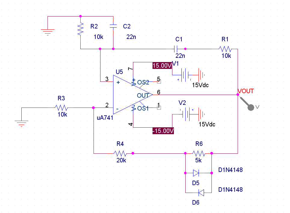

is it correct to say when the signals are small, the diodes are not conducting and the gain is higher than 3..when the signals are big, the diodes conduct (the resistance parallel to the diode bridge is reduced)..thus making the gain exactly 3...so is the purpose of the diode bridge to reduce the gain back to 3 after oscillations have occured to ensure a smooth sine wave?
based on that, should the values of the resistances at the voltage divider resistor network be set to the values as attached in the circuit? (R3,R4 and R6)..the parallel resistance between the diodes is the extra resistance that increases the gain above 3?

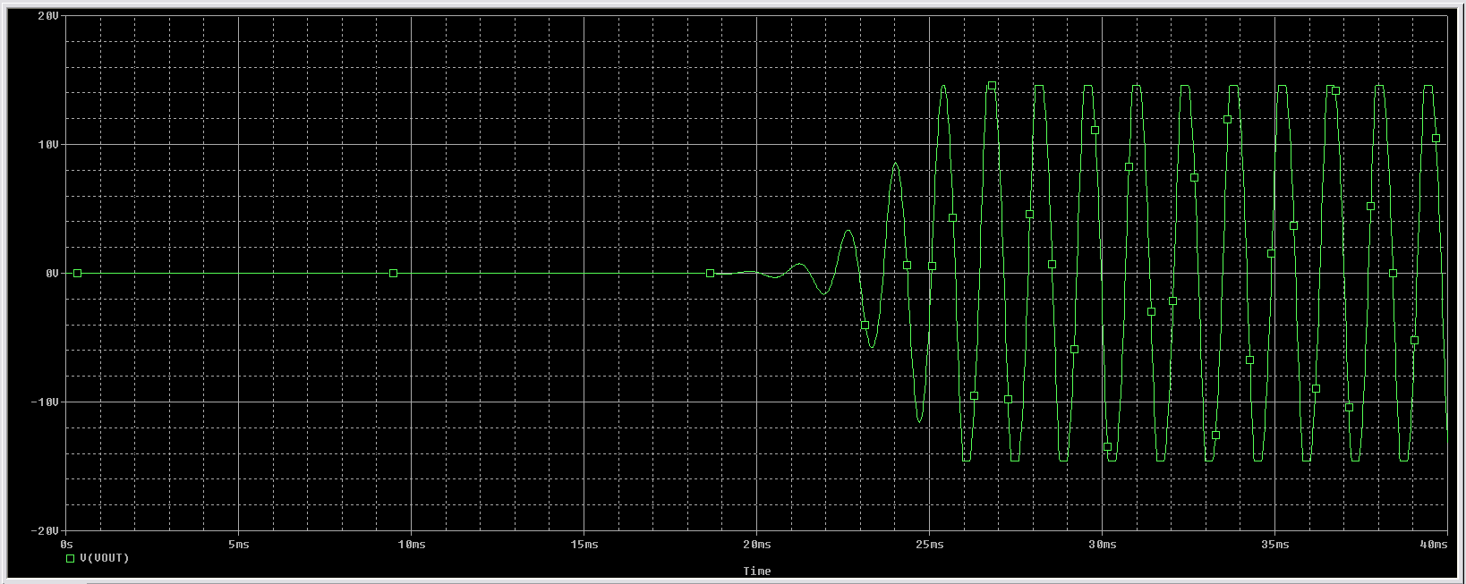

however when i conducted simulation tests ...
R3=10k R4=20k R6=5k
gives me a sine wave with an amplitude of +/- 15V (My Vcc and -Vcc are +-15V) and the edges of the sine wave are clipped (but not as distorted as when no diodes are used)
(Attached as clipped.png)

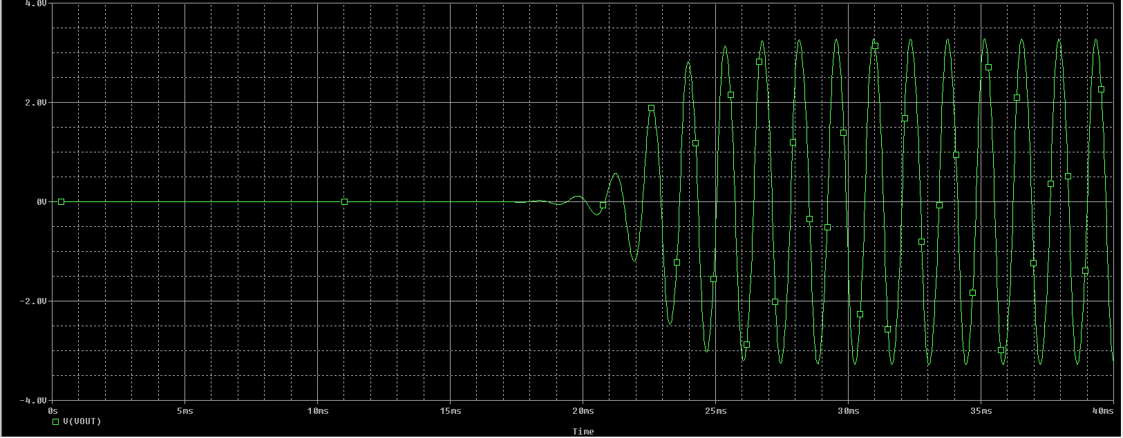

but when
R3=10k R4=15k and R6=10k
i get a sine wave of reduced amplitude at +- 3.3V ..however the edges of the sine wave are NOT clipped.
(attached as unclipped.png)
ive got a feeling that the first configuration R3=10k R4=20k R6=5k is the correct way but would like to understand why the voltage amplitude is reduced so low when the 2nd configuration of R3=10k R4=15k and R6=10k is used.

The gain is always 3. It takes a little time for the oscillations to build up to the clipping value, but it takes a gain of 3 or more to even get the oscillations started. The reason your circuit worked with R3 = 10k, R4= 15K and R6=5K is because the gain equation for your circuit is:
1 + (R4 + R6/R3); = 3. Remember as oscillator is an infinite gain amplifier ( remember how the denominator of the loop gain disappeared; meaning infinite gain ) So, something has to intervene to reduce the gain or else the signal will continue growing and growing and growing...
In this case, when the signal reaches a cetain value, the diodes short out R6, and now the gain is:
1 + (15K + 0/10K) = 2.5. that will stop the signal from growing. In that way, the tops of the signal aren't clipped by hitting the power rail.

The purpose of the amp stabilisation is to keep the gain such the sinewave output is as 'pure' as possible [ look up form factor]
The sinewave will increase in amplitude as the gain increases after switch ON, then the amp stab should start to work to maintain a good sine wave.
If you have a clipped sinewave output, the gain stab components need adjustment in order to bring the gain down by a small amount.:)

You don't want rail-to-rail oscillations. You're getting a good sine wave because you're intentionally not going to the rail.
