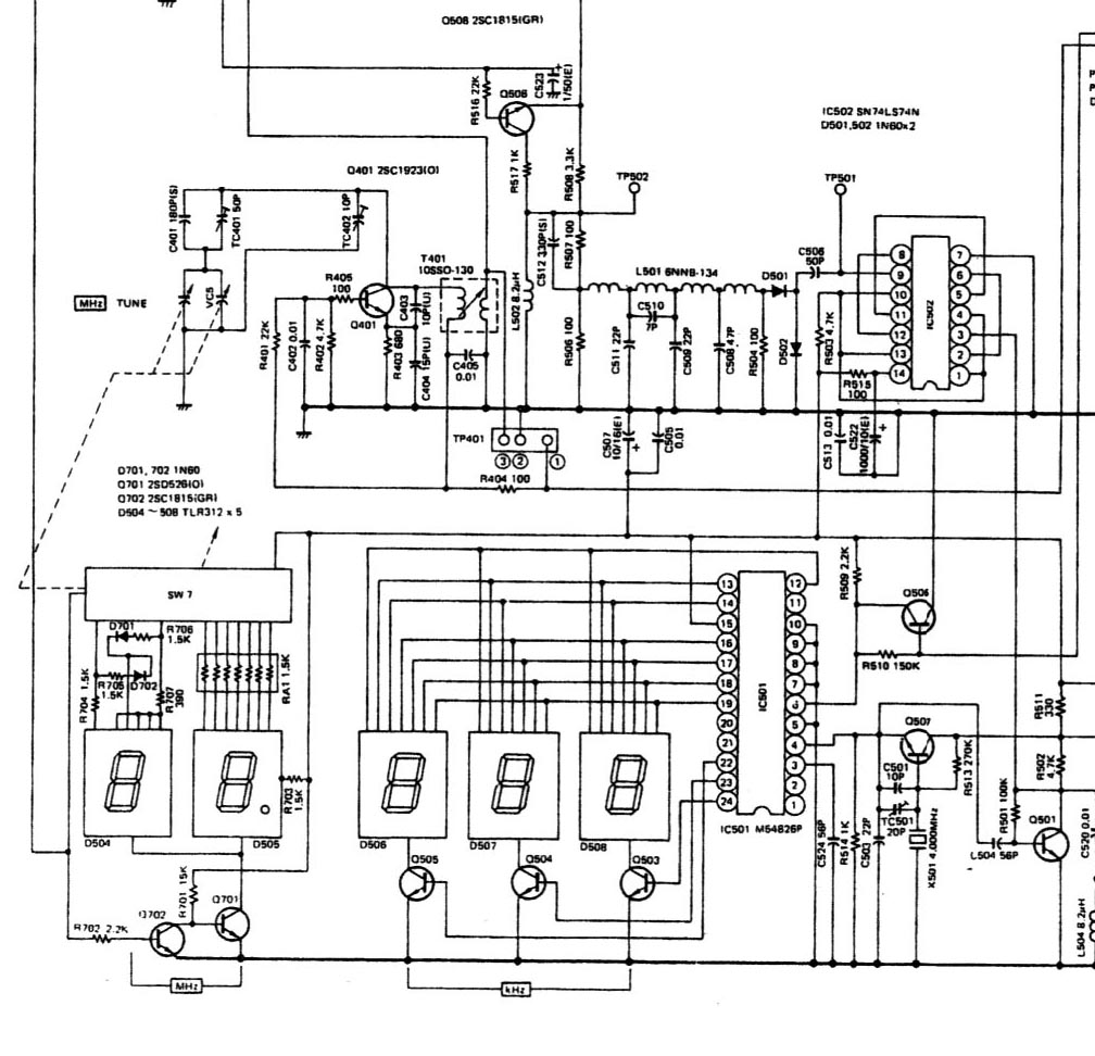

I'm a newbie to this forum trying to get some expertise on a problem I have repairing a Realistic DX-302 short wave radio. This radio was (still is) a nightmare. Some of the parts were replaced with non-replacement parts and some "new" parts were added which are not part of the schematic. Anyway most of the radio is now working except that the MHz tuning is not tracking properly. The service manual says that the MHz oscillator should be 55.5 MHz when the dial says "0", 56.5 for "1", 57.5 for "2" ... 83.5 MHz for "28" and 84.5 for "29". So this gives a total of 30 freqs for 30 numbers; so far so good. On this radio the "0" indicator (for 0 to 999 Khz) tunes perfectly at 53.5. I cannot get it to tune or track per the service manual. I can tune the oscillator for the correct frequency but then it doesn't receive any stations. If I tune for a station then it's good for only that MHz and doesn't track so WWV will be on 7.000 Mhz instead of 5.000 Mhz and some of the bands are dead because the mute cutes in between bands where the signal should be. It's a complicated problem because the MHz readout is actually a digital switch controlled by the MHz variable capacitor. My question is could someone take a look at the schematic and see what components are critical with the oscillator circuit that might make it tune off the desired freqs? Q401 is the 1st oscillator on the schematic. Thanks in advance! :(
Do you have a suitable frequency counter to measure the oscillator frequency?, otherwise getting the tracking right will be a hard job.
While doing a quick internet search for a picture of a DX302, I came across this:
One of the hints suggests removing R227 which will stop the mute from operating between Mhz steps, thus helping in situations like yours where the tracking is all over the place.
C403, C404 and T401 are the basic frequency determining components of the Mhz oscillator. T401 should be adjusted at the low frequency end of the tuning range (55.5Mhz)
VC5 is the Mhz tune capacitor (obviously).
TC402 is the trimmer capacitor which should be adjusted at the high frequency end of the tuning range (84.5Mhz).
C401 and TC402 are the padder capacitors, these set the range of the tuning capacitor, and should be adjusted so that rotating the tuning capacitor from 0 to 29.5 on the frequency display gives a change of 29.5 Mhz in the oscillator frequency.
I think that is all that I can tell you for now, good luck in getting is set up correctly.

I did a lot of checking of the MHz oscillator and noticed that I could never reach 84.5 MHz (29 MHz on the readout) and then I noticed that TC401 was totally open so I need a little less capacitance. C401 is in parallel with TC401 and checking C401 I notced that it was actually 2 caps in parallel - a 150 pF + 30 pF which would of course give 180 pF but since I needed less capacitance I removed the 30 pF and now I can get to 84.5 and tracking is fairly good with the IF's peaking fairly close to each MHz readout.
Now the really big problem :eek: - With the MHz up to specs with the service manual it will not pick up as indicated. The indicated MHz reading is shifted up by 3 MHz. So if I want to pick up WWV on 5 MHz I have to tune to 7 MHz and so on and so fourth which means I cannot receive anything below 3 MHz (0.000 MHz indicated). This is really wierd and I really don't have a clue how this is happening.

I assume that this is measured with a frequency counter at TP401?
In the manual which I managed to find on the net, it mentions to use a buffer amplifier between the counter and TP401, are you using a buffer?
If not, the lead from the counter could be loading the oscillator. So when you adjust the oscillator and then disconnect the counter, the oscillator runs at a higher frequency than you expect. Which ties in with your next statement:

Having given this some thought, are you sure that you are getting 52.5Mhz?
The inputs to IC201 are the Mhz oscillator and a "comb" of 1Mhz signals, L212 to L219 must be tuned so that only the 52.5 Mhz output of the IC201 mixer is amplified, I suspect that there is a significant 55.5Mhz content, giving the 3 Mhz shift in the tuning.

It is not so much that the coil is designed for 52.5 Mhz, it is just that it has an adjustable core and its inductance can be varied over quite a large range, maybe a ratio of 1.5:1 or more. So, adusting from 52.5 to 49.5 Mhz would be no problem.
To adjust the 2nd local oscillator amplifier, the handbook suggests using a sweep generator which I assume you do not have.
The tuning of this amplifier is critical to the correct operation of the Wadley Loop.
My best suggestion is that you obtain a signal source which can be set to 52.5 Mhz and injected into the amplifier as a test signal while you tune the inductors.
