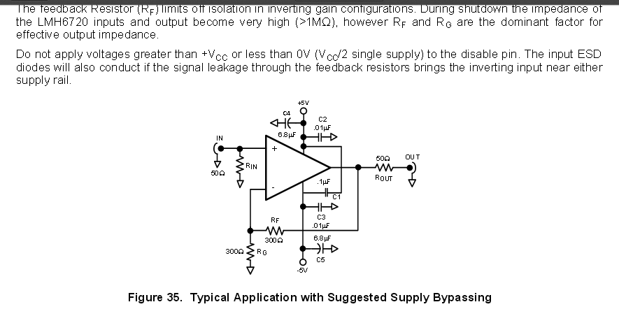

I would use a current feed back amp like the LMH6720. It is not like a voltage feed back "op-amp".
OR

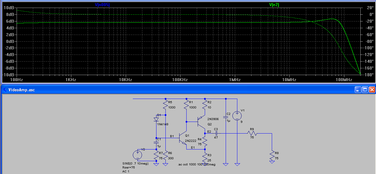

Here is a two transistor amp, using general purpose transistors. Good for 100mhz.
  • VideoAmp.asc
The 50 ohm resistors need to be 75 ohms.
Rf needs to be slightly larger than 300 ohms to get gain above one.
