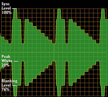

TV video was transmitted with AM modulation. Sync was (blacker than black) full power, black and blanking were a little less at 76% power and white was 20% power.
White cannot be zero power because then the audio would stop whenever the video had white.
Black was always on every front and back porch so black had a good reference voltage and the contrast control adjusted the brightness of whites. The brightness control adjusted how much light there was in blacks (grey?).

I'll backpedal. Turns out that for NTSC negative video, "peak white" is at the 12.5% level, not 0% as I stated earlier. See link:
https://www.broadcaststore.com/pdf/model/793698/TT148 - 4053.pdf
However, whether white is 0% or 12.5%, it really changes nothing as far as being able to restore proper contrast and black level from an attenuated signal. We know that black is 0.75 volts on a standard 1 Vp-p signal and white is at 0.125 volts. If the signal has been attenuated and we read black to be 0.6 volts, then we know that the signal has been attenuated to 80% (0.6/0.75) of its nominal value, and we know that white is now 0.8*0.125 = 0.1 volt. Hence, it's always possible to restore both the original black level and original contrast. And, this has been standard procedure for broadcast television since its inception.
