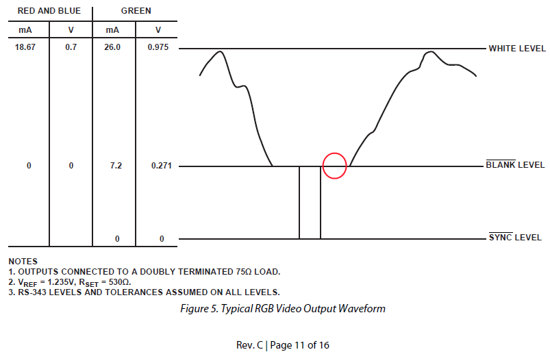

Here is a video DAC that I have used. ADV7125 I used this IC to make video boards.
Page 16 shows voltage on the R, G and B outputs.
Note R and B out put o to 0.7 volts (black to white). Green has sync from 0 to 0.271 and video from 0.271 to 0.975 volts.
The red circle I added is where and when black level is set. It does not matter if sync is there or not. This is black.
Some of the people have talked about video (in TV sets). This is video in a computer monitor.
Note white is high and black is low.
The DC level has no meaning, because the back porch is reset to "black".

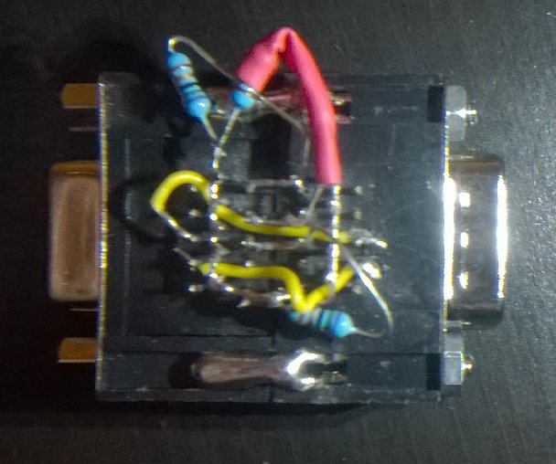

Hi
using 75ohm resistors between rgb pins and ground the outcome was a dimmer display...
also i've noticed that without both hsync and vsync connected the monitor is not turning on..
which probably means that sync can't be taken from green or any other rgb pin.
so what should i try now?...
here's a photo... (i'm sure you'll disapprove it, but since it works.. i guess it's ok for tests).

Did you try 75 ohm resistors between the sync pins and ground instead of on the RGB pins?
I was hinting that you should try putting 75 ohm resistors between the sync pins and ground to see what happens. But disconnect the ones that are connected to the RGB pins.
(My original suggestion of reducing the level of the sync signals seems somehow to have been twisted around into a suggestion that the RGB signals should be reduced instead. That wasn't my intent.)
nothing... it's like if i didn't do anything.
