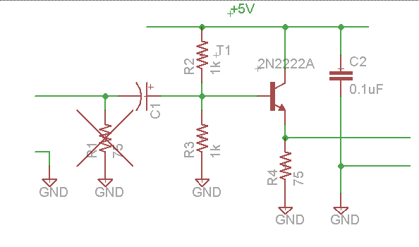

do you think I could fix the issue by using an op-amp? if yes..do I need a high speed low noise one? and how could I implement it so I can have exactly the same amplification so I don't mess the color balance?
thanks.
Interesting. It should work with out the amplifier. ????
VGA can have very fast video. (DVD suggests the video rate could be 100mhz at high resolution)
This will take a fast amplifier. The gain should not be above 1.5x. The amplifier needs 75 ohm input and output impedance.
BUT
I don't have time to design this but here is a start. Needs +5 volts to run the amp. It should have the 75 ohms input but if you leave it out the signal from the computer will be higher by 2x. If that is too much gain then use 100 or 200 ohms to set the "gain".
Because the the transistor is running with a gain of 1 a slow transistor will work.
The input impedance is wrong so put this at the computer end. (so there is no or very little coax involved)
Adjust R1 for gain of 1 through 2x.

Yes you need a amp for red, green and blue. (3)
General purpose op-amps are good for 1mhz at a gain of 1 or 500khz with a gain of 2. You need 100mhz or more. That is why I chose a single transistor that will work to 200mhz with a gain of 1. Then used a impedance mismatch to get a 2x boost. I am trying to make it simple.

so is your diagram complete? or it needs something more before i try it? (rgb levels i guess they must be amplified equally...is it something i need to pay special attention before building it? maybe the exact hfe of the transistors??)

probably i'll try first the way with the transistors...
