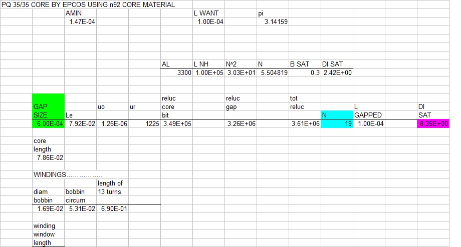

INDUCTOR:
To get the inductor smaller, use a Epcos PQ3535 core (N92 material) and put in a 0.6mm gap, and have 19 turns of 1mm wire. That will give you 100uH , start of saturation is 8.35amps.
epcos pq3535 core:
https://www.epcos.com/inf/80/ds/b65881a.pdf

We've found an 100uH, 8 AMP inductor off the shelf for Gregory, a bourns one...so he doesn't have to make that.
So this is the spec for Gregory
Vin = 37v
vout = 32v
iout(max) = 6A.
OFF TIME = 3.6us (RT = 68K)
Inductor = 100uH
...this off time gives an f(sw) of 32khz.

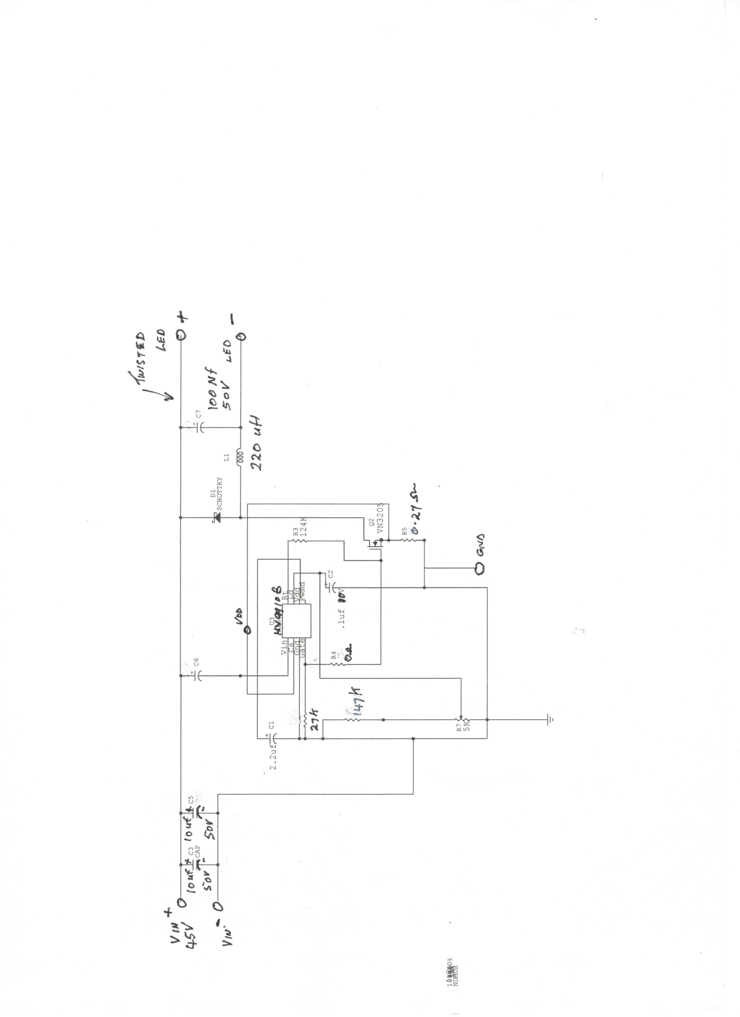

I have tried to use the cad system but have failed. I will post the circuit I drew with values and Ic drawn in by pen. Could somewon help me out with a cad circuit and board layout . I am not shore weather I have the circuit correct . Please change
Thank you

I apologise but I did not post the circuit but will now.

looking at your schem of hv9910b you have a cap from vin to input_positive, and that is not good.

Here is the schematic...attached
Also attached is a simulation of how the HV9910B led driver will work, in LTspice, a free download from linear.com
