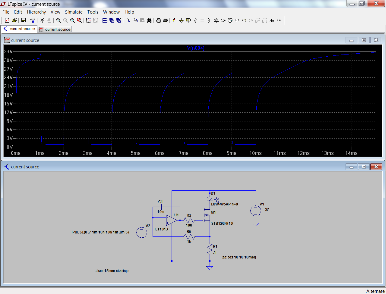

Since you have an infinite heat sink (the ocean) something like this might work. The FET and sense resistor would need to be mounted to the case, but the circuit is easy.

Regarding the ccled circuit above, with vin=42v,and iled=7A, and Vled=30v, As you know we see 75W dissipation in the fet and 5w dissipation in the sense resistor. (as shown in the below schematic). I appreciate that you already know this, and that we must present Greg this circuit in case Greg does not want to lay out a pcb......though that is a fair bit of power there....We possibly hope nobody accidentally switches it on when its on dry land.
Having said that, at vled=30v, and iled = 7A, there is 210W dissipation from the LEDs alone, so I suppose an extra 75W is not so bad.
You have to suspect that at these dissipations of the led bank, non sharing of current will creep in and the leds will go bang

Have a quick look at the latest circuit I posted above. It doesn't have that drop out problem.

The battery voltage will quickly drop from 42 to 37 so in the long run not so bad.

I suspect that firstly Gregory should use one of your linear circuits and just check that that led load doesn't actually blow up when its carrying 7A due to non current sharing between the paralleled led strings.

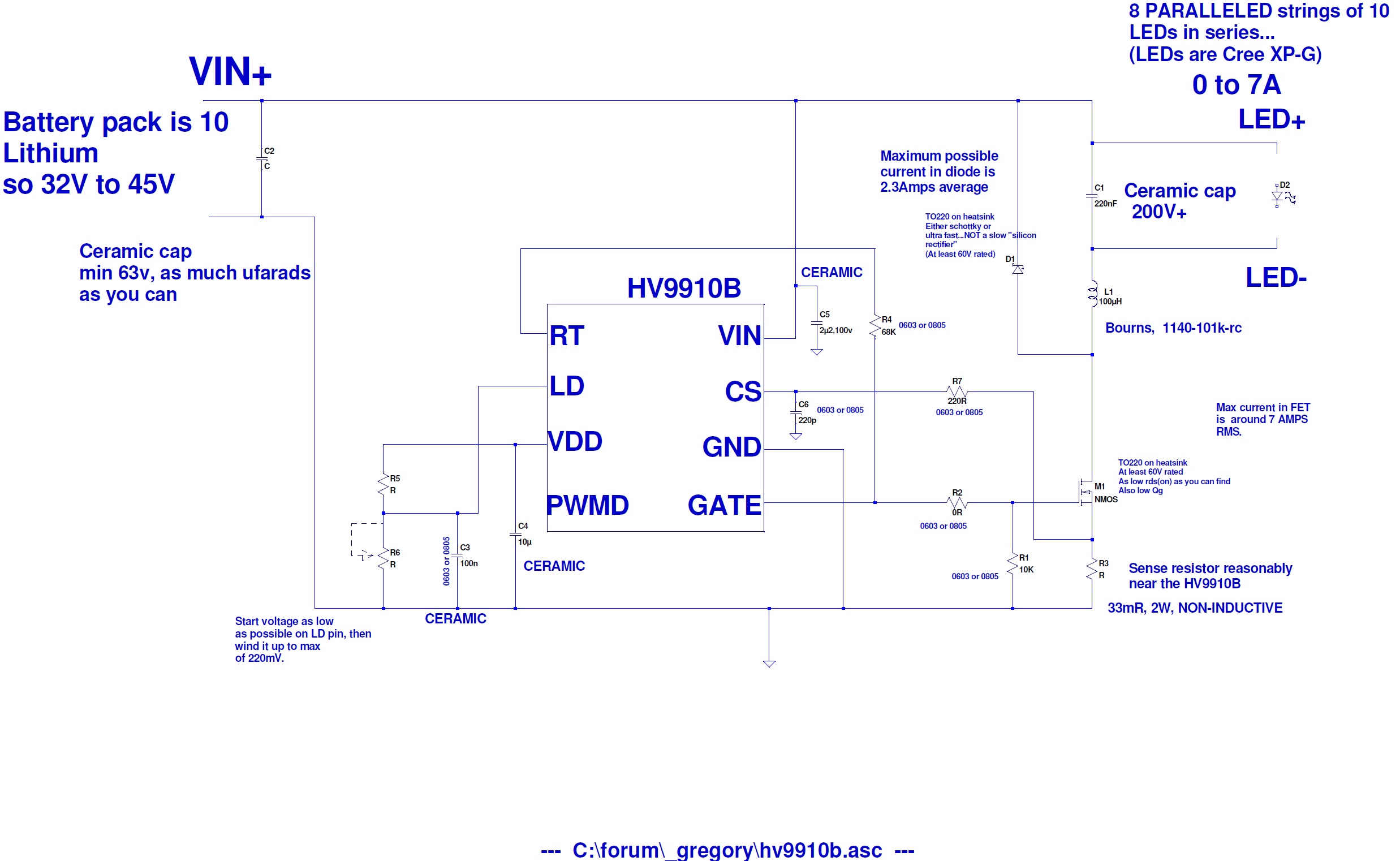

FLYBACK could you post the buck lead driver in jpg or PDF as I can not open the file asc. Post 94

just got to this thread, it has for some reason stopped auto telling me that this post (or any other) has new replies....ill post you the schem.
-gmail has started putting "watched threads" in the spam folder of gmail, I need to work out how to correct that...ok sorted now, just click "not spam"
