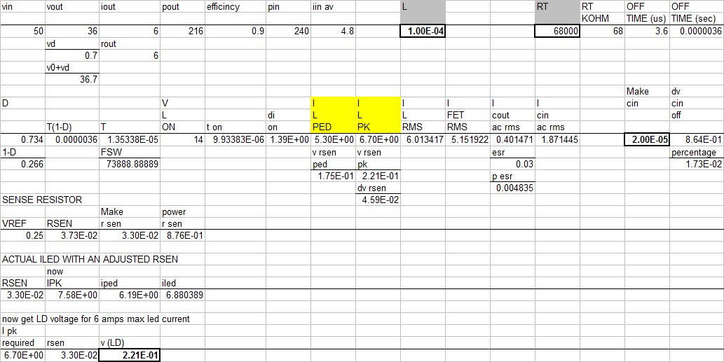

I have attached a excel sheet for the constant off time buck led driver using HV9910B.
This is for Vin = 50V and assumed vout max = 36v and iout max = 6 amps
(just give us a shout if your vin etc is different as its just a case of throwing the numbers in)
The components come out as follows....
Inductor = 100uH (ferrite core).....must not saturate with 8 amps, will have 6 amps rms current in it.
Off time resistor = 68k
(this gives fswitch = 73khz at 6 amps output)
I got you a sense resistor of 33 milliohms......this is the nearest E24 value to the required.
It needs to be at least 2 watts rated, and non inductive as possible.
Ensure to kelvin connect it back to the hv9910b
I would use about 330nF (no more than that) at the output. 1210 size up and at least 50V rated. This way you can get away without the overvoltage protection.
Put a about 100k resistor across this cap to discharge it when you turn off.
Make sure the cap is near the power diode, rather than near the load connector.
Try and keep to power diode, fet and inductor and hv9910b fairly close.
I think you will need a PCB .
You could use the free eagle package.
Your diode will carry 1.6 amps average and needs to be at least 70v rated.
Make it a schottky diode, to220 + heatsink
Make the mosfet at least 70v rated and to220. (try to get something with low rds(on) and low Qg)
Put a about 47k resistor from gate to source of the fet
Use at least 20uF at the input. (make sure these are close to the fet)
The input capacitance must be good for at least 2 amps of ripple current at 73KHz.
Eagle pcb is very easy to learn there are lots of tutorials on youtube etc. Including tangentsoft.net does a good eagle tutorial.
Start the layout be getting the hv9910b and the sense resistor as close as possible....and the RT resistor should also be near the hv9910b....as well as the cap on the hv9910b vcc pin.
The pot on the LD pin will have to set LD to 0.221v for iled = 6 amps...this has to be so becususe you wont find a 37 milliohm, 2 watt sense resistor so I had to make it 33milliohm.
...just turn the pot to get lower LD pin voltages for lower led current as you choose.
You may not be able to find that size inductor off the shelf.....you could put several shielded ones in series though to get the overall value.....or make one yourself using eg epcos ETD core. Or get a winder to do it for you...eg agw.co.uk.
Having said that its actually easy to do it yourself.....just find the cores AL value from datasheet and work it from there...AL = {L(nanohenry)}/N^2.
N = your number of turns. (MUST BE enamelled copper wire)
Remember you have 6 amps of rms inductor current.
