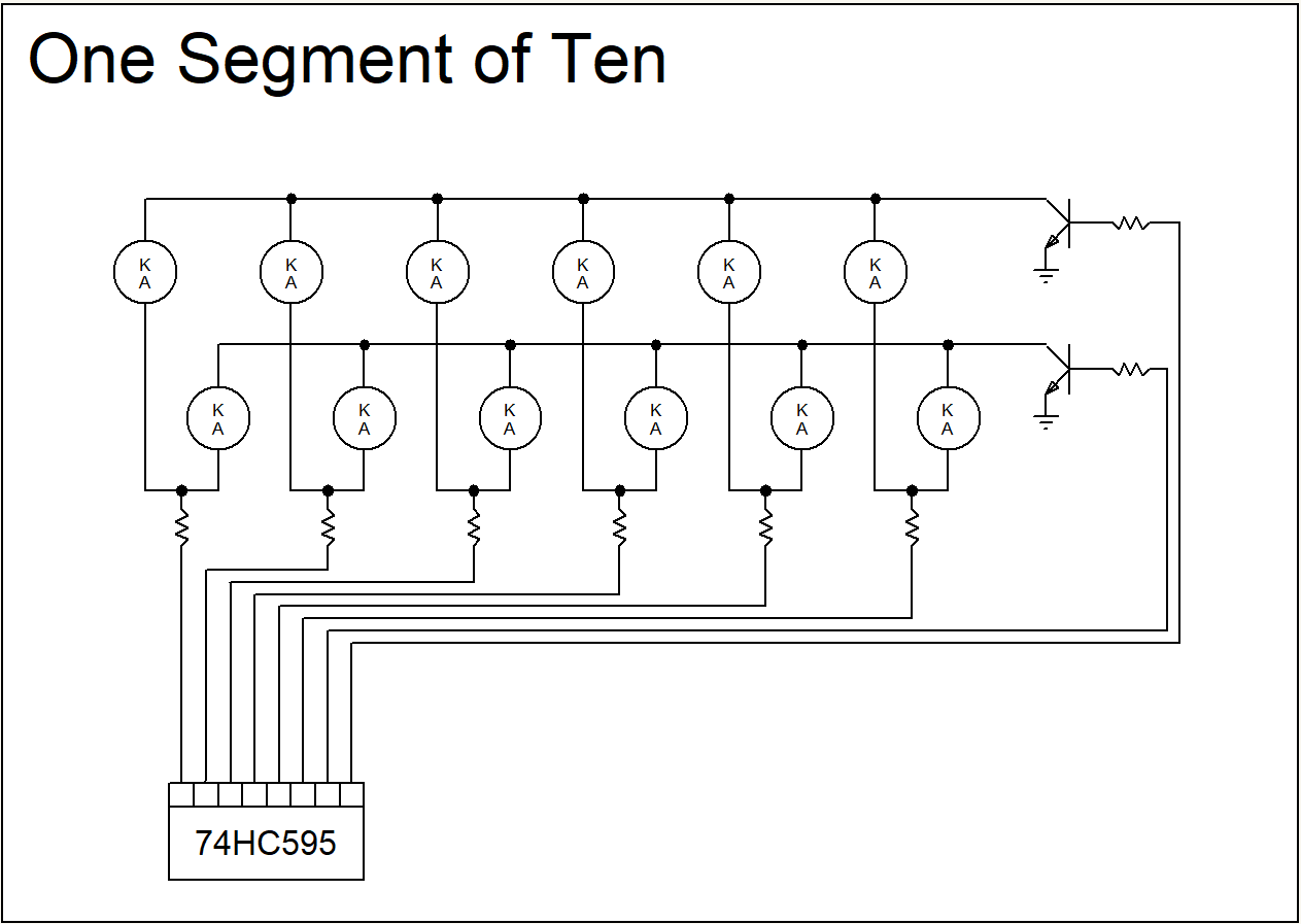

I am using 10 PCB segments ... each Segment has 12 LEDs. 6 for minutes and 6 for hours...

schematic shows 2 - 18F processors as I want to check today on my supply of 18f2221 chips (have lots of 18f43k22).
Don't need 44 pins

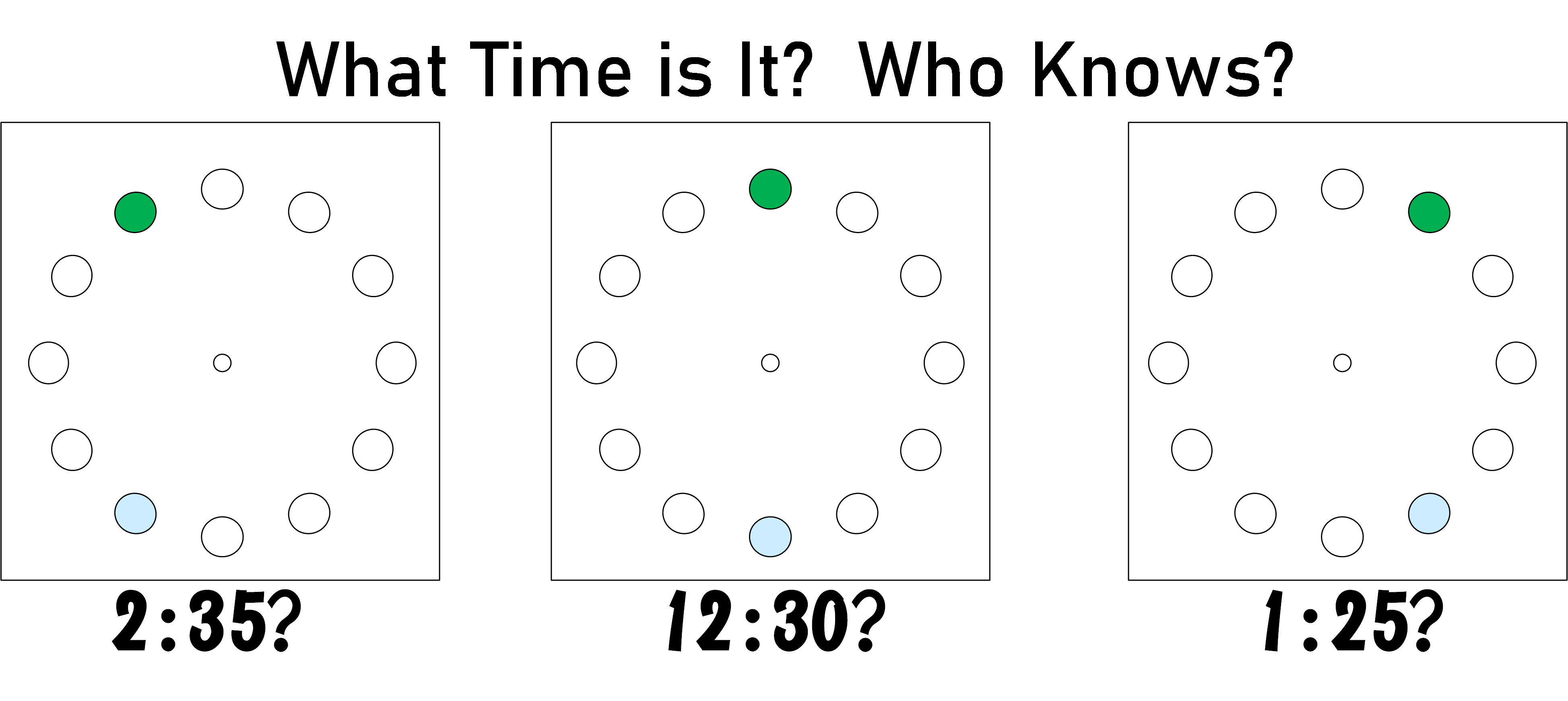

I'm afraid all all these pages and pages and pages and pages of comments, you still DO NOT understand the concept. Somewhere back in this waste of bits, I pointed out that two single illuminated LEDs do not result in a readable clock display. Imagine a single green LED and a single blue LED illuminated in a dark room, with the green LED directly above the blue LED. 12:30? 1:25? 2:20? 11:35? 10:40? If two glowing dots are all yoi can see in the dark, you can't tell the difference.
I also explained back in this swamp land that having only 12 LEDs for hours makes for an extremely confusing display. If the "12" LED and the "55" LED are illuminated, what time is it?

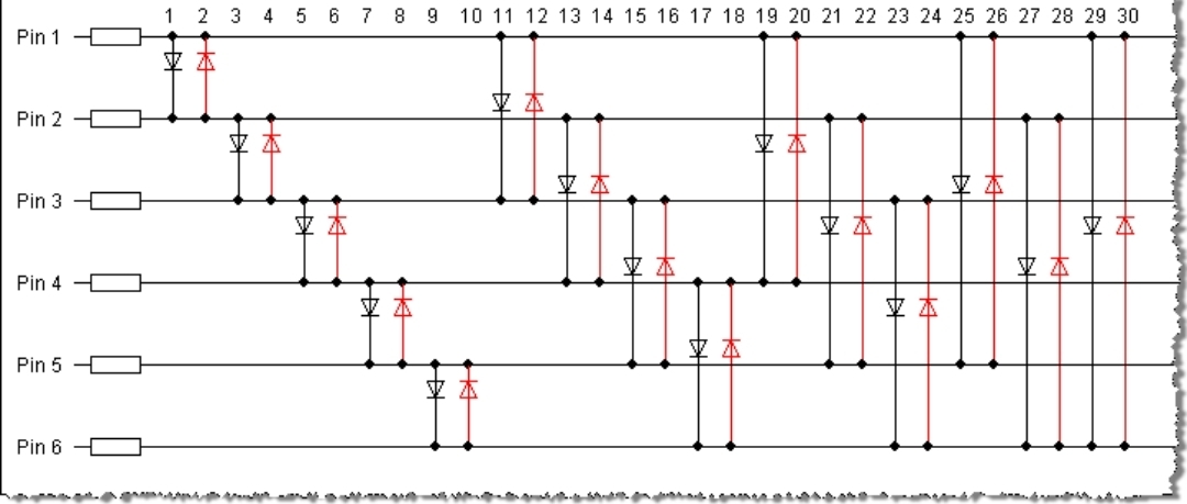

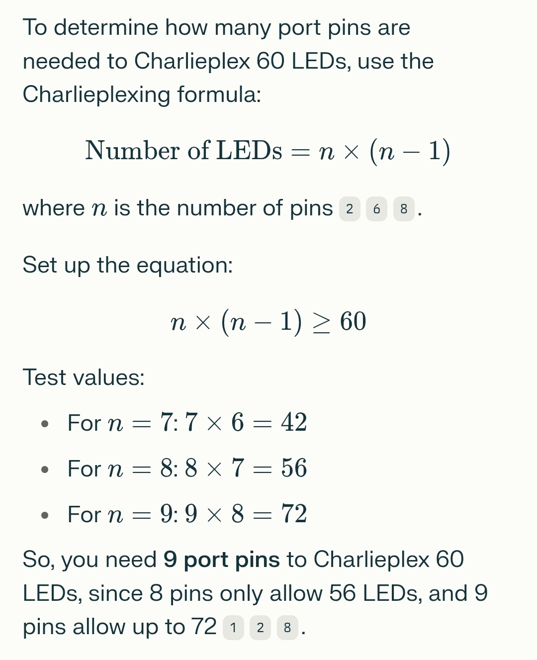

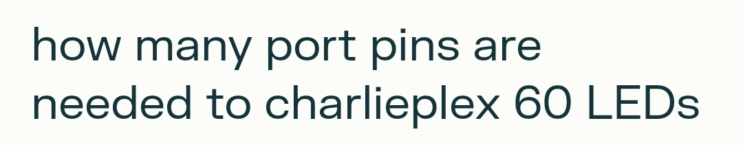

I asked Perplexity AI about Charlieplexing to illuminate 60 LEDs on your behalf, since I'm certain you're going to ignore everything I said in my last post.
To light up one fricken' LED out of 60, you need nine port pins. Stop torturing the shift registers forcing them to limp along doing virtually nothing and save yourself a bunch of hardware.
Please note – I am not recommending this technique to create something awesome – I'm suggesting it to make the lame clock you have in your head – see my previous post to understand lame.
Perplexity AI says the following:

Since MrDEB is rather immune to advice, suggestions, criticisms, etc,., I'll make one final attempt to illustrate again.
I pointed out that two single illuminated LEDs do not result in a readable clock display. Imagine a single green LED and a single blue LED illuminated in a dark room, with the green LED directly above the blue LED..... If two glowing dots are all you can see in the dark, you can't tell the difference.
I did mention way, way back in post #221 that using 12 LEDs for hours and only ever having 2 LEDs illuminated will result in an indecipherable clock. 156 posts ago.

Aha I now get your point on only two LEDs.
Reading over post #221 and #222 I am a little confused about 2- hour LEDs and 12 LEDs for each minute?
