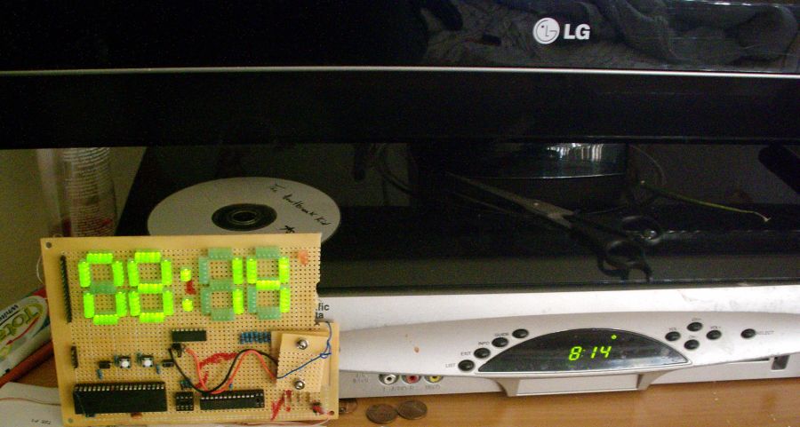

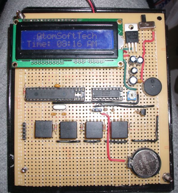

i just started on the GLCD clock again. I thought since i had gained so much knowledge ill finish my first clock then continue. The pics below are all the clocks i have made and the last would be GLCD one but im still developing the menu for setting the time/date/alarm.
The first one is the best TIME shower. I can see the time across the room at night when im sleepy and it doesn't disturb the eyes. The middle is my desk clock for now until the glcd is done.

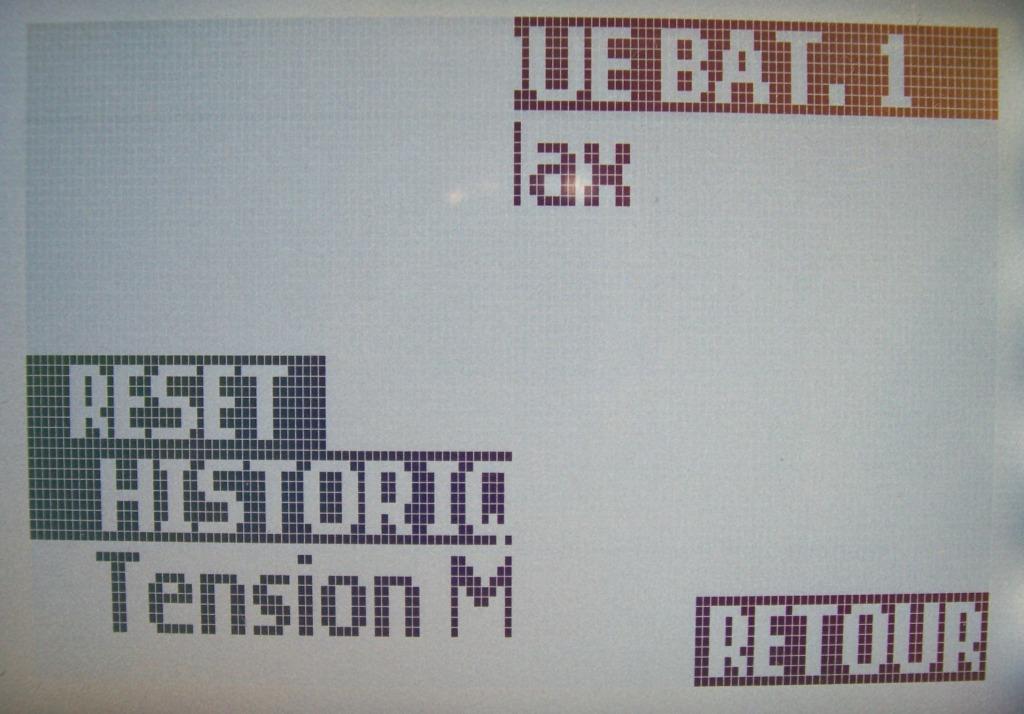

I have a display problem but not always present.At the launch of my program, the display is correct, and from a time, the display starts to be weird, cutting off the display ( see picture), point cloud ..
Have you any idea?
Thank you in advance
I don't know the technical explanation for that, but it can happen if you try to write a pixel at a location greater than y = 64 or x = 128. Hope that helps.
You're right, it then yest sometimes greater than 64 and x greater than 128.
But how can I solve my problem? Is there a solution?
