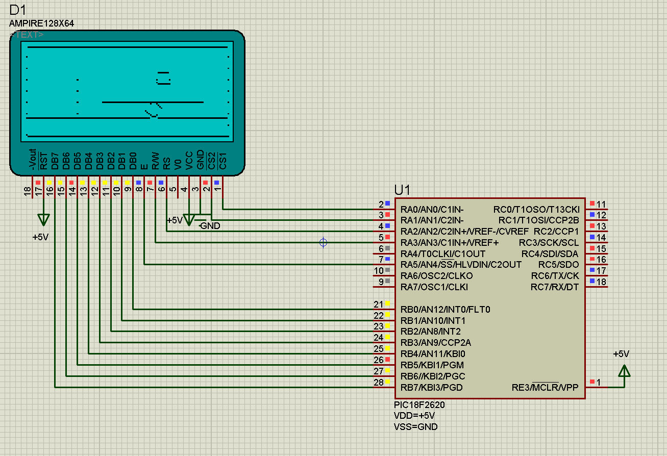

Hello
Can someone b kind to try my test code attached below,
i'm getting crazy to get geometrical and picture displaying functions working well...
The code compile without any error but when i run it, i only get text displayed properly.
Hlines, Vlines, logo, plot , rectangles get bad results. ( missing and moving pixels )
My code is set for 18F2620 ( 10 Mhz crystal ).
My GLCD CS pins are complemented.
Proteus simulator gives me exactly same results as hardware does.
See the capture result attached below.
Many thanks for your help, i'm stuck !:eek:

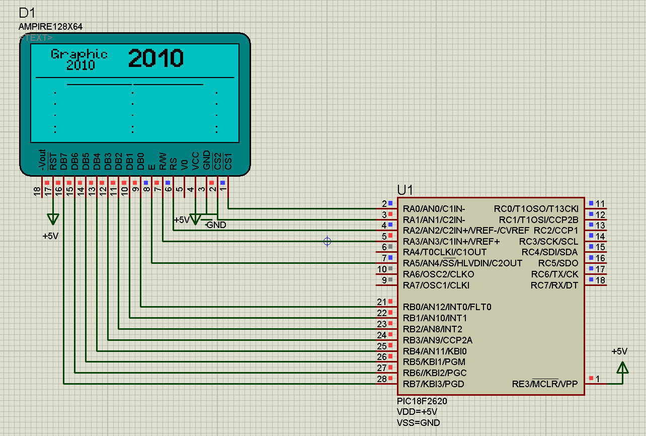

However, vertical lines problem remains ...
By the way, i tried to port Pommie's original code in order to use it with my Pic 18F2620 : compilation completes without error but simulation and hardware test get a blank display ( nothing displayed ) when running the program...
I also attach Pommie's code ported for 18F2620.zip

I've now looked through your code and can't see any reason that it doesn't work.
What happens if you just plot one pixel in the middle of the screen?
BTW, I can't try your code as I recently moved and the GLCD is still in a box somewhere. Should be unpacked by weekend.
edit, just noticed,
// A/D PORT Configuration
    ADCON1 = 0x00;			// all digital
    INTCON2bits.RBPU = 1;  // Disable internal PORTB pull-ups
This sets it to all analogue. ADCON1 should be 0x0f for all digital. Good news, this would explain your result.
If i use my partial working code ( my code for 18F2620.zip )and try to lit 1 or many pixel with plot function it works fine.
hline is working well too.
However, in any cases i found that Isis simulator gets Warnings while program runs :
it reports logic contention for D0 to D7 pins. ( showing yellow flashes near pins names )
Regarding vline : it looks it display every pixel very very slowly one by one.
Maybe some more delays are required somewhere ?

Your latest code still shows it as zero!!
void main(void)
 [COLOR="red"]ADCON1 = 0x00[/COLOR];			// all digital
If this is how your code is, then it will cause this problem as analogue pins always read back as zero.
