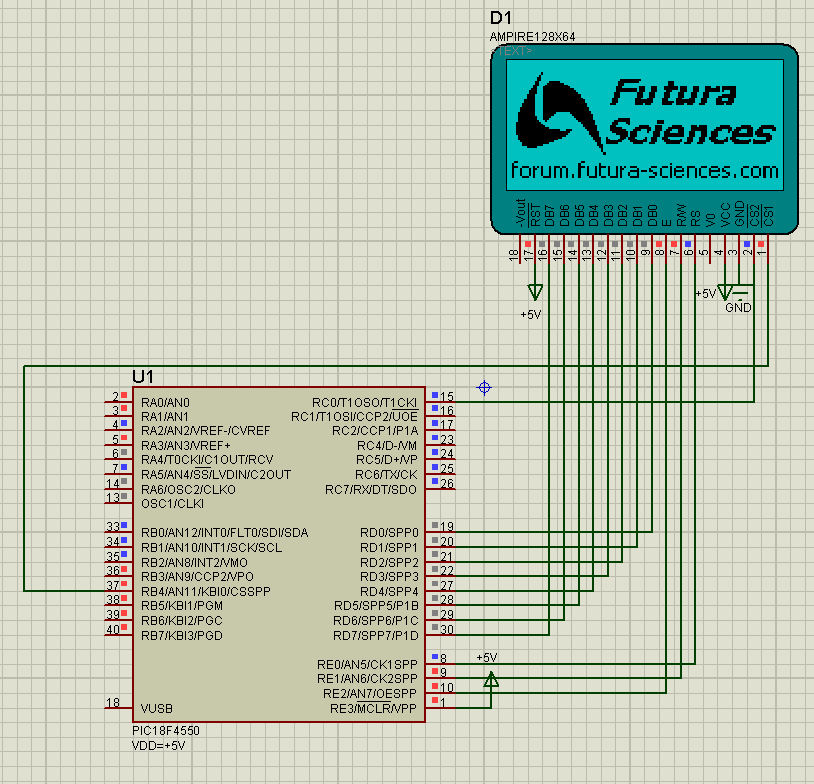

Unicorn GLCD demo.

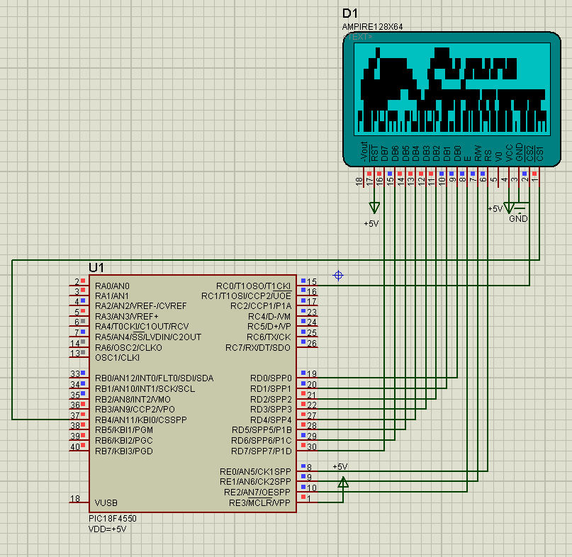

Here are screen captures of Pommie's 18F4550 code result when passing "ww" has rom char , and when setting ww as a regular unsigned char :
unsigned char XPos,YPos, ww;
( i of course get the same results if i use 18F2620 )

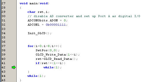

If i understand well, you suggest me to have this in main.c and then run the program in Debug mode in order to read ret variable from Watch windows ?
void main(void)
	char ret,i;
	// disable AD converter and set up Port A as digital I/O
	ADCON0bits.ADON = 0;
	ADCON1 = 0b00001111;
	Init_GLCD();
    for(i=0;i<8;i++){
        SetPos(0,0);
        GLCD_Write_Data(1<<i);
        ret=GLCD_Read_Data();
        if(ret!=(1<<i))
            while(1);
    while(1);
Then i run that code ( Release mode in MPLAB ) from hardware and also Prteus simulator, nothing is been displayed on the GLCD .
I"m testing hardware with a lab board, if you want me to test in Debug mode i will have to wire PGC and PGD and MCLR pins ?
When running the code in Debug mode and then stop it, MPLAB points while(1) line
( see screen capture )
then Watch window reports that "ret" value is 0xFF
Still nothing displayed on the GLCD.
What do you think about that ?

That code sets the GLCD with data then reads the data back. Its never supposed to hit the while if the data is reading correctly. Maybe a hardware issue..(meaning wiring or actual GLCD)
You could simply:
GLCD_Write_Data(0x0D);
if(ret!=0x0D)
    //ERROR: INPUT DOESNT MATCH OUTPUT
else
    //Data OK!
Since it stopped there what is the value of RET?
Yes indeed, when running and stoping it points here : // ERROR INPUT DOESNT MATCH OUTPUT
Watch windows says ret = out of scope .

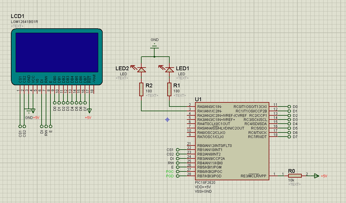

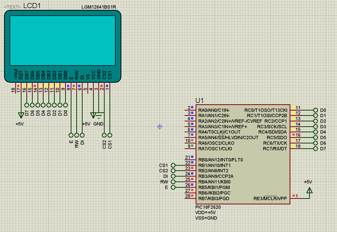

Sure, here they are :
- MPLAB project
- JPEG schematic ( for those who don't have Proteus )
- Proteus DSN file for simulation and test purposes
I added 2 leds on RA0 and RA1 for test purposes, should help ...

Something obvious but still not working for me is:
IN the glcd.h
#define GLCD_Data   		(LATC)
#define b_GLCD_GCS1 		(LATBbits.LATB1)
#define b_GLCD_GCS2 		(LATBbits.LATB2)
#define b_GLCD_RS   		(LATBbits.LATB3)
#define b_GLCD_RW   		(LATBbits.LATB4)
#define b_GLCD_E    		(LATBbits.LATB5)
#define b_GLCD_On   		(LATBbits.LATB6) 	// not available on my GLCD
#define b_GLCD_BL   		(LATBbits.LATB7)
// Define the direction for each Input/Output pin (0-Output, 1-Input) :
#define TRIS_Data    		(TRISC)
#define b_TRIS_GCS1  		(TRISBbits.TRISB1)
#define b_TRIS_GCS2  		(TRISBbits.TRISB2)
#define b_TRIS_RS    		(TRISBbits.TRISB3)
#define b_TRIS_RW    		(TRISBbits.TRISB4)
#define b_TRIS_E     		(TRISBbits.TRISB5)
#define b_TRIS_On    		(TRISBbits.TRISB6) 	// not available on my GLCD
#define b_TRIS_BL    		(TRISBbits.TRISB7)
#define LED1	    		(LATAbits.LATA0)
#define LED2	    		(LATAbits.LATA1)
You had some TRIS_Data wrong, also the LED defines where tris not lat. GLCD_Data was PORTC should be LATC
Check this out.. if you bypass the wait not busy routine with a normal delay it works fine. I never liked using it heh. Try this out. It has a DSN in it and i replaced your led with actual simulation leds. so you can see then light up heh
  • glcd.zip
Thanks, yes i found too late that my leds were not declared properly.
You are right #define TRIS_Data was not set correctly either.
This would help.
However, i think #define GLCD_Data has to be PORT not LAT because we need to read states, not latches.
Now, something is coming-in on the GLCD but i'm still not able to display a picture or vertical line, i don't know why ...
It looks that pixels in vertical lines are being lit very slowly and some of them them are missing ...
btw : would you please tell me how you inserted simulator window inside MPLAB i never saw this before, it is a very interresting feature. :)
