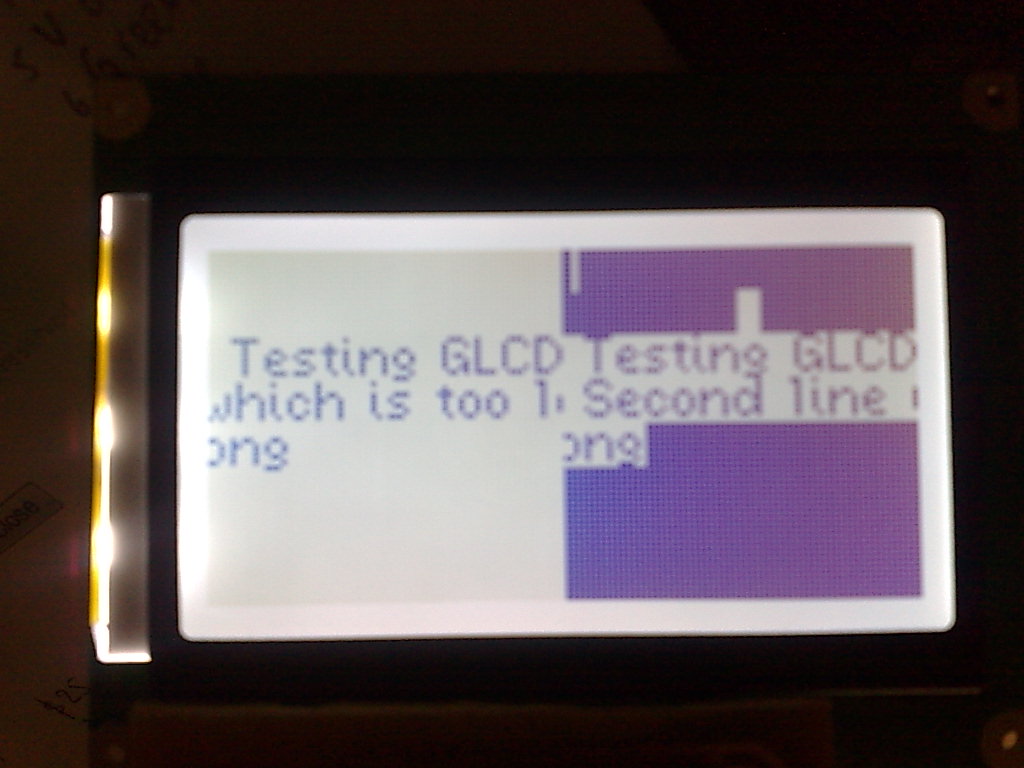

I have tried several things but my GLCD is not displaying anything. Blank screen. Its a new GLCD but i am not sure how to test if it works or not. The code works fine in proteus but not on actual hardware :(

I have attached the ports of my PICF4520 As mentioned in the above code
Now sometimes half of the GLCD lights up into a black section. Also as soon as i connect my GLCD power, the 7805 regulator starts to heat up a lot. I have an LED, controller and GLCD on the circuit, should it take a lot of AMPS? the power supply i am using serves 12 volts and 800mA
Finally the GLCD is working but not as expected. I think the data sheet i am using is not for my GLCD :(

but as soon as i connect the 15 pin CS1 the GLCD gets stuck.
Also i had to leave the pin V0 disconnected. connecting it with GND or Vcc doesn't show up any display at all.
Attached is the display i am getting.
It looks like the GLCD doesn't like where I turn on both displays at the same time, like in Cls. Are you able to split Cls code into two loops to clear the two halfs? Also try plotting pixels in each corner and see what happens.
It writes the same data in both the sections of the GLCD. I have disconnected CS1, CS2, V0, Vee, RST wires (as from datasheet but not sure if it applies to my GLCD or not) and still the GLCD is working somehow.
The only connected pins are the 8 data pins, E, R/W, RS, 5V, GND
Pommie, the Left section of screen is continuously scrolling the text by default and the right section its fixed.
Also the left section gets stable too but after like a minute .
