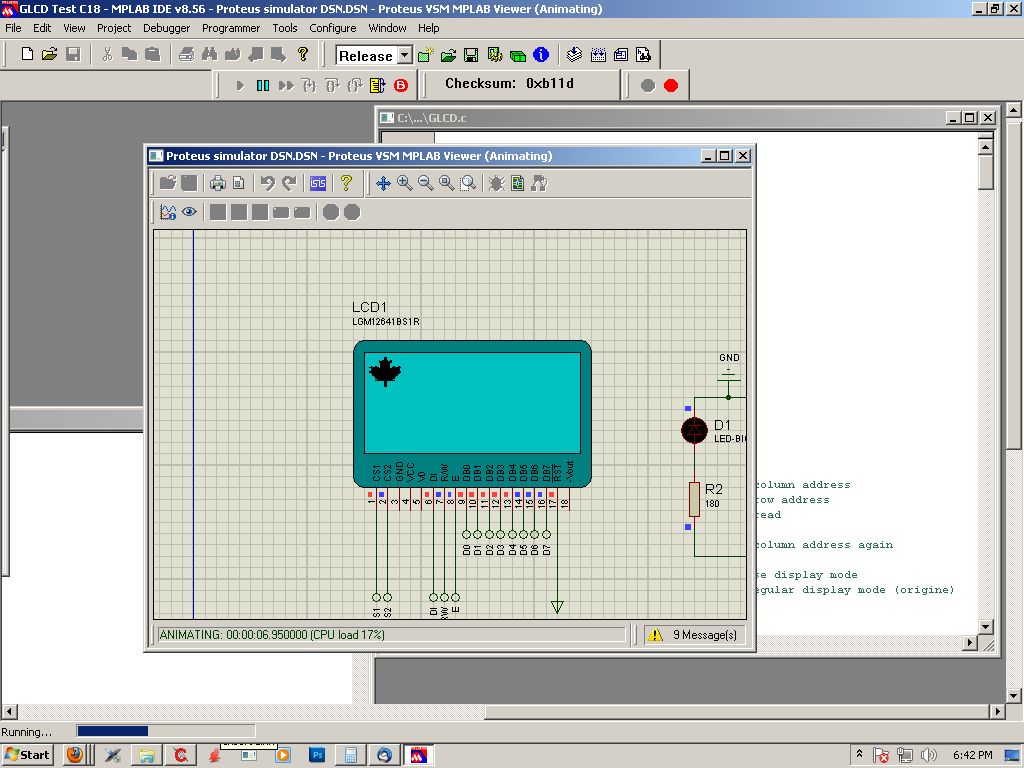

I'm now able to display a picture .
I'm not sure to be right, but i tried to change the display mode inside :
void GLCD_Write_Data
and
unsigned char GLCD_Read_Data(void)
I think ( but not sure ) GLCD display modes are as follow :
dat=GLCD_Data^0xff; // inverse display mode
dat=GLCD_Data; // regular display mode
Now i'm able to display Pommie's logo white on black
but i'm not able yet to display it black on white
vlines and hlines are still not working at all, maybe a display issue from plot function ?
Here is the modified project with these modifications.

Can you tell me what did you change in order to invert color mode ?
I can see that logo is now visible, plot function is also working.
but i can't display any text, vline or hline ...
I just noticed that Jasons code doesn't have the dummy read that is required. Could it be that the displays use a different chip set?
@crocu, if you post your working code I'll show you the best place to invert it.
Inside plot code:
//from
d=d&(0xff-(1<<(y&7)));
//to
d=d|(1<<(y&7));
Clear Screen function
//from
		for(j=0;j<0x40;j++)
			GLCD_Write_Data(0xff);
//to
		for(j=0;j<0x40;j++)
			GLCD_Write_Data(0x00);
PutChar
//from
//to
I think that was all of them heh
