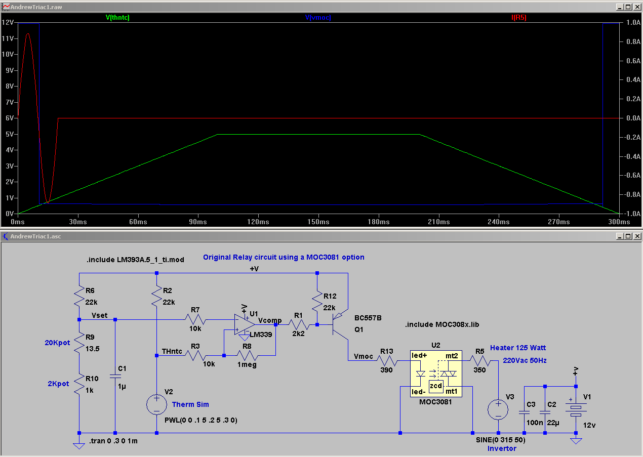

Hi Eric,
progress but can only get one cycle of current to the heater then it switches off?
Hey, this could be a bunch of fun and a great learning tool.

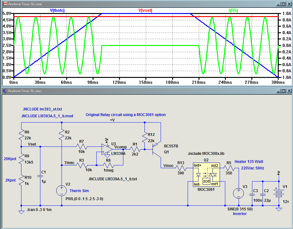

Post your version of the asc file.
I see that you are using a LM339.???
Use Tools/Control Panel and change the plot background to white so that its easier to read.
will do.
In the files I could only find the LM339.asy file , got it "working" and in my excitement forgot to go back and track down LM393A. Will go and find it, correct the background and post.

It works for me.??
