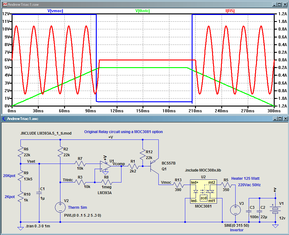

The PWM approach, without some form of zero crossing detection sync, would mean that the triac will be firing at any point on the sine wave cycle.
This could be a problem for the 12Vdc to 220Vac invertor.???
You can still get proportional control of the heating element by using a ZCD triac module.
This means the triac would always trigger at zero crossing.
By applying the triac control voltage over complete 'full' cycle in an On/Off way using a comparator controlled mark/space ratio the amount of heat could be controlled.
Look at the MOC3081 and the higher current Sharp S102S02 ZCD triacs.
Hi Eric,
So we still get to use the comparitor but instead of the LM393A driving the transistor and in turn the Relay we now effectively insert the MOC3081 and the S102S02 ZCD triacs in place of the tranny and relay? The reason for zero crossing is to avoid nasty transient voltages?
It is so frustrating not understanding electronics, I run a business with three factories, on different sites, emplying 240 people and I swear that is 100X easier than trying to understand electronics:o. My aptitude is mechanical.
If my assumption above is correct then will have a go at the new schematic.

hi Andrew,
Look at this intermediate circuit step, from Relay to Triac [ZCD, same operation as the present circuit], when using 'ac' for the heater no more irritating clicks.:)
The MOC can switch max 1Amp at 220Vac 50Hz, if you need more umph the Sharp S102S02 can switch 6Amps.
If you want the ltspice.asc files for the project, just ask.
BTW: if you get into LTS, join the Yahoo spice group for support.

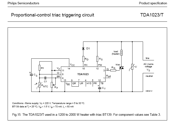

Hi
I am not ignoring your recommendations but you will understand I have to find existing circuits to modify due to my skill level, could find no complete circuits using the MOC3081. In my hunt I have located one that hopefull could do what I want, it is also a Proportional Control Triac Triggering Circuit that appears to be Zero Crossing. https://www.electro-tech-online.com/custompdfs/2009/10/TDA1023_T_CNV_2.pdf This is more for me as hopefully I can calculate the values based on the data sheet and don't have to design ..... that is of course assuming the circuit is appropriate.
They quote 5 to 30°C control range, surely this can this be altered, could not find anything.
They speak of special capacitors?
They appear to have two thermistors?
I have included a schematic from their datasheet.
Cheers
Andrew
