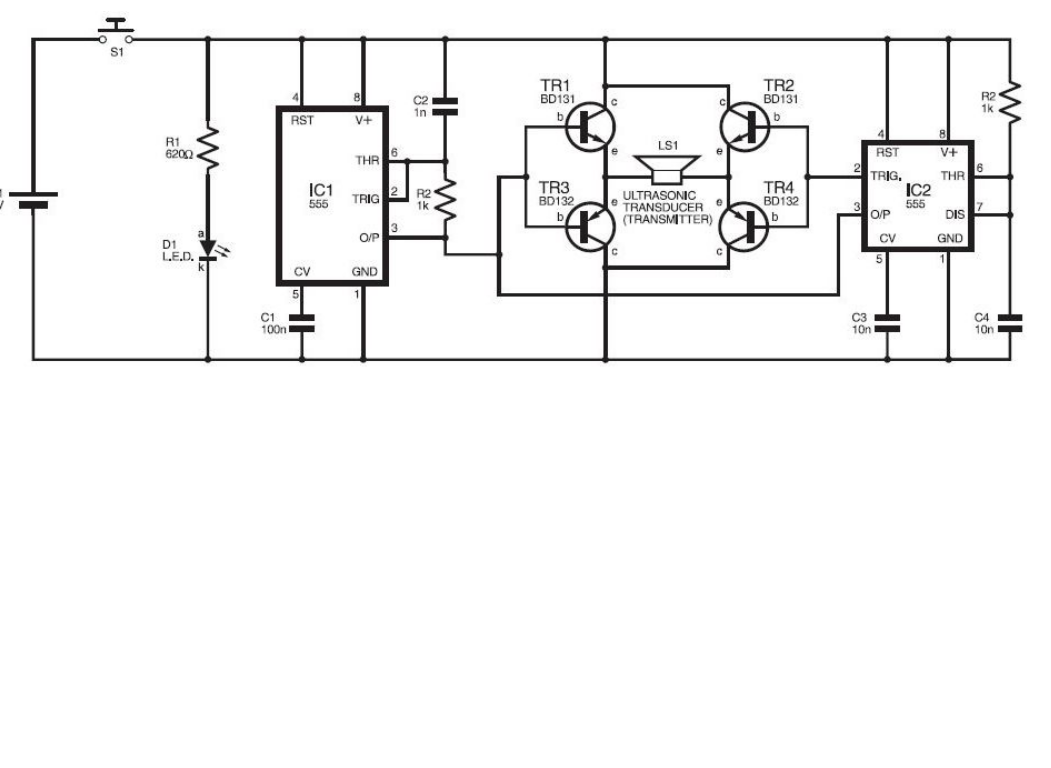

here is an interesting schematic
it claims 110db w/ 4a through speaker.

The schematic here Ultrasonic pest repeller
uses a transformet to drive the piezo tweeter.

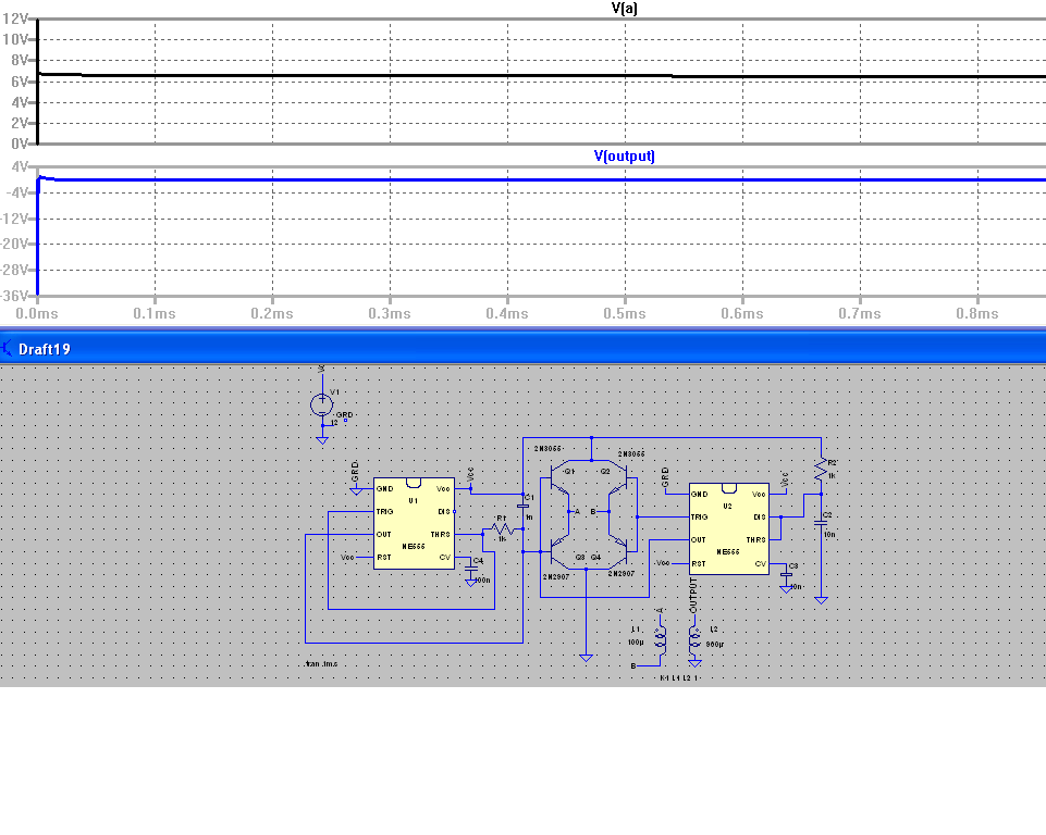

Here is an LT SPICE of the second schematic but using a 3 to one ratio.
NOW how to determine db watts etc.
going for a 9 to one ratio?
