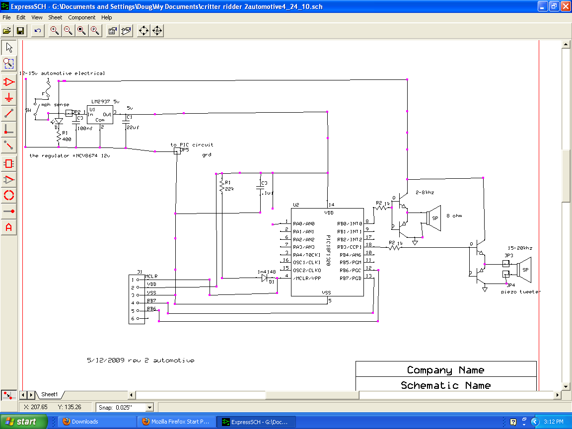

Here is my preliminary schematic
Not real sure on the voltage reg being I never used a LDO reg before.
The pic outputs the two separate set frequencies and whala the deer will either run away or come find out what all the commotion is.
Found a push pull amp with a couple of diodes to bias the transistors but not real concerned about distortion?? or should I (cause problems with the transistors?
Wish I could just build the amps with what I have on hand - 10 - 2n3055's and about the same of 2n2054's.
any ideas??

Mr. DEB,
You need an amplifier to amplify the 5V p-p (1.8V RMS) from the PIC to 12V to 15V p-p (4.6V RMS) to make a low level sound from your speakers.
The push-pull output transistors have NO voltage gain because they are emitter-followers they actually have some voltage loss. With an input of 1.8V RMS from the PIC their output is only 1.2V RMS which is almost nothing.
EDIT: Guess how much power into 8 ohms? Only 0.18W RMS which is almost nothing. The 8 ohm speaker has DC in it which is bad.
I forgot to add the capacitor to the 8 speaker.

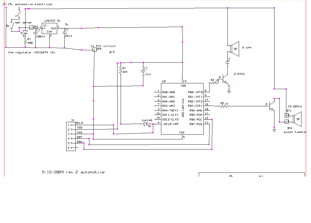

will look at a different design for an amp for the low level. The high level as well.
I simed in LTspice and not real syre if ithey amplify. The current is higher?
This should work??
added capacitor and changed amp layout

Mr. DEB,
Your circuit is missing two amplifiers. It has two transistors instead.
One transistor conducts on the first half-wave of the signal which charges the coupling capacitor through the 8 ohm speaker which produces a CLICK sound. During the second half wave of the signal and all future waves of the signal there is nothing to discharge the capacitor so it remains charged and the speaker does nothing.
The second transistor that drives the capacitance of the piezo tweeter performs the same. It makes just a single CLICK sound.
I made two amps - both one transistor amps (see last post w/ revised schematic.
Didn't you understand my explanation of why your "amps" will not work? The speakers simply make a single CLICK sound instead of a continuous tone.
A simple efficient amplifier is one transistor driving push-pull NPN/PNP emitter followers. It will amplify.
Since you have a single supply voltage then a coupling capacitor is needed to feed a speaker.
Since your supply voltage is 13V from a car then the power into 8 ohms is only 1.5W RMS.
