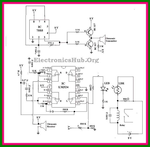

Hello,
Here is that circuit redrawn so it shows the following points.
1- the Tx transducer is connected via 1Meg ohm which will kill any output from it. It should be connected to half the supply voltage or at least a capacitor divider
2- In addition to connecting the Rx Transducer to Vcc (as most of you have said) which is not mentioned in most transducer's data sheets, is connected to Op-amp section A , the output of which is NOT connected to anything, rather its -ve input is connected as an output to the second op amp, so no output is expected.
The 555 in this circuit is known as 50% duty cycle generator as the one resistor from the output charges and discharges the capacitor making the times equal, however it may not simulate well as it depends on how the simulator see the internal components of the real thing, and this is the CMOS version too.. I tried this circuit several times and worked fine except the exact 50% is not as expected, the reason is the output loading makes different charge and discharge currents as load may take or give current.

1- the Tx transducer is connected via 1Meg ohm which will kill any output from it. It should be connected to half the supply voltage or at least a capacitor divider.
No.
The piezo transducer does not conduct DC. Its AC impedance is about 900 ohms at 40kHz. Its common wire should be connected to ground like in the Maxim schematic.
Most of us agree.
The 555 in this circuit is known as 50% duty cycle generator as the one resistor from the output charges and discharges the capacitor making the times equal, however it may not simulate well as it depends on how the simulator see the internal components of the real thing, and this is the CMOS version too. I tried this circuit several times and worked fine except the exact 50% is not as expected, the reason is the output loading makes different charge and discharge currents as load may take or give current.
The output to the Tx transducer does not need to have a perfect 50% square wave. The three divider resistors in the 7555 must be matched and the transistors must be matched to produce a perfect square wave.

The gain of the three non-inverting opamps is about 500 times so it does not take much stray coupling capacitance from pin 1 to pin 10 of the quad opamp to make a 40kHz oscillator.
The rows of contacts on a solderless breadboard and its many jumper wires have stray capacitance all over the place.

does the transmitter have to have an AC signal or is a squarewave DC ok? i read that they must have AC but then these circuits are using dc squarewaves?
hi Dale,
A square wave is fine!
Eric
Since a piezo transducer does not conduct DC then feeding it a square wave with DC on it is fine.
A speaker with a voice coil must be fed AC without any DC on it.

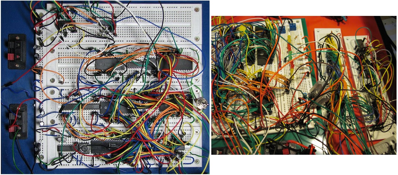

You are not listening to what others are finding and explaining to you, the circuit will NOT burst into 40KHz oscillation, if the bread board is used properly.!
If you post a photo of your bread board perhaps I would be pleased to point out what you are doing wrong.:banghead:
Every photo posted here of a circuit built on a solderless breadboard is a messy tangle of wires with no regard to proper layout.
Your above statement fully supports what I and others have repeatedly told you.!, its not the bread board thats the problem, its the incorrect layout.
Would you agree if the bread board circuit is built correctly the circuit will work as expected.??
If so, why don't you advise any OP thats got a bread board problem circuit, the CORRECT way to connect it up.? rather than blame bread boards as a whole.:rolleyes:
Its a photo of a bread board you have connected we want to see, not some struggling wannabe, so that we can tell you what you are doing wrong.

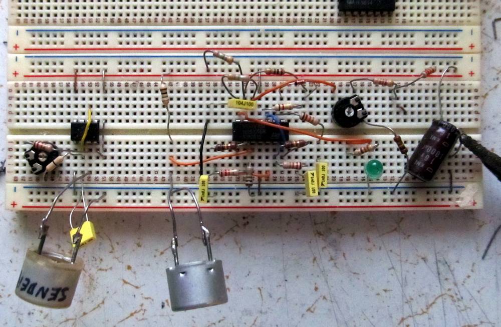

Before I go, Here is My Prototype.
Leaving Today for Australia.
Take Care All of you......Gary
Chemelec, your breadboard layout does not look very neat and tidy but I am glad that it works for you.
It is Perfectly Functional.
I Don't Trim my Resistors and Capacitor leads down as it would result in a Waste of parts.
If I did, the Leads may be too short for the Next Project
I use these parts over and over again (About 1000 of them set aside, just used for Breadboarding) And I breadboard Many Circuits Every Week.

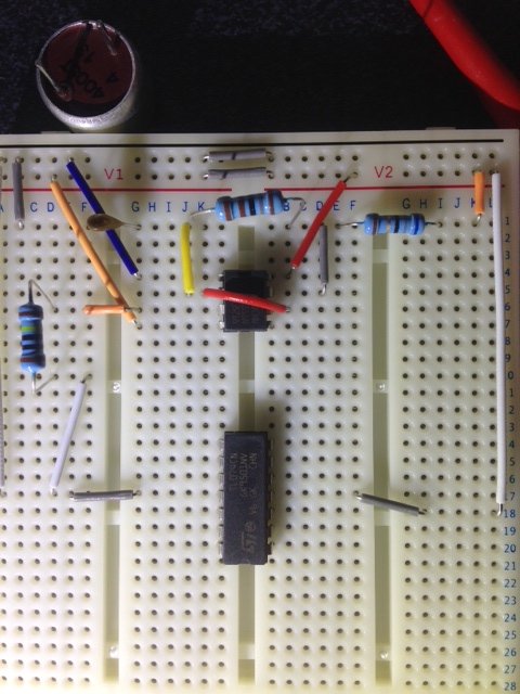

ignoring the op amp bit can someone please advise why im only getting 20mV output from my ne555
components from left to right on pic are 1MΩ 0.01uf 1.76kΩ 0.072kΩ or their about Vcc = 9v battery
thanks again :D
