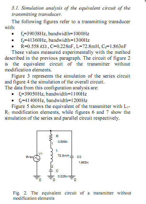

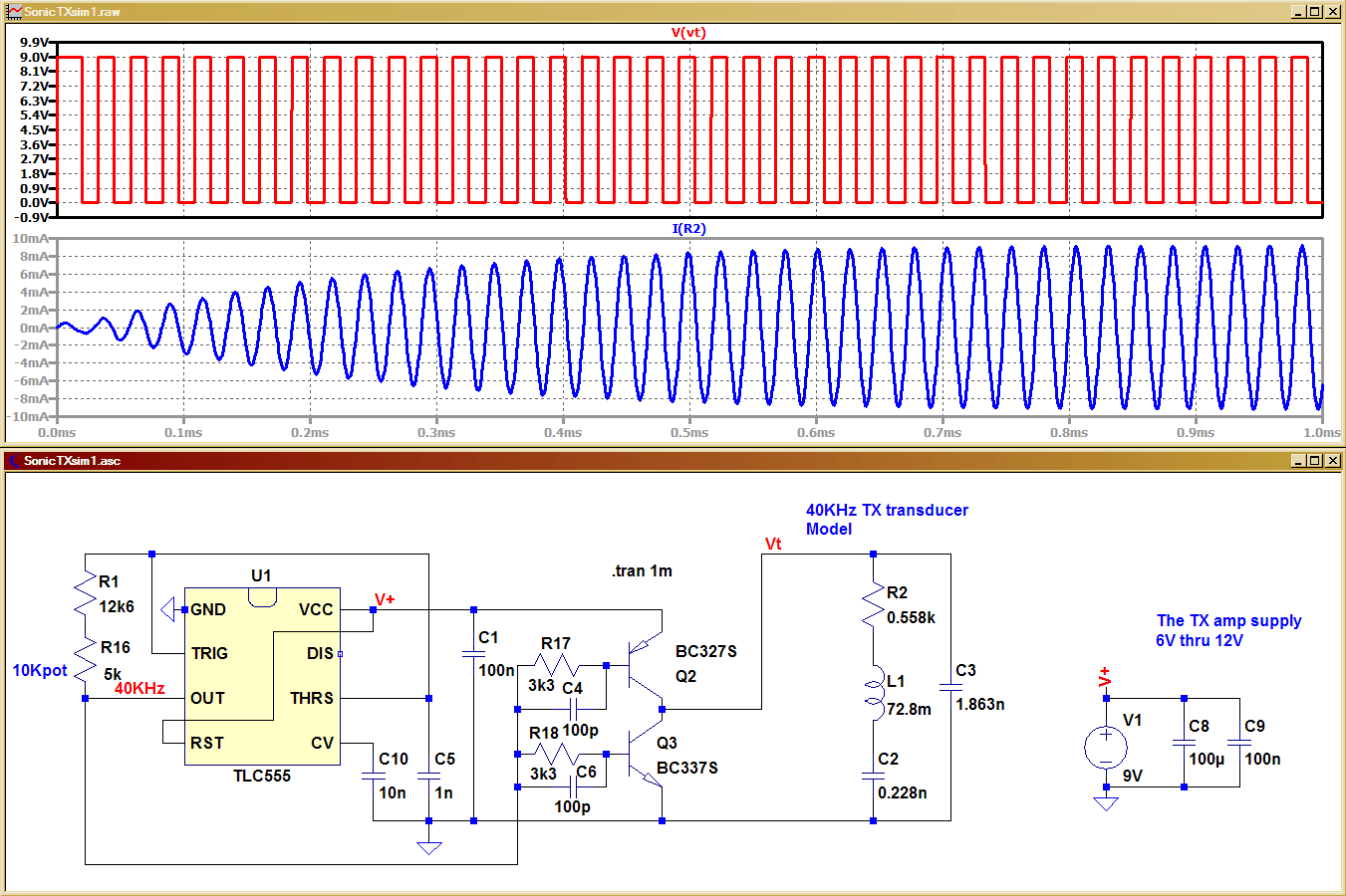

Look at this simulation using a typical equivalent circuit for a 40KHz transducer.
Its an unmodified model so its resonant at around ~39.5KHz, in a optimised circuit for 40KHz, additional Res/Caps would be added to fine tune to 40KHz.
For a 'quickie' sim a resistor is often used.

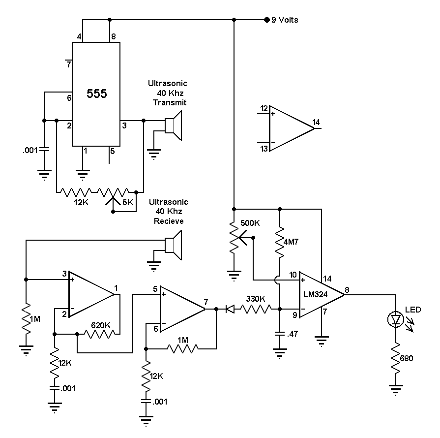

This Schematic does work
I built this circuit up using the two transistors on the ouput of the 555 and also like this.
NO DIFFERENCE in Operation.
I also modified the second pot circuit, eliminating the 400K resistor.
I Did Not add the Opto Isolator but you can use it if wanted or needed.
This Circuit Should have a REGULATED 9 Volt Supply.
A Voltage Variation on the battery, requires Changes to the 500K pot setting.
LED is set to Just Lit, and it Goes Off when an object is Detected.
Have FUN!
A curious connection between the first and second op-amp stages, I have not seen one like that before.
Is it a drawing error, or am I missing something?
I Agree, But this is Correct on both my drawing and the origional one.
Sorry I am not quite sure why.
Possibly some filtering action.
Unfortunately not much time now to play with it some more.
Connecting pin 5 to the Output at pin 1 (As would seem to be correct) Reduces Sensitivity.
Most curious. :confused:

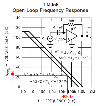

The value of the 0.001uF capacitors in series with the 12k resistors reduces each gain to 0.71 times and reduces the gain of both to half the total gain of when the capacitors values are much more like 0.01uF.
The max gain of an opamp in an LMLM324 or LM358 at 40kHz is only about 11 times when the supply voltage is from 10V to 15V.

hi chemelec,
The LM324 is totally unsuitable for this application.
At 40KHz the gain is too low.
I found a big difference in the 'echo' signal when using the drive transistor pair for the transmitter, when using a decent OPA receiver, ie: CA3240.
When using a LM324 the gain of the receiver is so awful that it masks any improvement shown by the transistor drive.

If the signal to the second amp is taken from pin2, it has no amplification.
The circuit has another flaw, the opamps have no bias voltage.

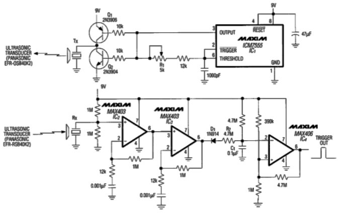

Probably this is the original circuit, which look "normal": **broken link removed**
hi jjw,
I would agree with your linked circuit, it uses a 6MHz bandwidth OPA's, the Comparator connected OPA on the output also looks OK.
Eric
I found an Applications Note in Maxim archives about this circuit. It was used to trigger a video message about a product when someone stops to look. It uses low power parts because it runs from a 9V battery all day.
It uses the transistors in the transmitter to prevent damage to the low power Cmos 555 when it tries to drive the resonant piezo transducer.
The receiver uses low power opamps that have normal high gain at 40kHz and it uses the filter made with R2 and C1 to prevent detection of someone walking past since it wants to detect someone pausing and showing some interest in the product.

The MAX43 opamps in the original Maxim circuit had negative feedback resistors providing voltage gain of 83 times for each one. The MAX403 opamps had an open-loop gain of 251 times at 40kHz so they were used, but are not available anymore.
A moron copied the circuit, added some errors and use the lousy old LM324 quad opamp instead that does not work at these frequencies. The TL07x, TL08x or TLE2141 will work fine.

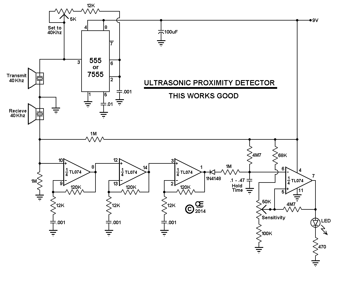

I Built up this circuit using a single TL074 and a 555.
I Still find No advantage in adding the Two transistors at the 555 output.
In the PDF file that was previously Posted, it says it Prevents "Undesirable Spikes".
Considering these Ultrasonic Transducers are High Impedance, so Not sure that is Possible.
And I don't see any on my Scope.
