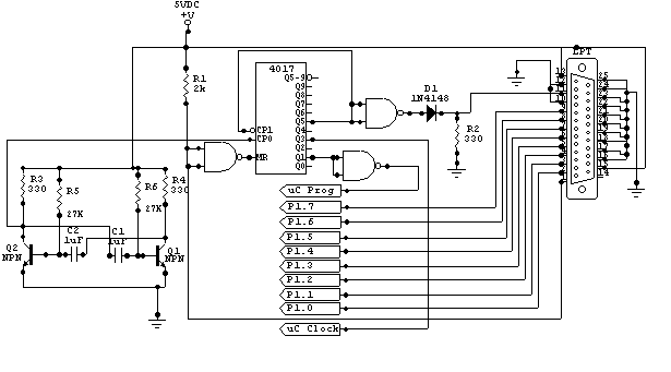

Which programmer are you using? Can you show us the schematic?
If its parallel port based, I am sure this is a timing related problem. If the programmer software is DOS based, try running it in pure DOS mode. This may work.
I made my own programmer and I am using QuickBasic to send the data to the LPT port.
Basically my circuit consists of a 4017 counter and a 74HC00 nand gate. What it does is the following:

So, from what I understand?, you've designed your own programmer?, and written your own software to control it? - and it doesn't work?.
Your problems here are many fold, you've no idea where the problem might lie!, it could be either your hardware, either a constructional error, or simply a design flaw?. Likewise it could be a programming error in your software (a bug), or a flaw in the original software design?.
As in any diagnosis, you need to isolate where the problem might lie, but in your case this is going to be EXTREMELY difficult, you have many possibilities, and no way to isolate where it might be!.
Assuming the circuit is the one you posted previously?, I thought it looked completely strange? - like no programmer I have ever seen!. I'm not familiar with the micro-controller you're using, so perhaps that's what's needed?, did you get the basic design from a datasheet?.
What you really need to do is use either proven working software on your programmer, or a proven working programmer with your software - in that way you can isolate the problem.
The picture in this post is my circuit.
The circuit is working as far as writing the data to the at89c2051 chip is concerned. I have set appropiate levels to P3.3, P3.4, P3.5, and P3.7 pins on the chip for programming.
The major problem is when I am ready to test the chip (even with one lousy LED connected to P1.4 for example) after it is programmed, it fails to work.
Is there a simple way to test the chip (doesn't matter what code is stored) to determine if it is damaged or not? Some of the uC's were warm when I programmed them.

This is the original schematic. I had to create one myself because most schematics required a transceiver or a buffer which I do not want to use.
So you really don't have any definate knowledge that this circuit even works?. As I mentioned before, it looks really strange?.
A quick google found this https://www.dontronics.com/pa_pgm.html, which looks like a programmer, whereas your one doesn't?.
The good news is that the microcontroller appears to be providing proper output. However, it seems that my relaxation oscillator is incompatible with the uC even though the oscillator functions as an oscillator.
When I read the uC datasheet, it states that XTAL2 is the output of an inverting amplifier, and XTAL1 is the input. It also states that XTAL1 can be connected to the output of an external oscillator and XTAL2 should be conected to nothing.
I wonder if XTAL1 is being misrepresented in the manual.
