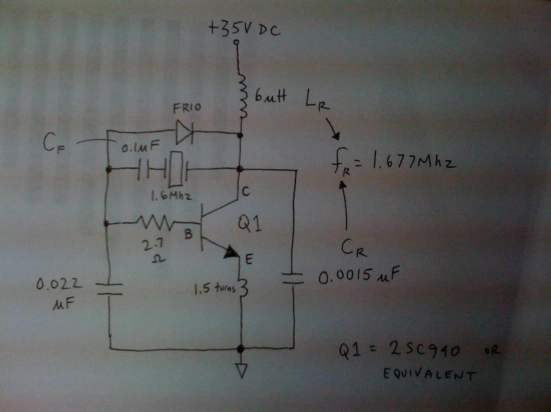

The schematic looks close now. I'm also mystified by the frequency calculations, since I get about 500 kHz with L1 as 60uH or 160kHz with 600uH. If L1 was 6uH the frequency would come out right, but the coil doesn't look that small.
I'm also unable to find a collector bias for Q4.

The two mysteries to me are (1) 60uH is resonant with 0.0015uFd at 531kHz not 1.6MHz. If C6 was 150pF, then it would make sense.
And still, (2) where is the collector bias for Q4?
I would expect that a worthy experiment would be to scale each of (C6 and L1) by 16. That would make C6 = 23nF (make it 22) and L1 = 96uH (make it 1000uH or 1mH). This would keep the impedance in the same neighborhood.
I would also scale the values of L2, C3, C4 and C5. I suspect that these might not be as critical. R13 would not change.
i found another schematic for an oscillator, and it only uses 1 transistor. i suspect that Q4 is a clamp of some kind, it gets it's collector voltage from the piezo crystal. in some of these oscillators, the voltage across the crystal can be as high as 200VAC (RF) even with power supply voltages of 50V or less.

Here is the schematic for the humidifier circuit that I have here. It is the same as yours.
The piezo transducer resonates at 1.67Mhz. To use this circuit with a 100Khz piezo you can change the following parts:
The inductor Lr (6uH) and capacitor Cr (0.0015uF) form a resonant LC circuit at 1.677Mhz. To calculate the resonant frequency of an LC circuit use this on line resource:
If you change the inductor to 0.53uH and the capacitor to 4.7uF it will resonate at 100,840 Hz (close to your piezo target).
There is a capacitor in series with the piezo that is 0.1uF. This is less than 1 ohm at 1.67Mhz. But at 100Khz the impedence is too high. This needs to be changed to 1uF or greater. Use this on line calculator to check component impedences at different frequencies.
This should work fine for you.
Eric

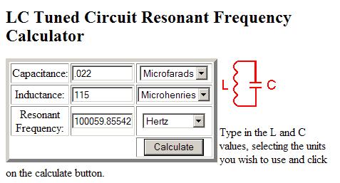

I do agree that your values for L and C are better. I only checked for resonance and not operational reactance.
0.022uF and 115uH resonate at 100,060 Hz and both have a reactance of 72.3 ohms at that frequency.

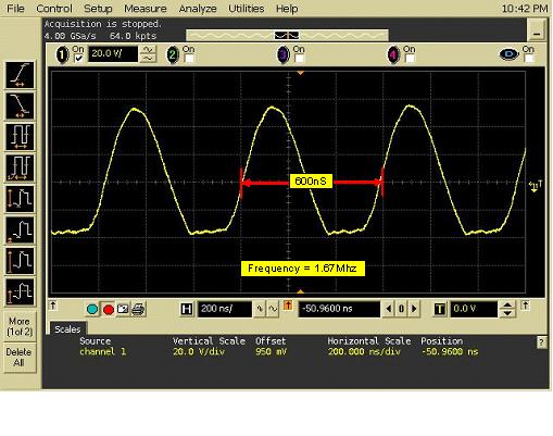

I was able to power up the circuit this evening and indeed it runs at 1.67Mhz.
See attached screen capture from scope.
Eric
